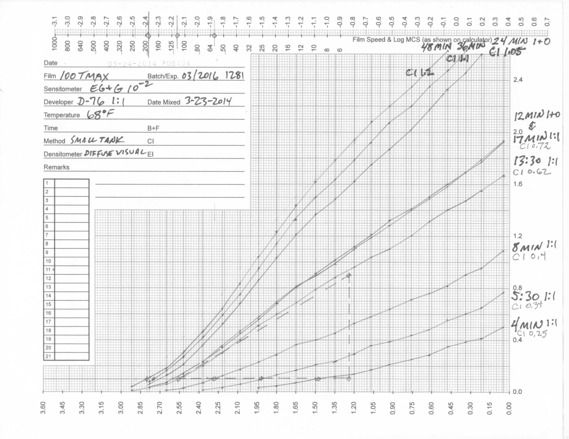

TMAX 100 will do that if you give it enough light. It has a very long straight line. But, if you don’t give enough light there will be nothing on the film.
