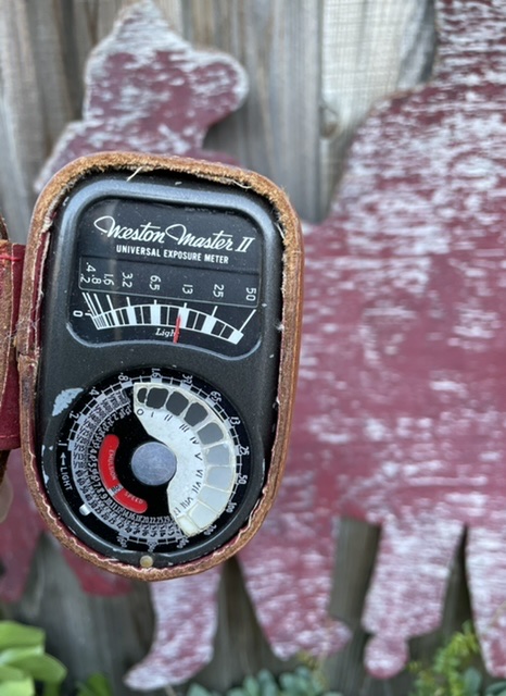

Since the advent of the Zone System, stickers for your light meter were illustrated and encouraged.
In this case I am shooting Double-X (ASA 200) with a yellow filter (EI 100) metered with a Weston Master II (one mark lower therefore 80).
I walked up to the chalkboard (mom made this plywood cut-out of our family of five plus husky) and took a reading. Because the board is a dark red, I “placed” the reading on Zone IV.
Next comes the visualization. I can walk around my backyard and meter anything. It’s easy now to look at the needle, see the corresponding number on the dial.
In my case the chips are actual pieces of my print paper, Ilford Galerie 2, with the actual grays for that paper with film and print developed normally.
So it’s a good way to “visualize” or “previsualize” what you would get on the final print. If you don’t like the way the different parts of the picture will fall onto shades of print grays, you can turn the dial. If everything falls where you like it you are good to go for N normal. If you just can’t get what you want you can think of N+ or N- treatment or you can think of filters to bring a pure color up or down in tone.
