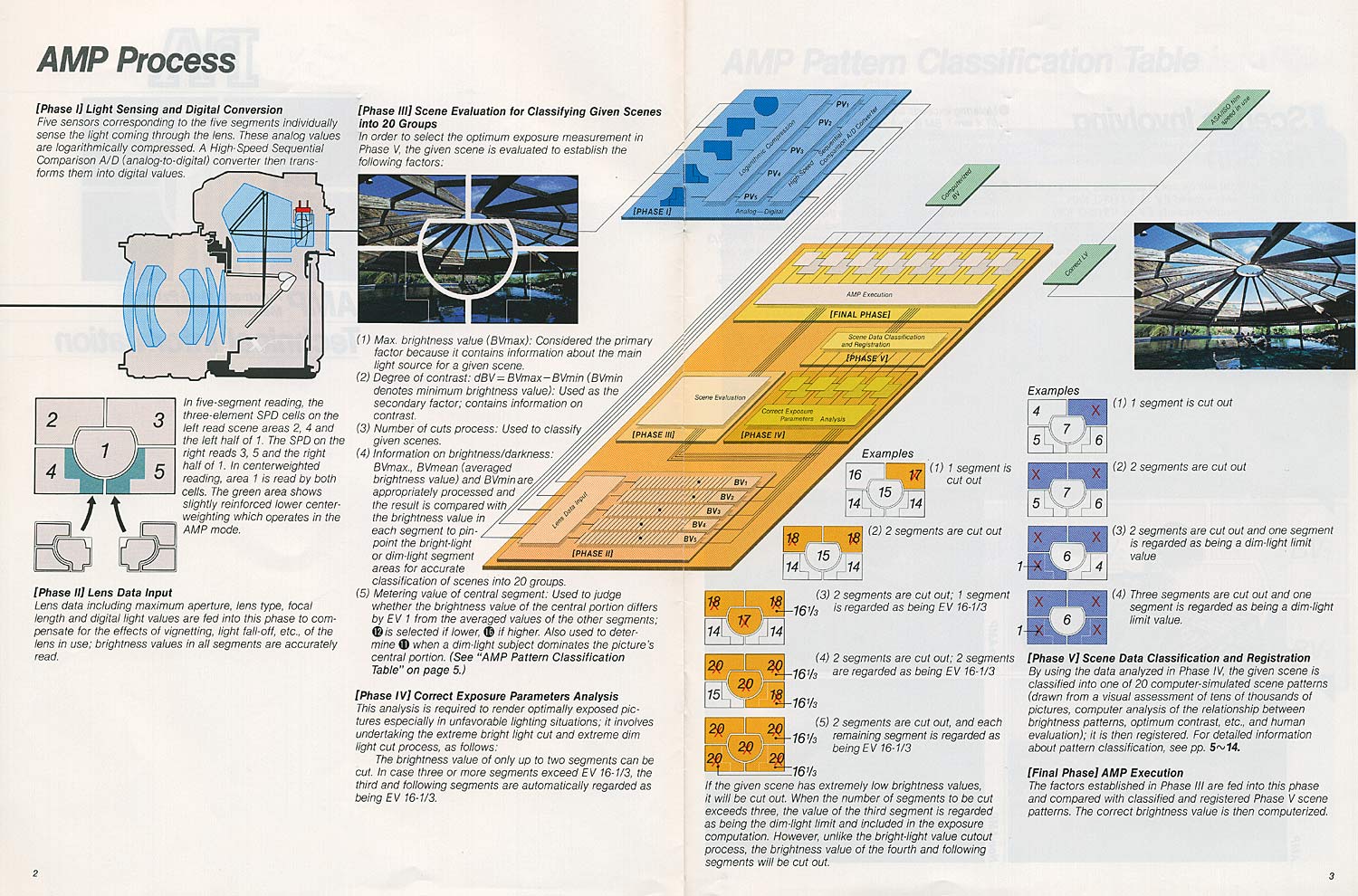

I've done a number of tests with a spotmeter and going through the whole zone system exercise to determine an exposure and then compared to the matrix metering on my Nikon. Every time the Nikon gave the correct reading, so I have just used it. The only time I use a hand held meter if if I am using a large format camera exclusively and have left the 35mm at home.
Agree. I and others have posted about how good this system is in the N75 and F6 (others too).
