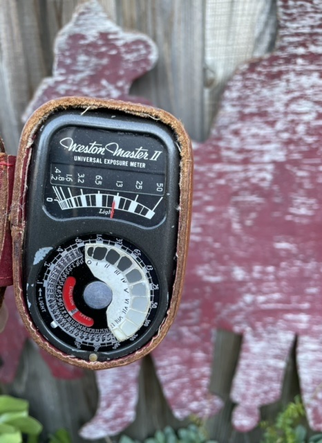

I haven’t found a good Zone System meter in-camera
