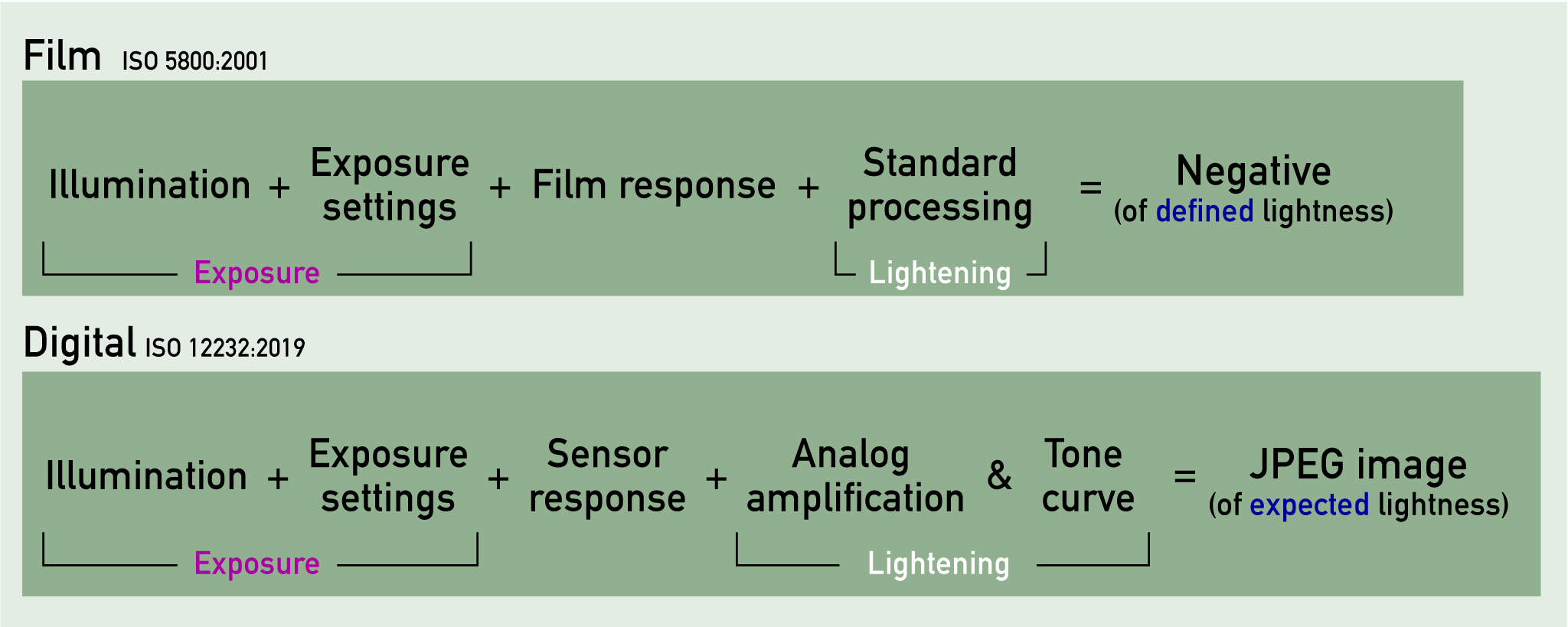

@Alan Edward Klein this article on digital vs film ISO is pretty good. The gist of it is captured on this diagram, which basically says that for most practical purposes they are equivalent. I actually find film box speeds to be far less consistent across manufacturers (or even truthful, looking at you Fomapan) than sensor ISO ratings. An ISO 100 shot looks the same on my Canon, Sony and Fuji digital cameras.
Thanks. It could that film is more variable because the chemical development process is not exact from one day to the next. With digital, the program remains exactly the same from shot to shot.

Thank you. This is a good summary of the differences between film exposure measurements and digital measurement/computation. The "photographers" on Dpreview spent months gnashing their teeth about why certain digital camera manufacturers were "cheating on the ISO.". I doubt any of them knew what it was, but they sure argued.
That was the conclusions of the Professional Photographer Magazine test that I couldn't remember, in short, the digital image is a positive, like slide film,and the more exposure you give it the lighter it gets, and the I.S.O on the sensor used by the camera manufacturer is calibrated to that particular make and model.
Glad it was of help. Thamks.
