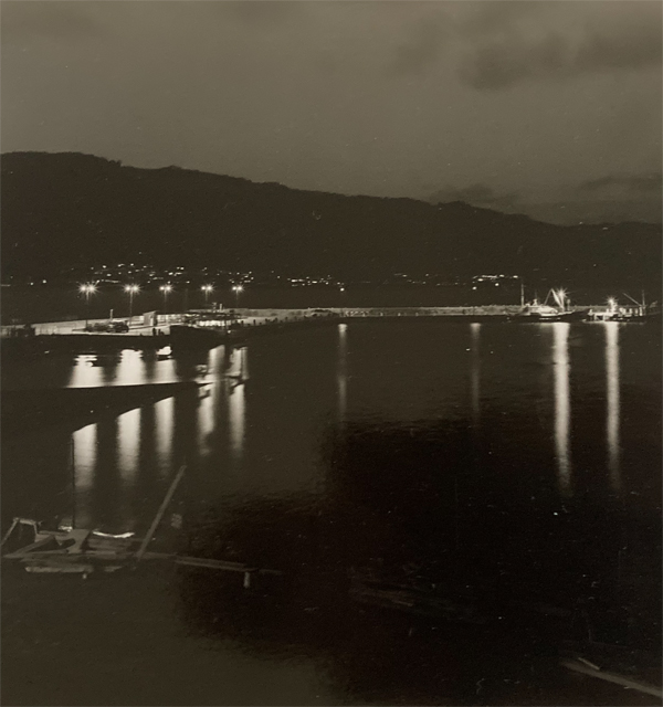

Here is an example of what I'm talking about. (please excuse the quality, it's a reject print used as a toning test print)
In the scene, the only reading I could get with my Pentax digital spot was from the white reflections in the water, the meter didn't even register the sky. (In the print the sky is actually dodged)
My meter goes to EV 1 according to the manual. Are you saying that a meter that goes down to EV 0 would have given me useful light readings?
I just looked up the specs for the Sekonic L 858D and it says it goes to EV -5. Are you saying this meter would give me useful readings in such a low light situation, if so I may consider buying one for sure.
OK, now I understand the issue raised. Not a typical daylight scene, and the 'proper exposure' is very much determined by what the photographer wishes to capture and portray to the viewer...no 'standard' for that subjective portrayal.
I have an example of that...
Had I exposed per meter suggestion, it would have looked like shot 1, but this was at night in my front yard and the scene is NOWHERE THAT BRIGHT!. Shot 4 better conveys the impressions of the viewer at night, but even then the photo conveys far brighter content that the eye gets at night from the one overhead street light. So the meter reading is certainly 'useless' for suggesting what I wanted to capture...and the meter type has no bearing on that! Perhaps if I metered the darkest shadow area and used Zone System style of exposure to 'place' that in Zone 2 or Zone 3, that might have rendered something closer to what the unassisted eye perceives, without resorting to 4 shots to convey the impressions of the viewer at night.
For difficult to meter shots like this, I find using a digital camera and adjusting the settings so it looks right in the viewfinder gets the exposure in the ballpark for your film camera.
