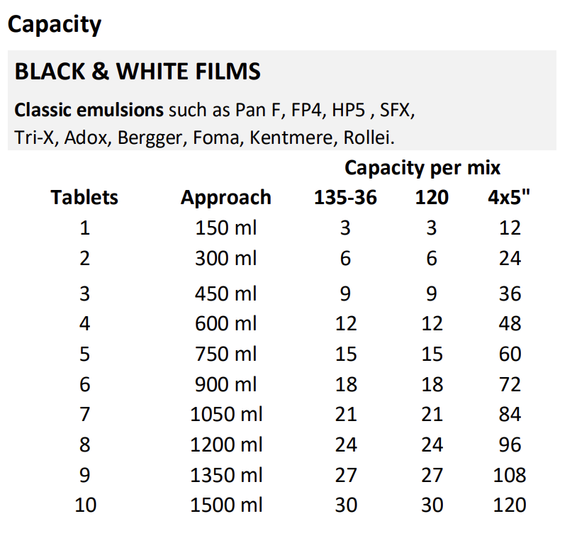

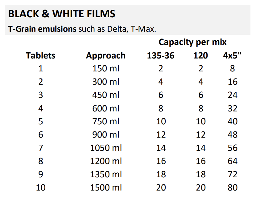

As per this Superfix instructions document by Tetenal, one tablet can be dissolved in 150 ml of water and used to fix film. There is no ambiguity about the minimum volume to be used at this concentration - it is 150 ml.
Weight of each tablet is 20 g. Even assuming all of this weight is due to Ammonium Thiosulphate, there can't be more than 20 g of it in one tablet.
Coming to capacity of the tablet fixer, this is what the document says about classic films:
The capacity of the fixer when used with T-grain emulsions is this:
So, 20g or less of Ammonium Thiosulphate is used in Tetenal Superfix to fix three rolls of classic 35mm film or two rolls of T-grain film.
