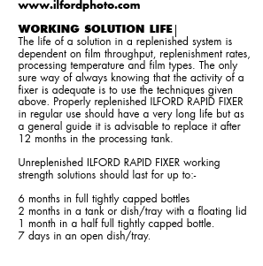

Since it says once you mix a 1:4 working solution for film, you have to toss it after a week.
That is not correct.
From the datasheet:
Here is the link for the entire datasheet: https://www.ilfordphoto.com/amfile/file/download/file/1833/product/711/

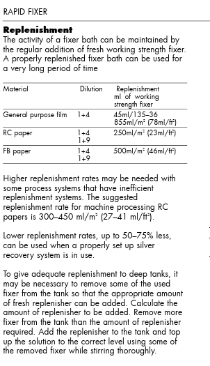

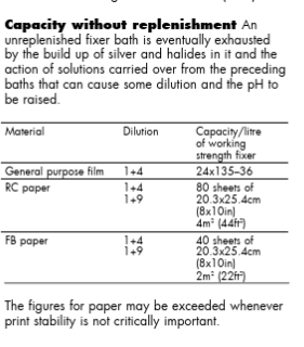

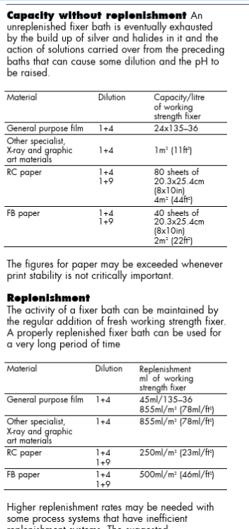

From the datasheet - the Capacity numbers for Hypam:
Here are the datasheet capacity numbers for Ilford Rapid Fixer:
And for completeness, here are the Replenishment numbers for Ilford Rapid Fixer:

What I saw on Amazon for that product was 1 week without details. From your data, I was off by a factor of 2, so my fixer only saves half a roll of film. I stand corrected. Your sheet gives a month life in half filled bottles with loose caps, which is the normal way a beginner would store it. For low volume and intermittent, the shelf life is the problem.

What I saw on Amazon for that product was 1 week without details. From your data, I was off by a factor of 2, so my fixer only saves half a roll of film. I stand corrected. Your sheet gives a month life in half filled bottles with loose caps, which is the normal way a beginner would store it. For low volume and intermittent, the shelf life is the problem. For unknown reasons, I can't delete the box below.
