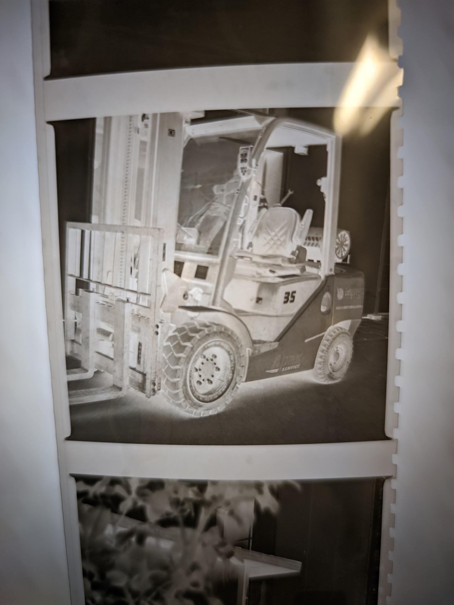

Here's some Aviphot 200 shot @ 200 developed in D-76 1:1 for 14 min. This was the first roll off the reel, I assume the mottling should clear up further on into the reel. I hope. I used a Mamiya M645 80mm 2.8
I rolled this up by hand. It has potential.
How did some of the rolls further in the spool end up? I'm considering getting some but the mottling has scared me off.

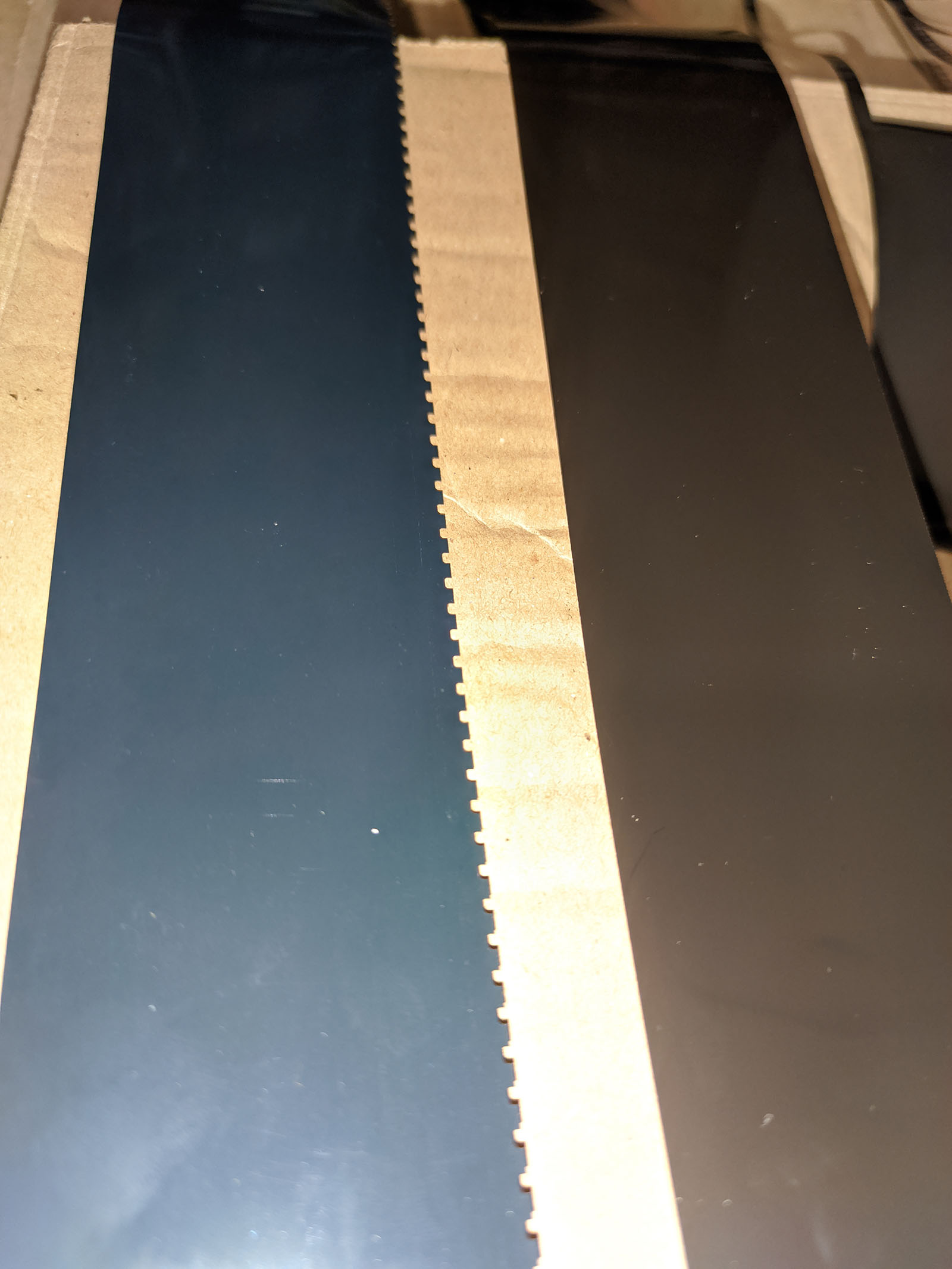

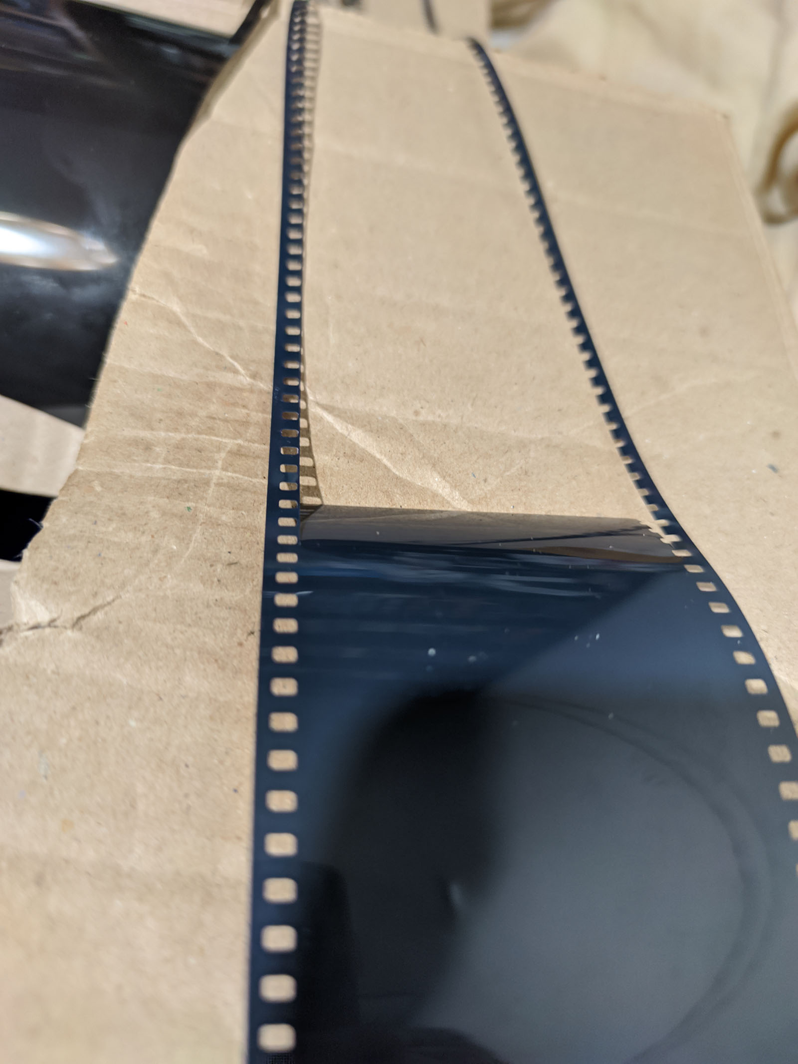

Okay. First test with the 70mm slider. With non-perforated film, there is no surprise - everything is perfect. What's more interesting is with the perforated film - the slide tactfully does not affect the perforation on one end, which makes things easier later.
The big surprise here was that I was able to roll this piece on a standard Jobo roll. Granted, it wasn't the full length of a 120 film, much less a 220, but I have high hopes for that.
These days I will roll a few rolls of both films and test them in real conditions. Too bad the weather has seriously turned bad at the moment :smile:

My concerns about the injured perforation proved unfounded. Surprisingly, the film wound quite freely in the Jobo 1501 reel.
