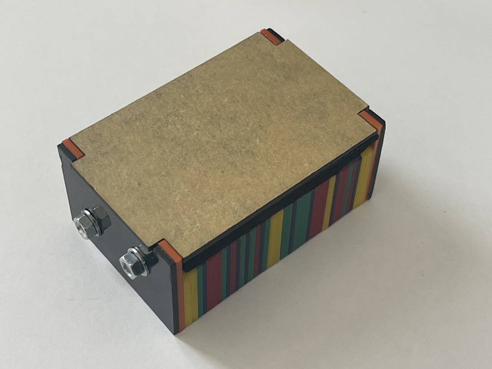

This kind of pull-through slitters always looked barbarian for me. I've built a slitter that has pairs of foam covered reels inside to transport the film.
But whatever you use - your biggest enemy is dust.
