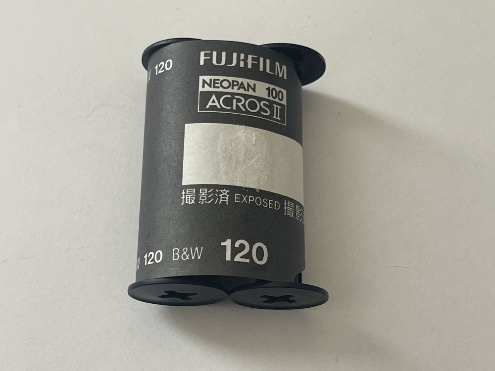

You can see in the image that each film manufacturer (Kodak on the left, Ilford/Fuji Across II in the middle, and Foma on the right) marks it slightly differently, but they are all easily identifiable. The red marking added to the image indicates exactly 7.5 inches from the start mark, and where the film needs to be attached.

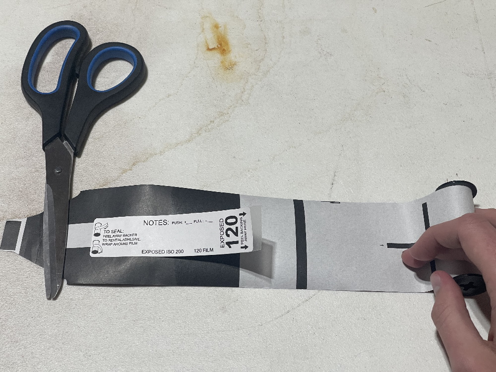

Once the place where the film needs to be attached is identified, make a crease along the backing paper, to make attaching the tape easier.
Then, add the tape to the back of the paper. I use 3M masking tape, as it is very similar to what most manufacturers use. It is approximately 2.25 in (55mm) long, and 1.5 in wide.
The tape is folded over along the crease you made to allow the film to be easily aligned in the dark. Try to make sure sure that the tape does not cover more than 0.75 in (20mm), as it may impinge on the first frame past that.
Finally, stick the exposed label (discussed further in a bit) onto the backing paper. Repeat this procedure for the number of rolls you wish to make.

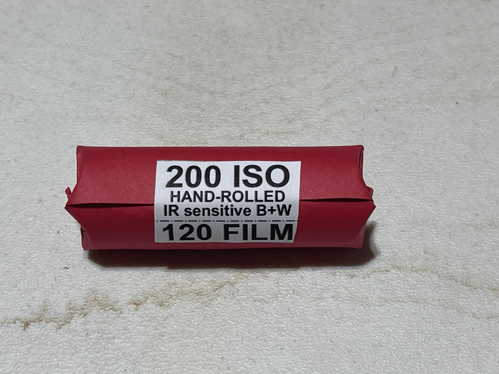

Attach the unexposed label, and then wrap up the film.
Congratulations, you are finnished making a roll of 120!
