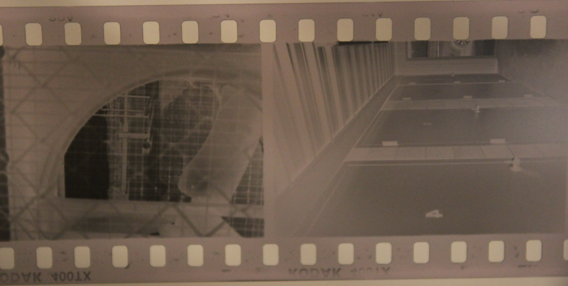

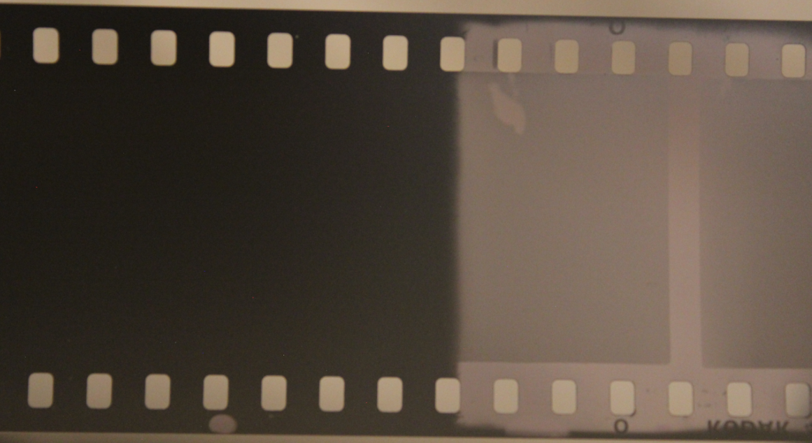

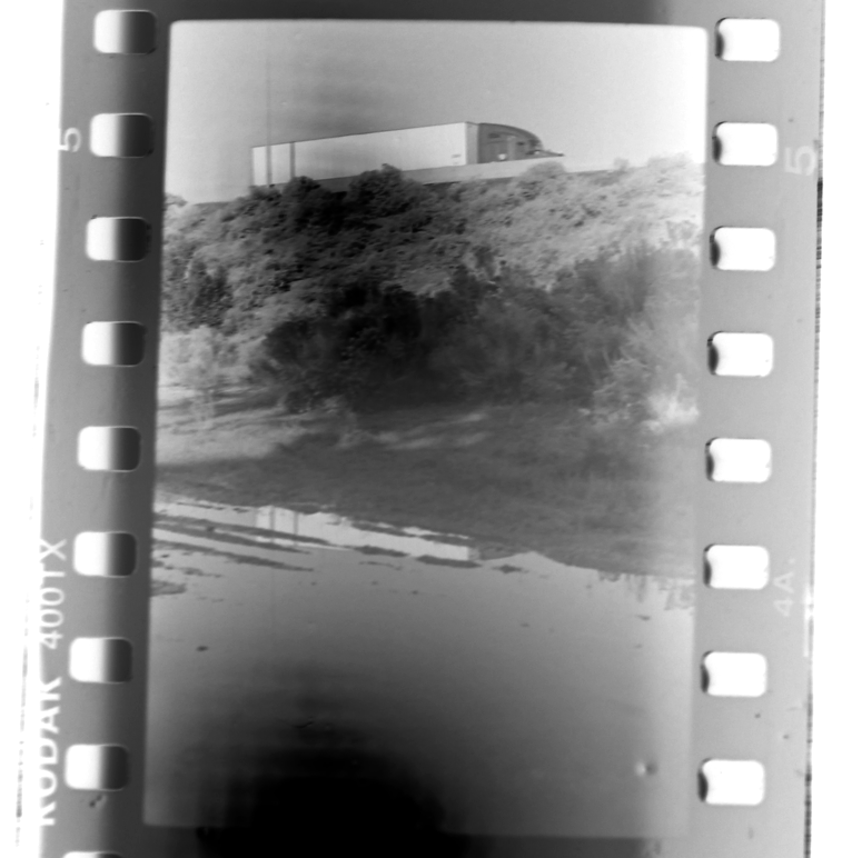

Thanks for sharing pics of the negatives themselves.
They do look under-developed to me.
Perhaps your Rodinal concentrate has problems.
But it also may be that 8 minutes is far too short for 1+49 dilution Rodinal.
I'm seeing recommendations of 13 minutes at 20C.
And by the way, the purple tint isn't very important. Yes you can take steps like using a washaid to help remove it, but it doesn't have an important affect.
You mention that you're on well water. Try using distilled water from a grocery store. There may be certain minerals in your well water that's messing up your developer.

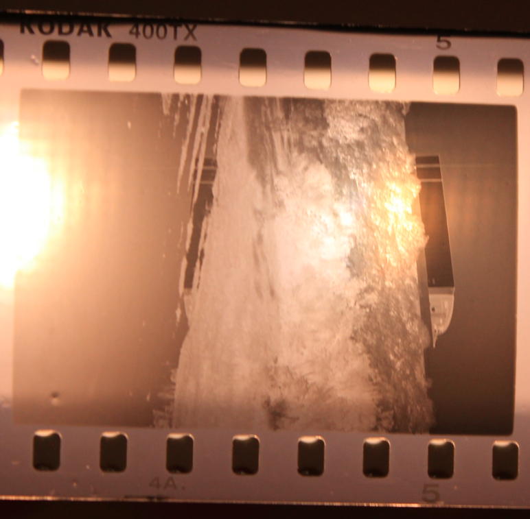

Here are the results;
Both photos are of the emulsion side, since any photo of the front is just a reflection of the lights above.
Process:
Checked the distilled water temperature before loading the tank with film.
Used the Paterson tank this time.
Checked water again after, no change, and was at 20.5c.
Used Rodinal 1:50 - 588ml water and 12ml Rodinal. Checked the temp before pouring into the tank, and read exactly 20c.
14 minutes, first minute agitated, then the last 10 seconds of every minute after.
Filled the tank up once from the well, but after reading the temperature of the well water at 18c abandoned that. Dumped the water and filled the tank up with distilled water, dumped and refilled 4 times total. Before dumping, I let them sit for maybe 20-30 seconds while preparing for the next fill, a little less for the well water. I'll be switching to a different method if anyone has advice on doing Water Stop baths.
I accidentally left a little bit of the water from the bath, so the fixer was slightly diluted when I poured it in. Fixed for 4 minutes, and took it out to look at it after. I thought it looked fine, so I dumped out the diluted fixer.
Ilford wash method
Then used Sprint Archive Fixer remover for ~3 minutes. It was getting dark, so my note-taking failed around here.
Ilford washed again and ran through Photo-Flo. I got some particles on the negatives while running through Photo-flo and while photographing. I also broke a cylinder, which I am still a little sore over.
Lost a few frames to surge marks from over-agitation, though it is only on the first few. Do these negatives look about right? I would say they look mildly better in person than compared to the photos. If I had a light table, it would make this easier!
- Bill

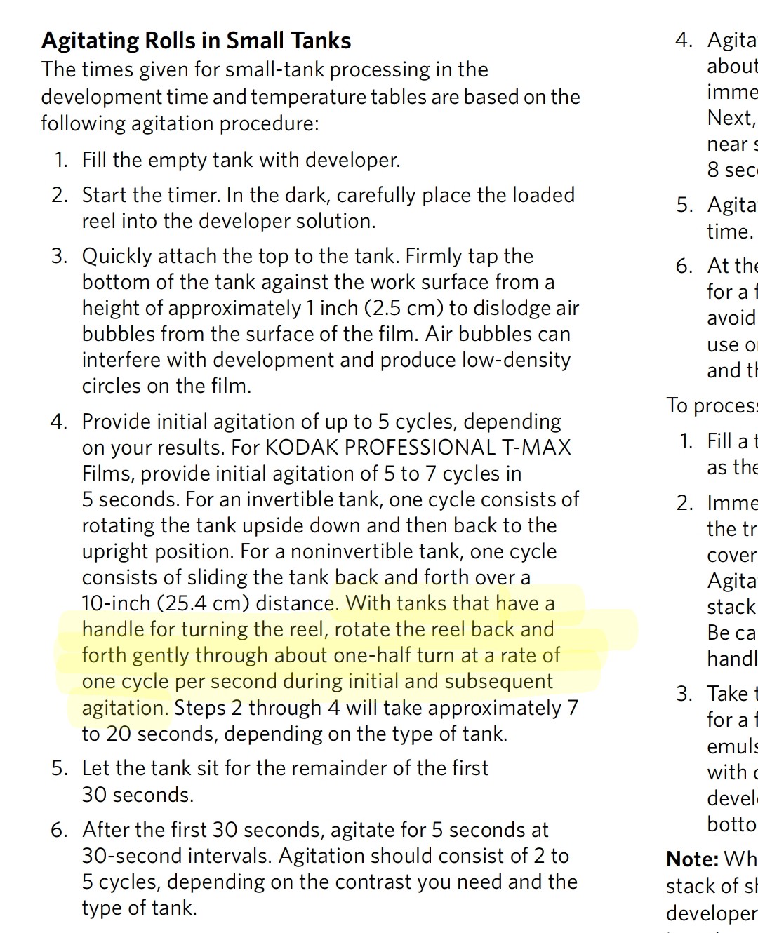

About agitation with the stick, below is what is found on the XTOL datasheet.
I used a variant of this for a long time and it work : initial agitation of 30s (roughly 30 half-turns) then every 30s 5 half-turns at a rate of 1 half-turn per second. When used with a timer that does 5 beeps every second at 30s intervall (I used the MDC app) there's great consistency between devs, as it's easy to agitate the exact same way every time.
It's not a very dynamic agitation so dev times are extended a bit compared to the inversion method. Note : untested with very short times like 5min or below, that are not recommended anyway even with inversions.

Hello. Recently, I was able to start developing film again.
How did I do? Note for the photo: backlit by LED light and still wet, this photo was taken right after removing from the photoflo and hanging.
Rodinal 1:50, ~12ml of Rodinal in ~588ml of water. 14 minutes with agitation for the first 30 seconds and then 10 seconds every minute. For agitation, instead of using the twizzle stick, I used the figure 8 method as recommended by users Andrew O'Neill and mshchem. I was using the Patterson tank this time. Because the fixer was mixed in last November, when I was last developing, I did a leader test. Cleared in about 2 minutes, but I still fixed it for longer just in case. I had already poured the fixer in and started the timer when I remembered about compensating for temperature, but since the fixer is older, I figured that it would be O.K. During the second wash, about 3/4th way through the second set of inversions for the Ilford wash, I ran out of water I had warmed up to 20c, so the rest of the wash was done with water at around 18c-19c.
TL;DR steps taken:
Developed 1:50 for 14 minutes at 20c
Ilford wash method at 20c
Ilford Rapid Fix for 7 minutes at 21c
Ilford wash method at 18c
Photoflo at 18c
The reason the last wash and photoflo were colder is that I did not warm up enough water. Next time, I could try cooling down the fixer by running the bottle under cold water.

Just out of curiosity what is the negative a picture of ? I cannot make anything out in this frame

Assuming you mean the image I posted earlier today, it's of a semi-truck on a highway.
I had an idea of a large vehicle--a semi-truck, or akin--being reflected in the pool of water--the bottom of the frame--while being visible on the top of the frame. Unfortunately, I am not that competent with a camera, especially running on fumes and on a time crunch. I believe the lens I was using was either a Super-Takumar 28mm or a SMC Takumar 55mm, the former being more likely. I'm open to any critiques or advice you might have.

I'd say it looks pretty decent from what I can tell. Obviously the illumination from when you took the photos of the negative isn't uniform, but the negative looks like it has decent development.

Thanks for the reply. Now the image is the right way up I can see what it is. What's the lines above the white body of the truck and the half round black shadow on the water at the bottom which gradually gets fainter?
Alright, perfect! Thank you for the confirmation. Currently, I have no reliable way to obtain a uniformly illuminated image of the negatives. I'm sure there is a way to MacGyver some painted box with lights- but it's just not a high priority.

No problem. It is a bit clearer in the original photo, but what you are seeing is the LED light bar.
