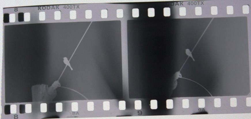

Hello, again. A different issue has emerged.
About half of the roll has this issue, where part of the frame has been turned black (fogging?). Specifically frame marking 0, 1, 5, 6, 7, 8, 9, 10, 13, 14, 21, 22, 23, of a 24 exp. roll of Tri-X. The roll was shot rated at 800 instead of 400. For development, 1:50 (~12ml Rodinal in ~588ml water) at 20c for roughly 17 minutes and 30 seconds, give or take 10 seconds.
Is this a light leak or from over-agitating? I cannot seem to find any holes in the changing bag I'm using.

Light leak for sure.
If you can’t replace light seals on the camera right away you can try keeping the bottom half of the camera case on at all times.
Absolutely.
Good call; that might help. However, given the pattern of the fogging, the cause may not (only) be on the bottom of the camera, so there's a chance that shielding the bottom may not be a totally reliable workaround.
@DsrtBill this looks like a problem with the camera.
Oh, now you mention it... Looking at the camera, the light seal has completely rotted away... No idea how I missed that one! /:
The camera is a Praktica LTL; it only has a seal at the hinge. And, looking up other Praktica L-series camera light leaks, the patterns match perfectly.

Ah, great, looks like there's at least not much of a mystery, that makes things easier!
The seal should fit, that's the main thing. I'd try to cut a piece of foam roughly the same width as the original. You can probably still see the outline of the old foam. The width is probably not very critical.
