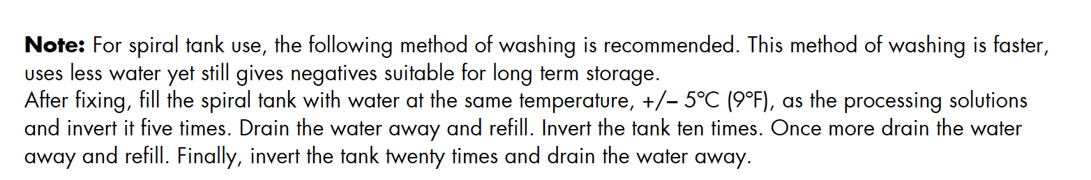

In reverse order: I fix TriX in rapid Fixer (Claytons, but any good brand will do)—make sure that you periodically check the fix with a few drops of Hypo Check, or observing clearing times for film leaders. Many on this forum will provide details for testing developer and fixer solutions … .
I fix TriX for a good 4 to 5 minutes with intermittent agitation. This is followed by a 2 minute treatment in a Hypo Clearing agent—which speeds up the wash cycle and will remove most (if not all) of that anti-halation dye. I then use the Ilford wash cycle:
Fill and invert the tank five times; wait 4-5 minutes; pour out the water.
Fill and invert the tank ten times; wait 4-5 minutes; pour out the water; finally,
Fill and invert the tank 20 times; wait 4-5 minutes; pour out the water.

Ilford wash method

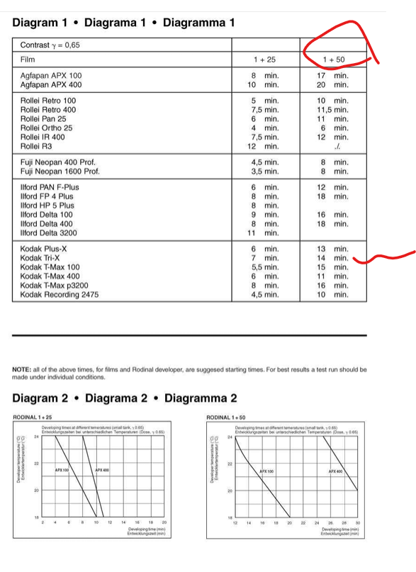

@MattKing is right. Your development time is too short. Agfa suggests 12 minutes at 20ºC at 400EI.
That Agfa chart is quite old, and Tri-X is probably a bit different since then.
But it's a good place to start.
My bottle of R09 lists a development time of 14 minutes for Tri-X in 1+50, so that adds some more credibility to underdevelopment

4. Wash: Use either Ilford wash sequence or wash in sink according to manufacturer's suggested time

With the 1st development, I used the Ilford Wash Method, with inversions.
However, with the 2nd development, I used an Anscomatic tank, so I washed by filling it up, agitating for about a minute, and pouring out, repeating it 3 times. I did this before fixing and after the first fix.
I plan to just run it under well water for some undetermined amount of time next time I use that tank.
I haven't heard of letting it sit. Is it better to let it sit for 4-5 minutes instead of just doing the inversions?
Neither have I. Here's the Ilford instructions :
I've been doing this method for years. I don't see the point in letting the tank sit for 15 minutes when the whole idea behing the method, as Ilford states, is to make the wash faster. Also, having the film sit in water which still has some fix in it seems rather counterproductive.
@TomR55 : where did you get the sitting part from ?
Naked Photographer did a test of the effectiveness of the Ilford three step method in one of his videos, BTW:
This video from Ilford might help you visualize the process, although I would not have used the squeegee at the end. There is too much risk of scratching the film, I just hang my film to dry.
I've been using 1+4, but in a 600ml working mix, so 120ml Rapid Fix + 480ml Water. I'll mix up a full litre next time to meet your recommendation.
There is no problem with using a total volume of 600 ml, as long as that is enough to cover the film in the tank. The smaller volume will affect the calculation though of how many times you can reuse that fixer to fix more films.
Agree, the whole point of washing to remove the fixer from the film. The best way to do that is to have the difference in concentration between fix and clean wash water as great as possible. That means continuously moving clean water will remove the fix the fastest and with the least amount of water.
The agitation and continuous movement of the water is important for a wash.
I believe that the logic behind the sitting times relates to the fact that the actual physical mechanism involved when washing fixer out of the gelatin on the film is a diffusion mechanism. That is the reason that, above a certain quite low flow rate, it makes little difference to the total washing time if you speed up the water flow.
But yes, the water does its work best and fastest if it moves.

Where do I find a temperature adjustment chart? I have never heard of one before
Alright, thanks. I'll try to avoid going under 20c in the future. Do you recommend checking the temperature every minute?
I was slightly worried about the fixer being too warm, and the developer, for that matter, erring on the side of cooler. That being said, I was wrong, so forgetting about that.
If the fixer is within the 20-25c range, do I need to worry about fixing more than 4 minutes?
So, hopefully this comment comes across as firm rather than harsh, but I think you need a critical piece of equipment, which is a book. A good introductory book on the basics of B&W photography and darkroom work. There are a number of good ones (eg Horenstein "B&W Basic Manual," Schaeffer's "Ansel Adams Basic Techniques", David Vestal's "Craft of Photography," and so on) and we have a few threads about recommendations. But it is IMO better to read a book about how to do this stuff, than to learn it all from the internet, forums and Youtube videos, because the internet doesn't do a good job of separating the important from the trivial.
For example, time - temperature compensation for developers didn't come up until posts #9 and #11. The people who posted advice before that know about it, but it's such a basic concept that they did not know that you didn't know about it. The Kodak Darkroom Dataguide has a little calculator wheel to compute the compensation. This is an excellent source of information even though the specific films/papers/chemicals are out of date.
You really do not need to take the temperature of the developer every minute, especially for B&W. I just take it at the beginning and figure that I am working close enough to room temp that it probably won't change by more than a degree by the end. The only time that is critical to not overdo, is the developing time.
It's possible to overfix a film, but I think you would have to try pretty hard. If the clearing time for a fully exposed film is (for example) 2 minutes in rapid fixer at 20 C to get a clear piece of film in daylight, then you should fix for 4 minutes (double the clearing time). But if you leave the film in for 8 minutes, it is very unlikely that you would notice any effect of overfixing.
IIRC I got that information from an old post on this forum? If I will try to find the thread and follow-up. That said, I had been using the sequence exactly as you indicated (from Ilford) with no bad results (of course, lacking sophisticated test equipment/procedures, I might not ever really know … given my age). Thank you for the inquiry, though. Saving an extra fifteen minutes is a good thing. I wonder if the Ilford procedure works as well for T-Grain films?
