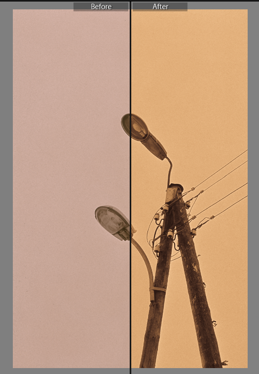

Posted to give an idea about what scanner saw and what got edited in Lightroom, as it'll inevitably look different than what's posted above on the light table.
I could be wrong, but the scanner probably got the color balance wrong and hence the pink tone in the highlights. The colors in the light table pic are closer to what you see in the slides.
No, my friend - you're EXACTLY RIGHT - will remove/update the nonsense I posted - thanks for pointing this out.
It does look like what's on the table + slight pink cast.
It's the age old Plustek 7600i Ai set to Positives and 16bit color. And got the tone wrong. How can I tell my scanner this?
While I appreciate the sentiment, I have hard time accepting such deviation and there's far more accurate examples I've posted already in those strips, so it's not really a loss. Good riddance I'd say + I need to speak with my scanner.
That or to tone Highlights selectively in Lightroom to match the projection more closely, I'll repost those examples if I'll come ± close.

If you have color corrected grey card, you can scan it in and then use that to correct your slide scan color temp.
:Niranjan.
All I have is an IT8 calibration slide that doesn't help, a pair of eyes popping out of a brain that sports lack of understanding of color/skill of balancing it - wish me luck :D
Here's a kicker: EOS 400D with WB set at Tungsten looks correct on it's LCD. But when said RAW gets Imported in LR and WB set to Tungsten, I takes on a pinkish cast too, far less dramatic. So I'll have to work with my scans from projection on the side for better representation.
You may want to adjust Temp and Tint on LR to get the colors on the screen match the projection.

lol I solved this by working with the same scan in LR > Develop > Treatment: Black And White, and replicated the effect very closely just by doing Split Toning alone. Good, won't have to deal with bloated files and this way I can represent my toned slides to the best of my current ability.
Will post my scans and LR > Before/After at the new, appropriate topic.
Here are my color-corrected scans.
It was best not to scan them at 16bit color and let the scanner get autoconfused, but to do the regular 16bit BW scanning workflow and replicate the effect very closely (side by side comparison with projected image) in Lightroom > Split Toning - down to the slight pink cast in highlights.
