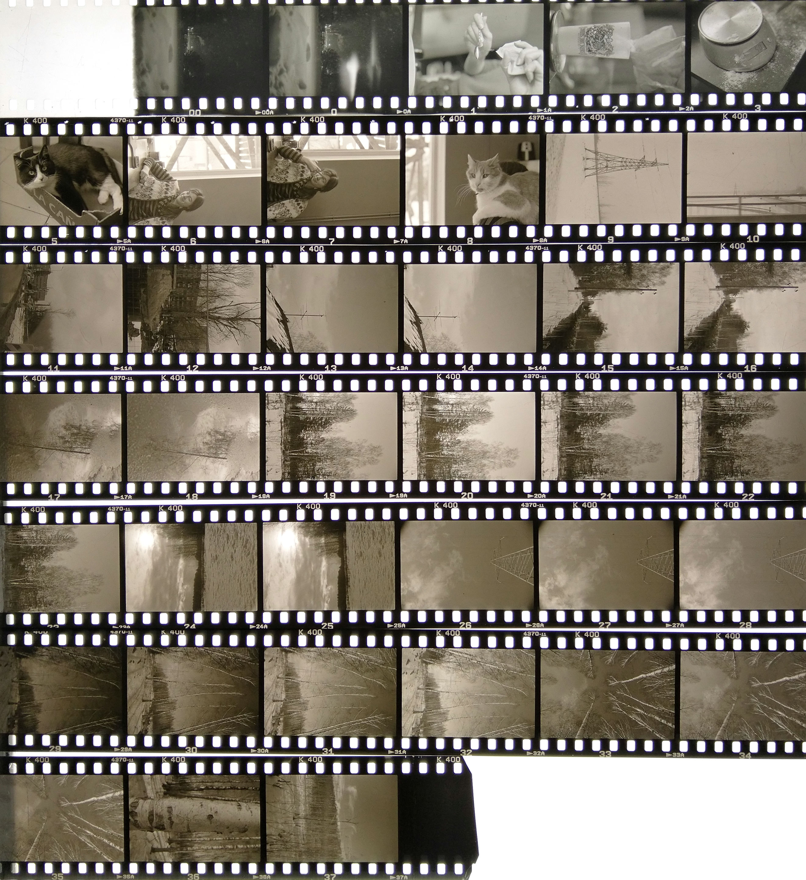

Had another go with Kentmere 400 pushed 2 stops and reversed in PQ Universal.
Left some frames untoned for comparison and this informs me: if I'll shoot K400 again (winter season, URBEX, night scenes), I'll definitely tone it - improved density being one of the key reasons. Now I'm interested how Delta 100 would perform.
