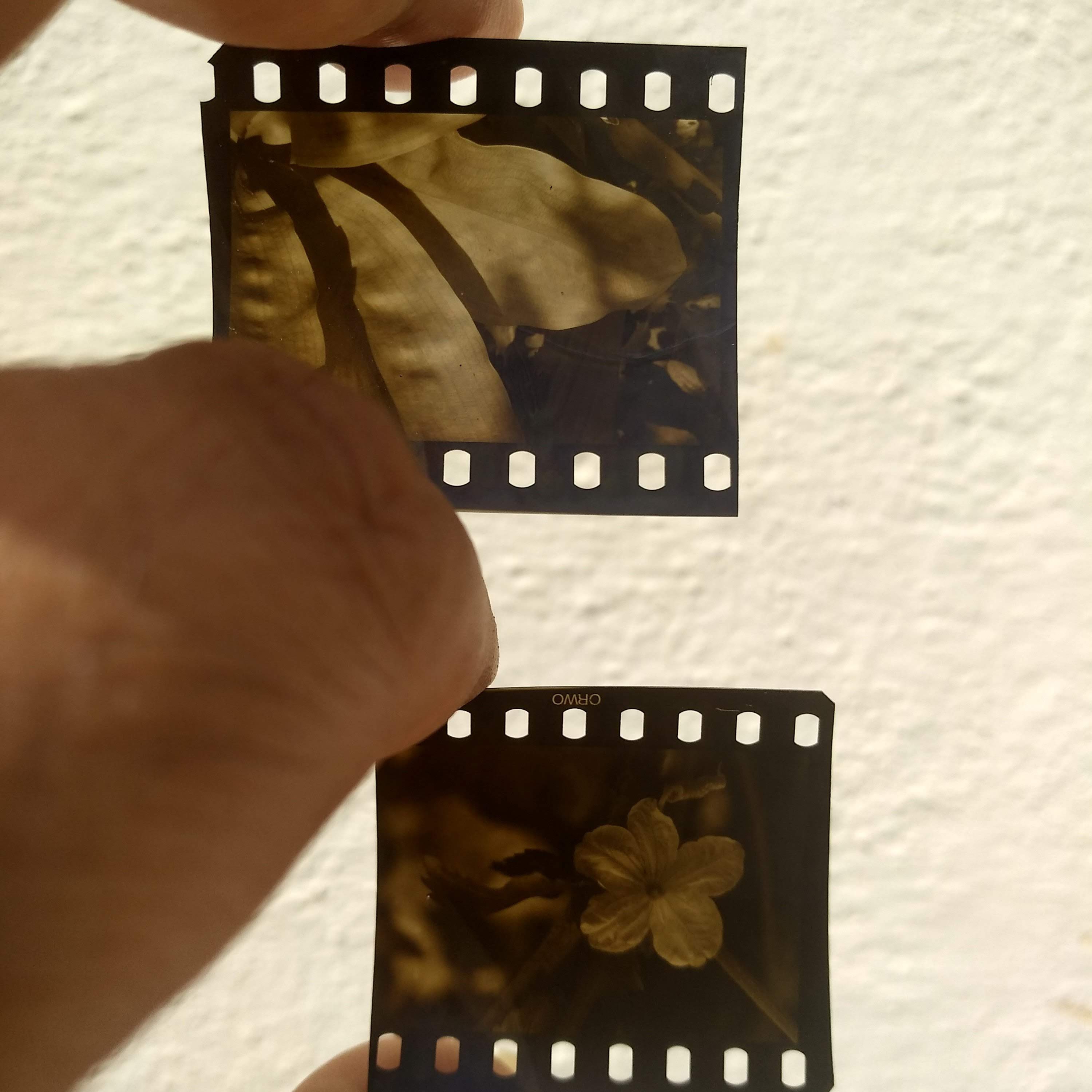

Attached is a phone snap of the two scrap slides I used for testing. The yellow-brown tone is visible in the pic. Will do more testing in the weekend.
[Edit: @moderators: hope it's ok to share film toning examples and experiences here.]

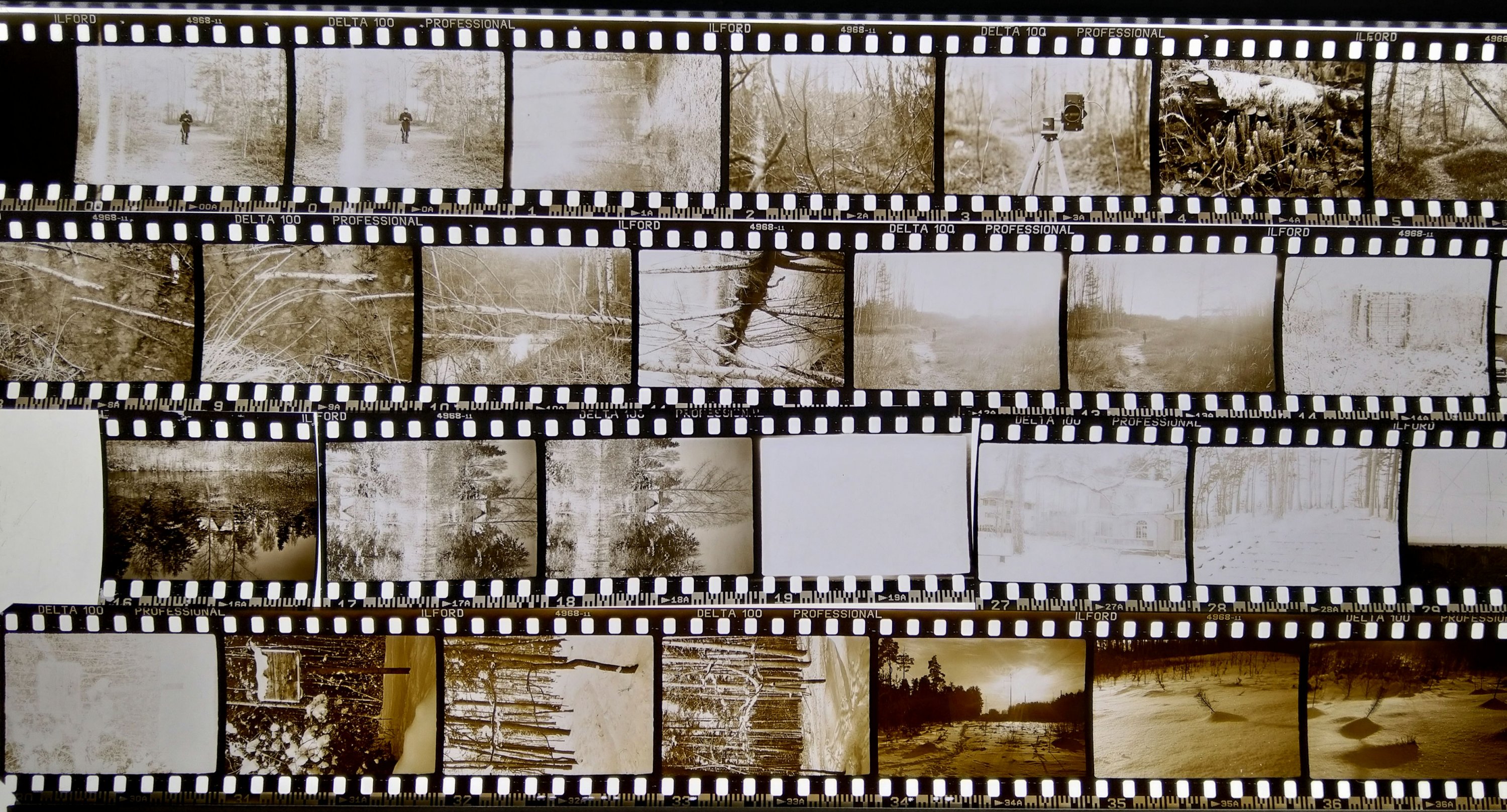

I had to check this out, so I reversed and toned Delta 100 @400 for somebody else today. Photographer has experienced some metering problems, but the selective toning went beautifully!
Reversal to Clear -> Wash, then:
Row 1 and 2: Re-exposed, then redeveloped for 1min in first developer (used as second) -> Toning for 30min -> Fix
Row 3: a slide from the attempt above + a row of re-exposed slides, developed for 2min in first developer (used as second) -> Toning for 30min -> Fix
Row 4: first strip to attempt toning with and to time it - straight toning after Clear, without re-exposure and redevelopment. Took 30min to complete -> Fix.
Why so long? PH issues?
My uneducated guess would be that the selective toning should work the other way around too: for neutral blacks-midtones one could possibly attempt to first tone for a fraction of the time and then redevelop in second developer to completion, then Fix.
Will try this out with my next film.

Here are couple of scans from the slides above:
EDIT: removed scans that showed the wrong color cast - massively different from what's projected.
Sorry for that, will do better.
Here are couple of scans from the slides above..

It's what got scanned with with little adjustments in Silverfast. Namely -2 midtones and -2 shadows, double exposure option and some exposure boost to compensate for the base fog - rest left untouched, everything Auto off.
Posted to give an idea about what scanner saw and what got edited in Lightroom, as it'll inevitably look different than what's posted above on the light table.
The big difference here, Ivo, is how much the highlights such as the white snow and the sky has turned pink. Is this something that only happens on slides or can the same effect be achieved on prints?
Thanks
pentaxuser
Truth is - I have very little darkroom experience - slides don't require one, a bathroom will suffice. But putting one together is one of my current dreams, seeing how much I enjoy working with film. That said I can share my observations and thoughts.
Double-X reversed retained a lot of silver in highlights - similarly to another film: Scala 160 / Silvermax 100 that makes those highlights creamy - so there was silver there to be toned and the effect is reduced the more blown the highlights are (less dense/less silver).
I actually don't like highlights toned this heavily, so I'm glad that the partial toning worked by developing all the silver in highlights first, leaving only the rest susceptibe/convertible to toner.
How can this behavior be transferred to print is currently beyond me - as are prints :smile: But I guess that a reversed print could behave similarly - someone could try this out.
