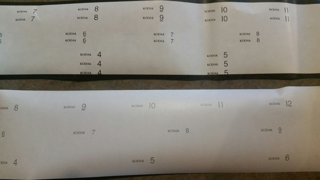

I found the problem on a roll of T-Max 400 I developed, then came on here to research it. Thanks to the info in this thread, I found that I had two boxes that fell within the problem batch numbers. I emailed KodakAlaris last Thursday with a sample image showing the problem, as well as photos of the boxes with the batch numbers. Mr. Mooney replied within two days and shipped replacement film that arrives tomorrow. That's pretty great service in my book.

My two pro packs are 0154 001, expiration date 09/2018
So they are more recent, and therefore have the very newest, revised backing paper.

The backing paper on 0154 001 expr. 09/2018 has no black borders at all (Bottom) The 0148 004 expr. 06/2016 is at the top. No issues with either roll. The 2016 roll has been in a fridge last year and a half. I get all my film from B&H usually order in the winter. Can't help but think that heat is a big part of the issue. Looks like Kodak really reduced the ink level on the new stuff. I think they still have some serious talent, probably an over zealous Purchasing decision (say's an Engineer :smile: Mike

Anyway, another data point -- I last week discovered my last three purchased ProPacs of 400TX (one 921 & two 931s) were within the listed emulsion numbers. I contacted Mr. Mooney, who reported he considered the likelihood of a problem with the 931 batch very low, as complaints on that have been very rare. He suggested I try a roll on something non-critical -- BUT -- he also sent me replacements which arrived at my door this AM (about 5 days total). So I take some comfort that the perhaps shakey Great Yellow Father at least appears to be making a sincere effort to stay in the good graces of its customers. I had stocked up a bit for a trip in May that ended up not happening -- mayhaps it's just as well!

The backing paper on 0154 001 expr. 09/2018 has no black borders at all (Bottom) The 0148 004 expr. 06/2016 is at the top. No issues with either roll. The 2016 roll has been in a fridge last year and a half. I get all my film from B&H usually order in the winter. Can't help but think that heat is a big part of the issue. Looks like Kodak really reduced the ink level on the new stuff. I think they still have some serious talent, probably an over zealous Purchasing decision (say's an Engineer :smile: MikeView attachment 158538
The new printing looks very similar to Ilford's, so it should be usable,just, in red windows, with the greatest of care, in all fairness to Kodak Alaris they seem to be doing everything in their power to sort this mess out, so I just might give their films another go
