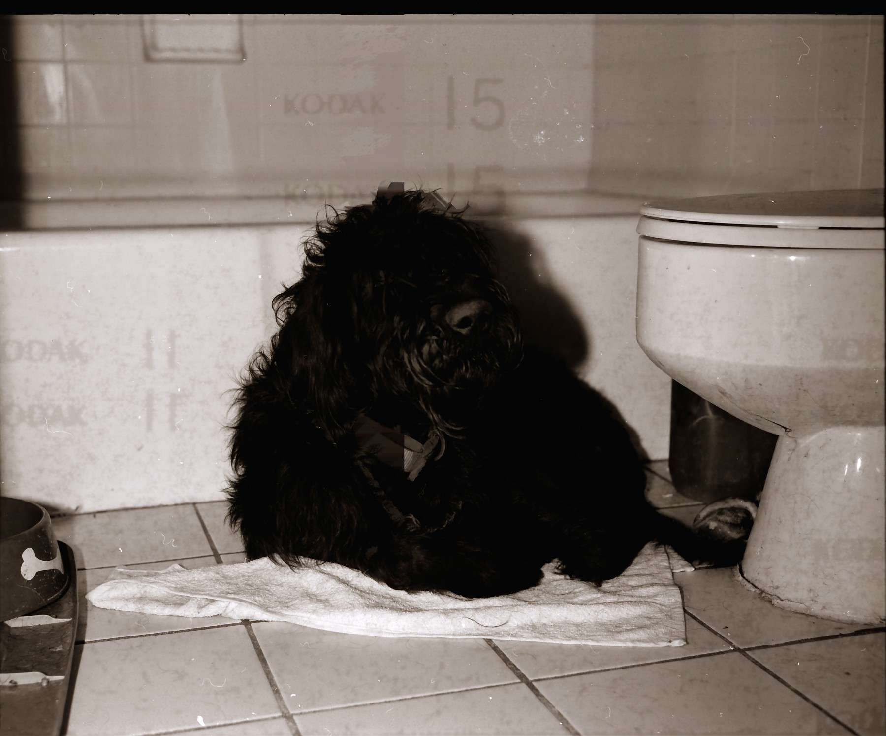

IMPORTANT INFORMATION FOR USERS OF 120 FORMAT KODAK PROFESSIONAL FILMS- PLEASE READ
As many readers are likely aware, I have used Kodak Professional film continuously for more than four decades. Over the years I have found Kodak film to be of the highest possible quality and consistency. However, anomalies can occur from time to time. There have been recent reports that appear to be associated with certain batches of 120 format Kodak Professional film.
The problem can easily be seen in the photograph below recently made by William Wetmore. I appreciate William allowing me to share this example with readers. You will notice the word Kodak clearly appears in the sky, along with frame number '13' multiple times. I first became aware of this situation a few months ago when a former workshop participant brought some online discussions on this topic to my attention. Unfortunately, as time has passed, I have encountered a number of students, colleagues, and friends who have experienced this exact problem.
I have spoken at length with Thomas J. Mooney, Film Capture Business Manager at Kodak Alaris about this phenomenon. He told me "Kodak Alaris has had a limited number of inquiries for similar problems, and that the affected film may have seen some abnormal keeping after it left the factory (e.g. sat in a truck over a hot weekend, etc.). That said, we are taking this issue very seriously and have recently made modifications to the backing paper which we believe should minimize the potential for this type of blemish going forward."
Mr. Mooney has supplied me with the emulsion numbers - which I have listed below – where this latent image print issue could potentially be seen. If you have experienced problems, or have questions or concerns, you should email Profilm@Kodakalaris.com. This email address goes directly to Mr. Mooney, who will be able to answer your questions, address your concerns, and replace any problematic film you might have on hand or have used.
If you purchase new film you should make sure that the emulsion number, printed on the box as well as the individual foil packages, is higher than the suspect emulsion numbers listed below. All photographers can imagine the disappointment and frustration any of us would feel if this happened to any of our negatives. Please pass this important news on to your photographic friends.
Emulsion numbers that may exhibit the above problem only in Kodak 120 format roll film:
(Emulsion numbers can be found on the film box, the foil wrapper, and printed on the clear edge of processed film near frame number 11.
Kodak T-Max 400
Emulsion 0148 004 through 0152
Kodak T-Max 100
Emulsion 0961 through 0981
Kodak Tri-X
Emulsion 0871 though 0931

I just put a roll through and it has the dreaded KODAK and numbers watermarks. Its expiry is Feb 2017.
Any idea what's happening with this issue? Has kodak acknowledged it? Do we know which batches are affected?
This is info that I'm reposting from another forum.
I want to share some important information about problems that have been described in this forum, and elsewhere, with Kodak 120 size films. PLEASE check your emulsion numbers with the information below, and share this information with other film photographers.
Here is the text of an article from my most recent eNewsletter. The full newsletter can be found here: http://www.johnsexton.com/newsletter05-2016.html
Kodak T-Max 400
Kodak T-Max 100
Kodak Tri-X

I don't know if anybody else ever lined up their affected film with their original backing paper... but the one time it happened to me... the image matched up with the film where the numbers came to rest against the film AFTER shooting and winding forward...
The numbers did not match up with where the numbers touch the film as it comes from the factory.
That is interesting indeed! Maybe there is some kind of "after glow" or something from exposure. Like the way a fluorescent light bulb continues to glow for a short period after being turned off. What you indicate is that the problem crops up after the film is exposed and not before. Very, very interesting. Now we might be getting somewhere as to the source of the problem. Darn good work Detective Holmes.
That's a very interesting observation. If it's true then so much for kodak's defense of poor storage!

It's definitely the after wind. As you wind a roll.. the factory wind would put the 2 at the bottom on emulsion of frame 1 of a 6x9 neg. If it were an exposure mark of course it would be dark instead of light on a print. But it would be on frame 2. Also if it came through the base it would be on frame 2. It's on frame 3 (the 2). And that's where it rests ink to emulsion after you wind on past the frame.
I'm not sure that it is that simple, because the problem is one of sensitization, and whether or not the sensitization occurs either before or after exposure, the fact that it occurs sometimes is clear, but the nature of the causative mechanism is not so clear.
Poor storage has always made 120 film susceptible to wrapper offset problems - that won't change if the current problems of increased susceptibility are solved.
Bill Burk's sample size is pretty small - one roll, if I read him correctly. The conditions that that roll experienced after exposure were likely different than the before exposure conditions. I wouldn't be surprised to learn that some wrapper offset problems originate before exposure, while others originate after-exposure.
I can certainly see a possibility of the combination of film/ink/backing paper being more susceptible after exposure, because it has been taken out of its sealed packaging and exposed to air, heat and a little bit of light in the camera. It also might not have been re-sealed after exposure as tightly as when it came from the factory.
What I'm having trouble with is visualizing the film and backing number sandwich - the back of the film stays stationary against the carbon black side of the backing paper as you wind it through. Why is the emulsion side "moving" vis a vis the numbers when you wind the film from feed spool to take-up spool?
I could be wrong Bill, but I think that the inked number 2 is resting against frame number 1 both before and after exposure.
Because the roll is reversed on the take up, and so the numbers lie next to a different bit of emulsion.

Now that I think further, I believe that there is a change.
On the feed side, the pressed against numbers are for frames that have higher numbers than the frame being exposed (frame number 2's emulsion is pressed against the inked numbers for frame number 3).
On the takeup side, the pressed against numbers are for frames that have lower numbers than the frame being exposed (frame number 2's emulsion is pressed against the inked numbers for frame number 1).
They probably don't line up nearly that neatly, but I think the trend is correct.

The image matched up with the film where the numbers came to rest against the film AFTER shooting and winding forward... The numbers did not match up with where the numbers touch the film as it comes from the factory.
That is really odd. If you are sure, you should contact Kodak as soon as possible.
Why is that surprising? A reaction between emulsion and backing paper/ink can happen any time. Actually a reaction after respooling is more likely as the climate control is less (due to the protection of the foil packaging has gone).
Had the artefacts reported so far all happened before respooling?
or maybe everyone THOUGHT it happened before respooling but they didn't look closely
like bill did and it all happened POST spooling ...
