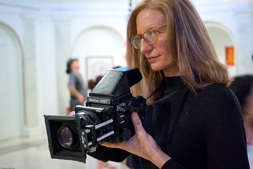

I used an RB67 reasonably regularly without a tripod.
And I'm not the only one (actually an RZ67)!
But I wouldn't have wanted to try a Fuji GX! :smile:
