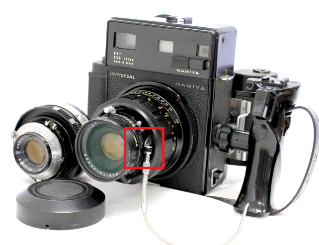

Have you used the Mamiya press yourself? Any insight you can give on it? Not a HUGE amount online but the price is affordable and for what I'm looking for (entry level MF with a decent negative size) it seems cool. Not an SLR, sadly, but I think I can live with that under the right circumstances
Yeah. I used frequently. It is quirky for sure but fun. Got both the 6x9 and 6x7 backs so switch from those format often.
Using the grip make it quite easy to handle. Also, since some models have back movements/extension and viewfinder hood, you can shoot either closeups or use movements so everything is in focus.
A little bit heavy but not as much as the RB67.
Mamiya glass is first class.

By the way, about the only issue I ever had is that the part where the grip cable attaches to the lens was often twisted when I put it on the bag, at one time the screwing part on the lens became lose. Repaired myself with plyer and some glue but something to keep in mind if you decide to go this route.

Now I'm also considering a Mamiya Press! Which I just found out about. I like quirky/weird systems and the image quality and changeable backs seem good. It's also very cheap compared to a lot of the other systems here. Because I'm just shooting as a hobby and don't need flash or ***the best*** on the market, it seems like it may be a good choice.
As long are you are willing to lug it. The lens tend to be slow but sharp at working apertures. The Universal has built in frames for 100, 150 and 250, need an external viewfinder for the wides. Be careful about lens, Mamiya made a version for Polaroid but there are issues with swapping lens. There are two version of the 100, a 3.5 tessar style lens and 2.8 5 element design. I have the 3.5, which is collapsable so you need to make sure the lens is extended when shooting. I bought mine used, had been owned by a wedding photographer who traded it in for Hassey, the owner of the shop told me he regretted it, a lot of money for not much improvement in quality. I also have to press cameras in 2 1/4 by 3 /14, a Speed and a Bushman, these take sheet film, the Speed Graphic is made of wood, very light, I have a Topcon 101 Pro for it, this will be my hiking camera. I will keep the Universal when shooting close the car.
