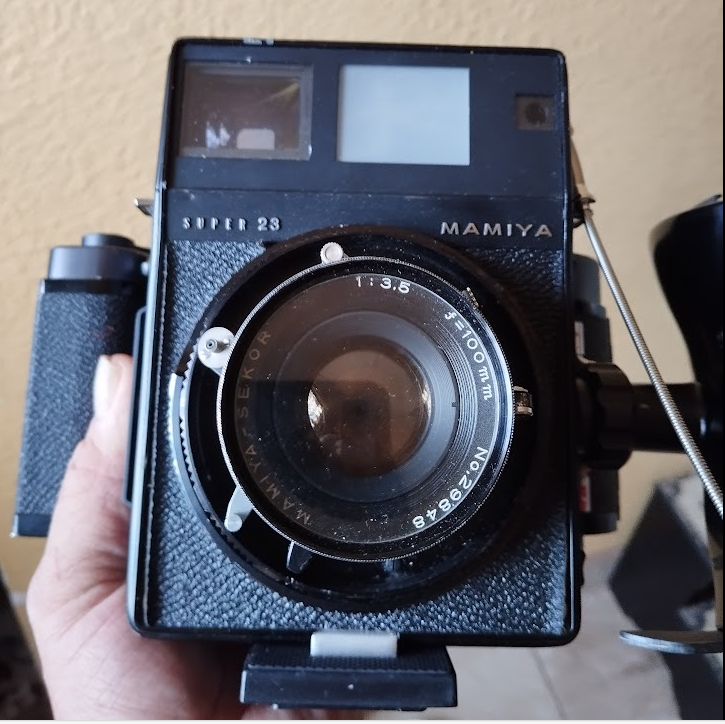

Well, after all that, I decided to go in on a Mamiya Press Super 23 with a 6x7 back, for $219. Definitely an underdog pick from what I've read here, but I like the idea of having a weird camera, the condition seems good with easy returns to Japan, very cheap compared to these others, and I've liked everything I saw about the camera online. Easier purchase than a lot of these other more expensive cameras!

Should come with the 90mm rather than the 100 as 90 is normal for 6X7. Next I would think about a lenes, the 65 or 55, if you do decide on a wide make you get one with the correct viewfinder.

From what I have seen it seems to be about as heavy as the Pentax 67. For my usage, I don't think the bulkiness will be an issue, and I actually want something bulky to help me slow down a bit! I got it with the 100mm lens and will start looking at others once I get some rolls through.

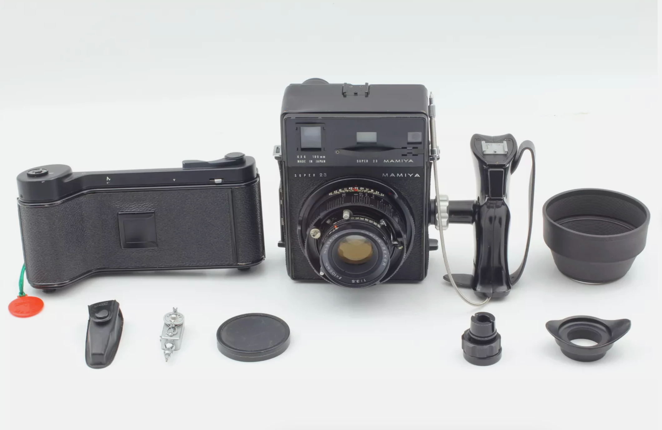

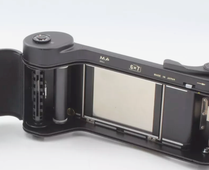

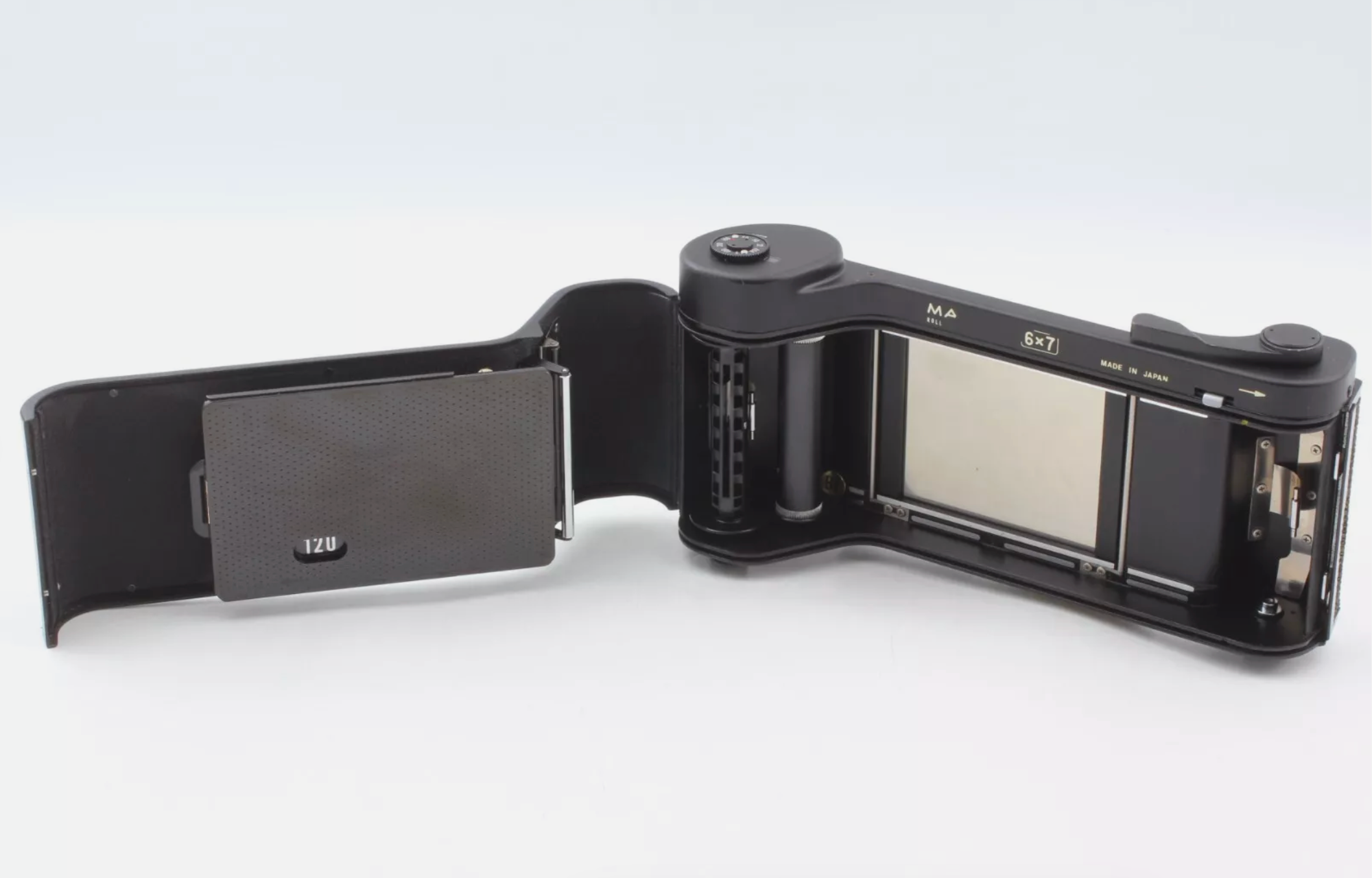

For reference this is the kit I got, and the back I'm looking at. It seems like there is no difference between the backs for the Universal or the Super 23, but I'm actually not sure, because only the Universal can take Polaroid backs, so I wonder if there's some difference.

I got the same back and also the one for 6x9. I guess main difference between Super 23 and Universal is Universal lack the back bellows and that Universal can fit a G adapter so you can mount Graflex backs if needed.

I just doubled check my Press, it will not take a G adaptor so the only option is a Mamiya back. I have my Press set up with ground glass back for sheet film.
