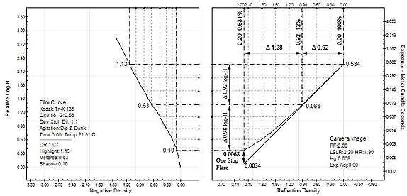

The problem with contact printing step wedges is that it completely ignores the flare that is always present in-camera and when enlarging. In-camera flare affects the shadow detail and effective film speed and changes the distribution curve around in the low-density values (shadows here).
Actually, that is the reason to contact the step tablet with testing film. The object is to determine the measured response of the film to levels of exposure. Flare is nearly impossible to measure and control. Plus, it's associated with the camera image and not the film's characteristic curve. The ISO B&W speed standard incorporates flare into it's methodology.. Camera image flare doesn't change the shape of the film curve but how the exposure is distributed on the film curve. Proper contrast determination requires factoring in the apparent reduction of the subject luminance range into all calculations.
