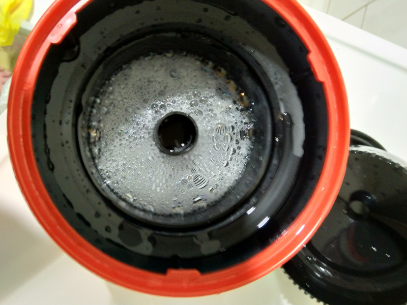

Well, that was an interesting test with using Photoflo 1+200.
First of all I tried to calculate number of drops per ml. I drew up 2.5 ml Photoflo into a syringe and tried to dispense it drop by drop into a spoon. I lost count around the 60 drop mark. The drop size may also not be the same as my normal usage; i.e. dip my thermometer into neat Photoflo and allow a few drops to fall into tank with final wash water.
I then mixed up a beaker of Photoflo 1+200 and allowed it to stand for about 20 mins before I started development. There were a few bubbles which had disappeared before I came to use it.
After the final wash I drained the tank and gently poured the Photoflo solution. I got a load of foaming in the tank which gave me reservations at first about removing the film reel through the bubbles.
I followed my normal hanging procedure which is to attach film to clips and give the film 4 or 5 whips to shake off surface drops.
Normally at this stage I would see sheeting of water across the emulsion side and just pin head sized drops on the non emulsion side. In this case the water was sheeting fully across both sides of the film. The Photoflo was doing its job fully. I also noticed a large number of tiny oblects in the sheeted water which I now realise were little air bubbles, smaller than pin head size.
The film dried perfectly without any water marks or chalk deposits of any kind. It's as good as I have ever seen. There may be dust particles but I haven't scanned it yet but as I said previously, dust is like death and taxes.
Will I change my usage of Photoflo? I don't know. The only downsides for me are the extra prep work in preparing yet another solution in addition to dev / stop / fix and my Photoflo consumption will rocket from less than 3 bottles in 40 years to maybe one bottle every 2 years or so :wink:.
If you pour your Rinse aid solution on the wall/lip of the tank in the direction and spot shown, you won't get any notable foaming even with very strong/foaming dilutions. I use 2x as strong, agitate with stick every 30s and haven't seen such a blanket of foam in my life, even souping both reels in it for the usual 2 minutes.

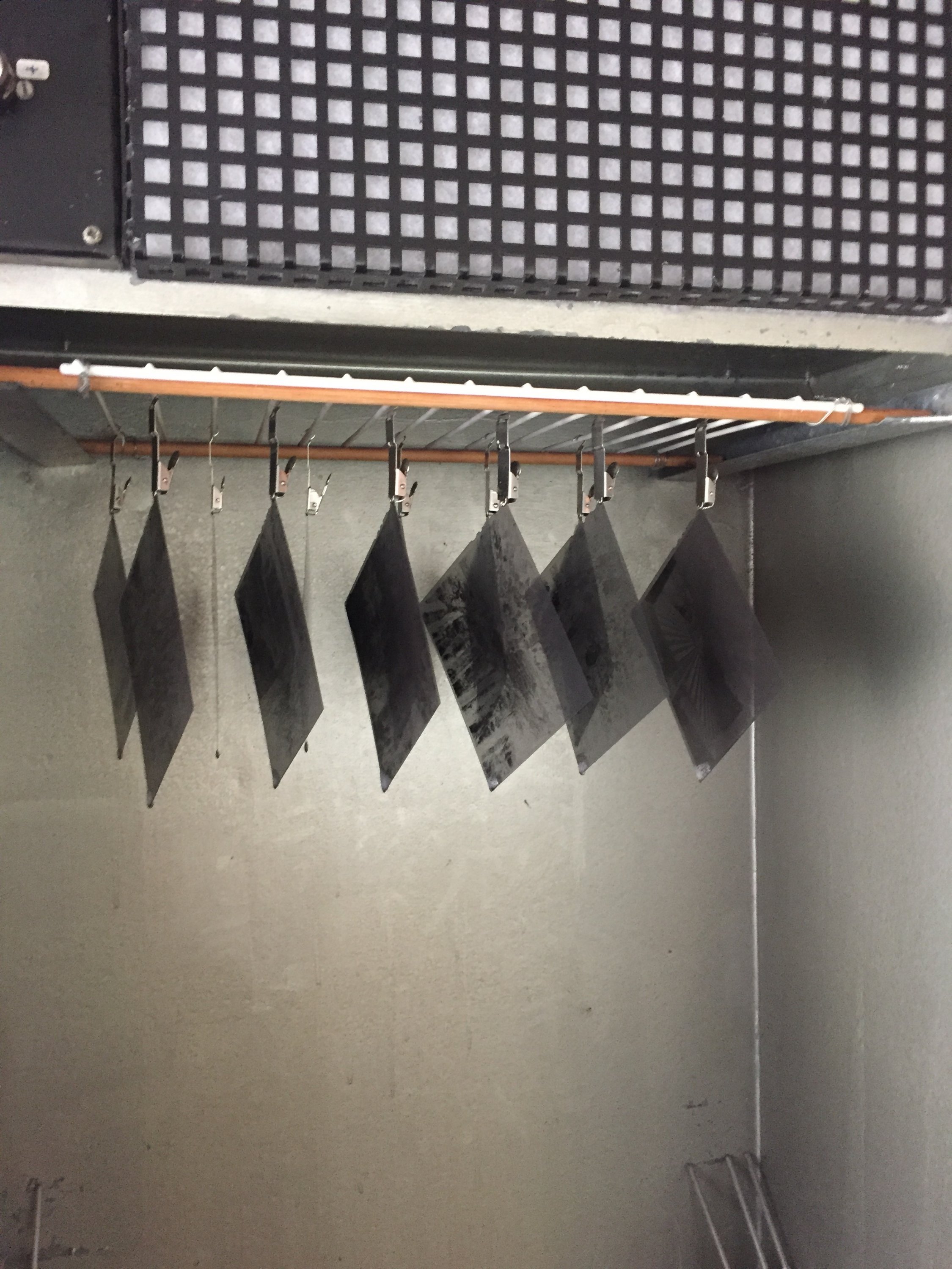

I wash film this way, and I get *no* drying spots. Negatives look perfect.
But after pulling the reel of 35mm film out of the water, I fling it by hand to remove as much water as possible. Then when I remove the film from the reel, there are no large water-drops on it.
Mark Overton
After the final SISTAN bath, I hang them in the drying cabinet without the heating (normally around 40°C) as the sheets tend to curl a little and the drops at the lowest corner ar drying in as circular marks.
You can easily these drops, I usually tick them off.
As I saw only few spots on the negative after my distilled water rinse (no wetting), I think this might also work. Just need to get those small drops off.
For sheet film I haven't had any problems. 120 films are usually pretty clean too. The troublemaker is 135 size film..
