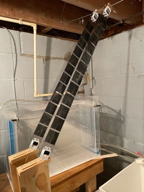

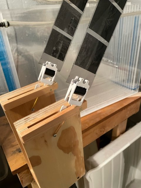

I developed two 120 rolls tonight and wanted to show how I hang my film on an angle to dry. I would recommend the Paterson film clips with the pins that hold the film very secure. I hang mine from a line and then secure them to a wood holder that uses rubber bands attached to screws and also a slot to hold the bottom film clip from twisting the film back and forth. The pictures will hopefully show it better than I can explain it! Hope this helps some folks looking to try this method. It solved all my problems.

Thanks for showing that to use Brian! I'm now mostly using 36 shot 135 film, so I would need some kind of anchor on the floor. Those clips with sharp teeth are of course needed.

For others who do not want to read that thread through, here is TL;DR: hang the film in angle for drying. (I need to try this too)
Keep reading the thread all the way to completion.
it is ironic that the first reply to that thread is to hang the film on an angle which is what I had to do in the end. I think I was just trying to avoid thinking of how to engineer that.
