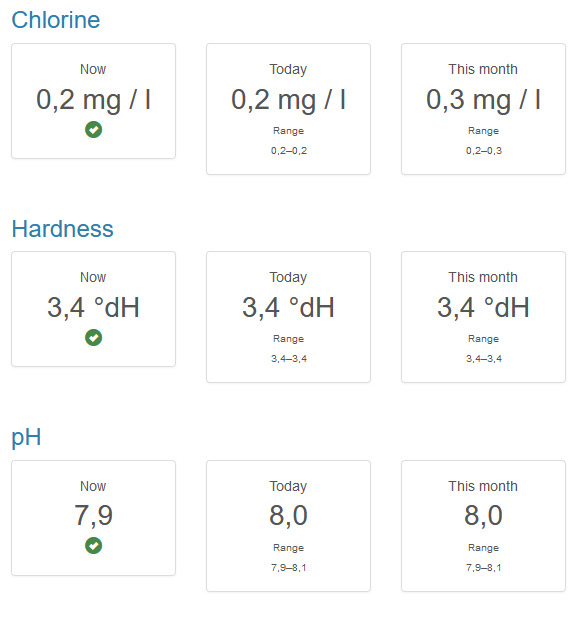

Here is current statistics of my tap water, is there something suspicious on these?

Conclusion is probably that with filtered water + photoflo there shouldn't be any problems. Strange; that is exactly what I do. There is always some marks on the non-emulsion side no matter what I do.
shouldn't the Ph be closer to 7.0?

Before investing in a way to measure the quality of your tap water, check with your water provider. Ours, a municipal service, has monthly breakdowns of dissolved solids and other data on their web site.
Me, I use distilled water with a little photflo and hang to dry in my darkroom and close the door. The only time I’ve had a problem is too much photoflo.
We are talking about drinkable tap water here. Typically tap water is 7,3 – 8,0 ph and the requirement is 6,5 – 9,5. Quite wide margin actually. They want to keep the tap water alkaline so that the pipes do not corrode.
I attached the analysis of my tap water above. Could you take a look at it and tell if something is problematic with the values?
