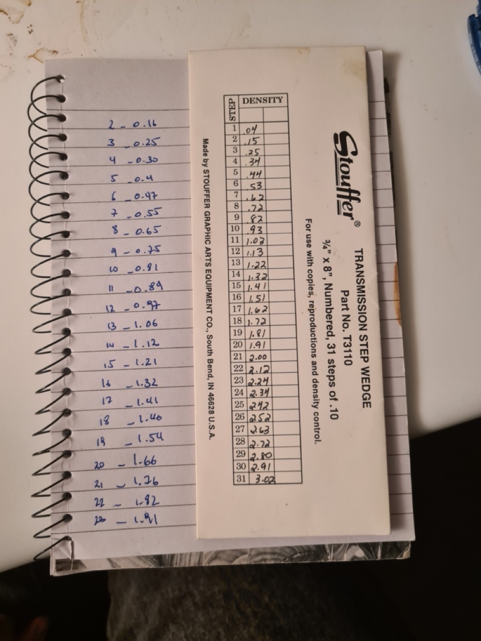

The Stouffer step wedge I received today (January 23, 2023).

I think Stouffer also claims NIST Traceable, and also offers the certificate if you pay them extra.
In any case, I'm not personally familiar with Applied Image. And their website is quite vague as to the specifics of how they measure their materials.
However, if you're curious, I suggest trying to start a conversation with them to ask all of the usual questions. (i.e. what devices do you actually use, how do you calibrate them, what are your own references, etc.)
I'm very much curious as to how they compare to Stouffer, and whether they're actually better or just more expensive with a better website.
Frankly, this whole Stouffer inconsistency is baffling to me too. So I'm curious how this all shakes out in the end.
(One thing I've been struggling with, is actually finding anything transmission related with color density calibration data. But again, off-topic for this thread.)

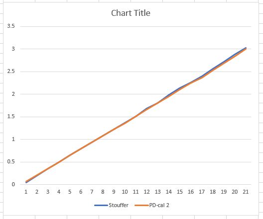

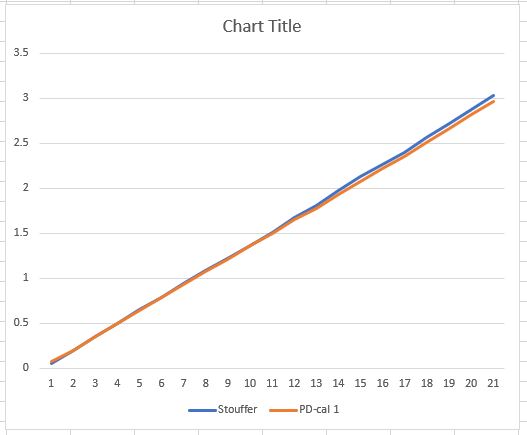

Back in my post #16, I stated that I learned from Stouffer that their step increment tolerances increase with increasing density. Here they are again:
Steps 1-4 .02
Steps 5-7 .03
Step 8 .04
Step 9 .05
Steps 10-11 .06
Steps 12-13 .07
Step 14 .08
Steps 15-16 .09
Steps 17-21 .10
I had noted that the PD measurements, while not the same as the Stouffer measurements, were, I thought, well within those step tolerances, especially from step #12 and up. Are those step tolerances related to NIST?

... mind keeps going back to these step tolerances increasing with increasing density.
It's simple - just look at the graphs in posts #38, #48 et al.. The lines start at a common point at 0.00 and then diverge at higher densities - all the instruments are linear they just look at the sample in a different way.
Additionally as the OD increases the signal decreases, and thus the signal to noise ratio gets worse and readings bounce around more. This bouncing, along with any non-linearity and optical differences, gets amplified at high densities because we are looking at the logarithms of small numbers. And in modern instruments there are quantization effects from A/D conversion that also get magnified at high density/low signal strength.
Yes I understand why the lines begin to diverge due to greater deviations in readings with increasing density......but my question is......if the PD measurements are within Stouffer's stated tolerances on the much more dense half of the wedge.......is there an actual "error" that needs addressing in the calibration of the PD? Perhaps I'm asking an invalid question.

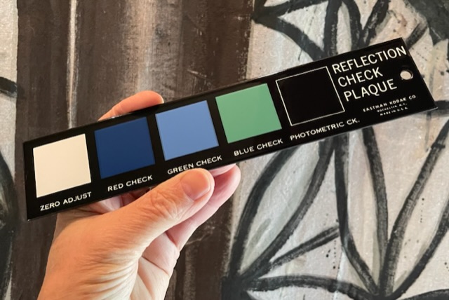

Mr Bill mentioned a baked enamel plaque.
This is what it looks like.

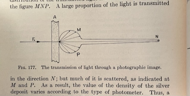

The Macbeth operator’s guide mentions emulsion up.
And the issue is described in Mees the Theory of the Photographic Process. Mees mentioned this discrepancy led to a fight between Hurter and Driffield and their critics.

Something that is not obvious is that the commercial densitometer have a certain optical geometry according to ISO standards. This is discussed briefly in "The Handbook of Photographic Science and Engineering," both issues have a couple pages. If someone uses a different geometry, at least with silver film, I would expect the results to have a different contrast.

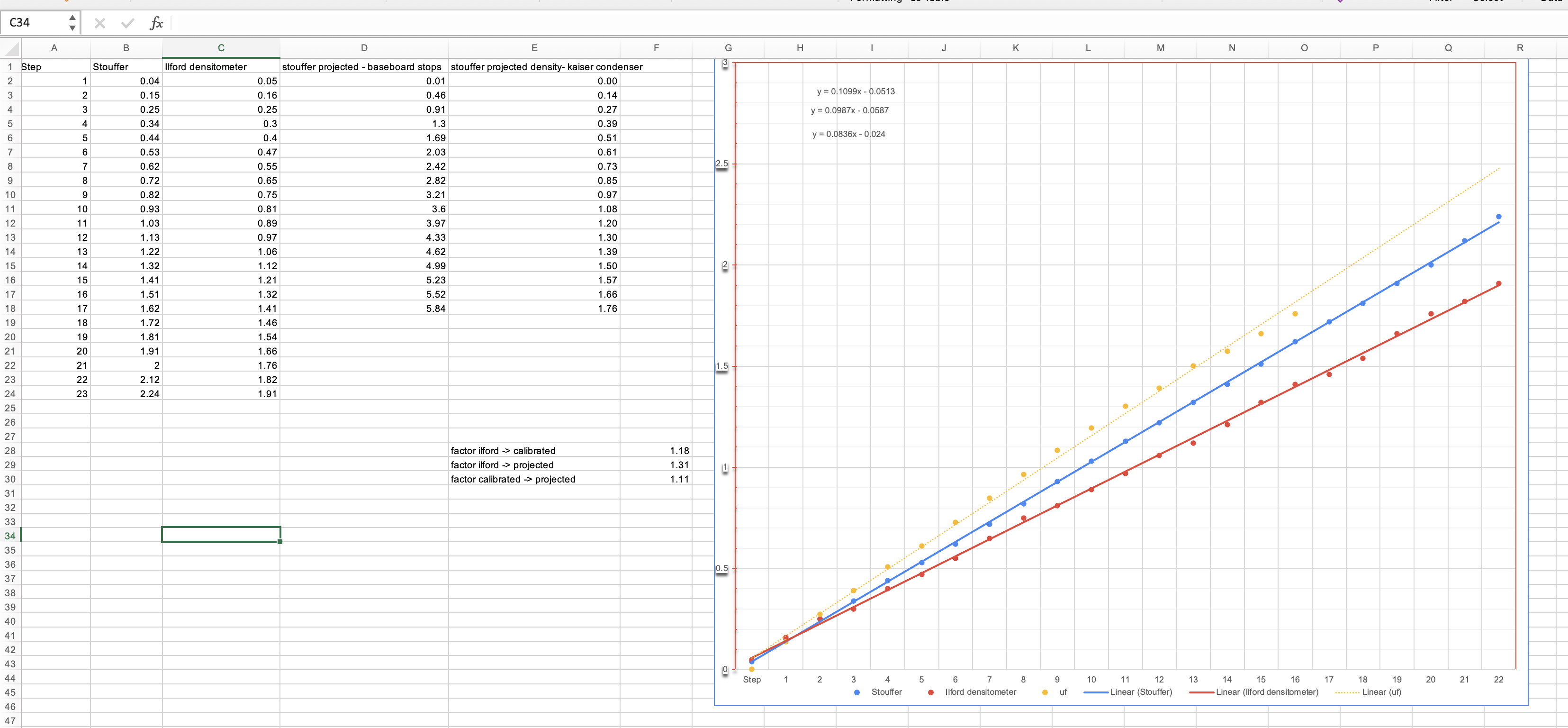

@Mr Bill, your remark above about "optical geometry" made me realize that the PD uses a diffuse light-source under the sample, whereas my enlarger is nearly a point light-source. So I remeasured using diffuse light, and you are right: The contrast changed. But the slope of the line went up, increasing the discrepancy with Stouffer's numbers. And the suggestion by @Nicholas Lindan to check spectrum showed that red has a higher slope also. My conclusion of all this is:
Measure the densities of your wedge under actual conditions.
Measure them using the same optical geometry and same light-source as in actual usage. Densities differ significantly based on factors such as spectrum and geometry. Thus, there is no single density.
So what's the use of a transmission densitometer? It's useful for measuring densities (and thus CI) of film. You'll measure the wedge and film under the same conditions that are provided by the densitometer itself. That's the only way to get an apples-to-apples comparison of negatives. But I guess such a densitometer isn't as useful for predicting what will happen with prints.
Why would a red light produce a higher slope on a Stouffer wedge? My theory is that the spacing of grains in the wedge caused destructive interference at my red wavelength of 660 nm. If so, @dkonigs will face this additional factor when calibrating a color densitometer.

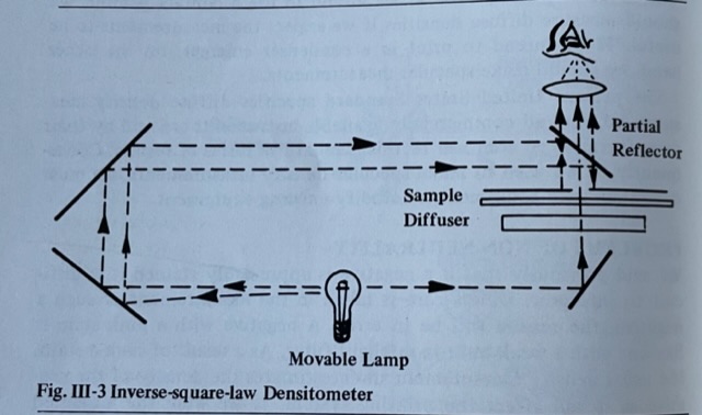

I took a closer look back at the SPSE Handbook of Photographic Science and Engineering (1973), which has a table of preferred densitometer "geometries" for various applications.
The geometries are, mainly, "diffuse" (a diffusion material or integrating sphere on one side of the sample, "double-diffuse" (diffusion material on both sides), or "projection" (with a lens arrangement, like condensers, on either side of the sample). So clearly, most commercial densitometers are the diffuse (single diffusion) style.
Per the table, a diffuse densitometer is suggested for either typical contact printing OR a diffusion enlarger (specifically where the diffusion is close to the negative).
For printing with a condenser enlarger it is suggested to use a "projection" densitometer with an aperture around f/4.5. I presume that this pertains mainly to "silver" films where scattering by the silver is an issue. I don't believe that color neg films, using only a dye image, are subject to thus (again, the Callier Q factor should be close to 1 for color neg). At any rate I was primarily a color neg process guy, and we happily used the standard "diffuse" style color densitometers for everything. As did probably just about every such lab. In fact, the major use of color densitometers in photography, from about mid 1980s, was almost certainly for process control in minilabs. At least in the US.

In 1909 Callier looked for a way correlate the different geometries. You might be familiar with the Callier effect. You can figure out a Callier coefficient. Scattering varies with graininess (with many exceptions) so tests would be needed for each film and enlarger combination.

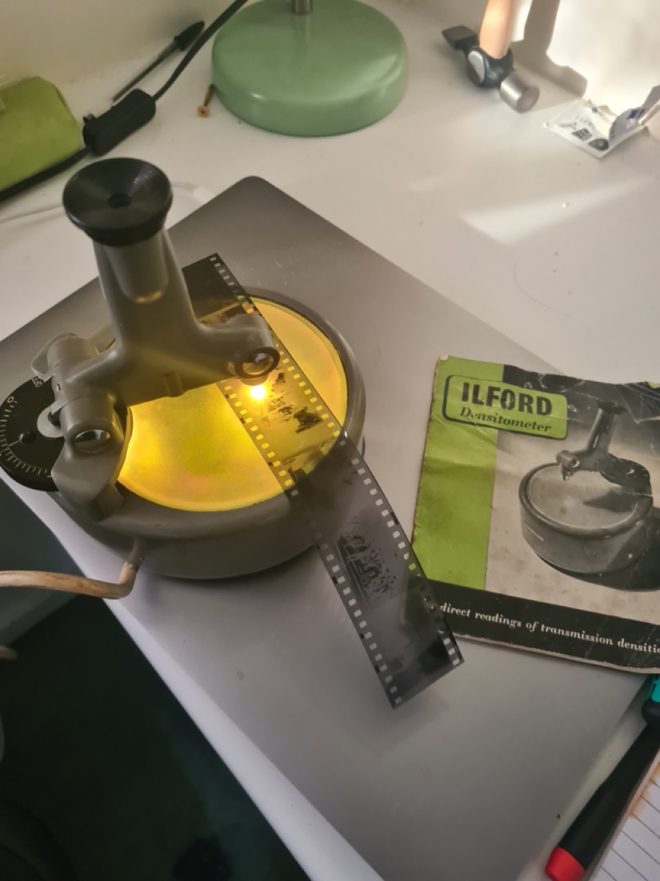

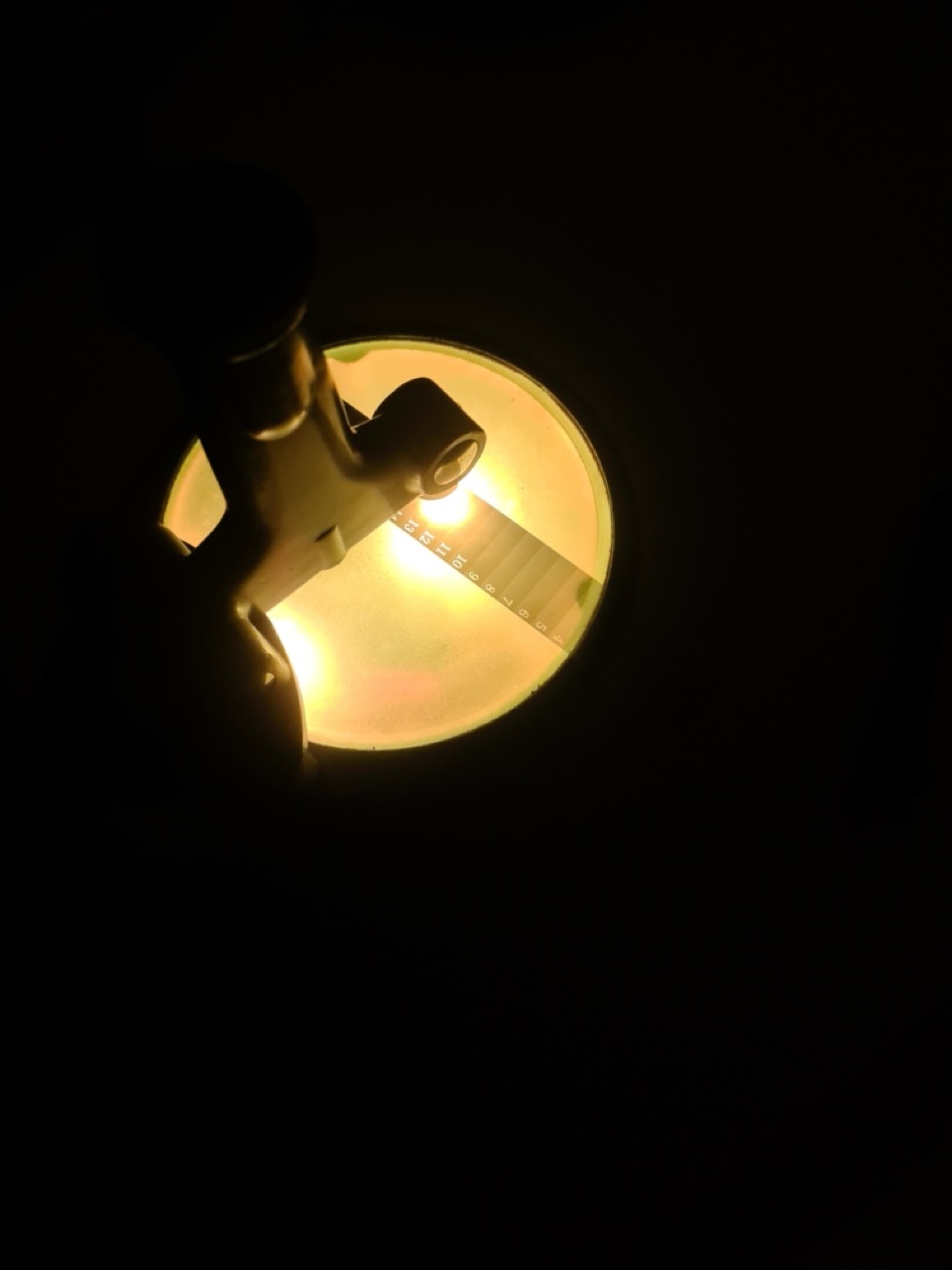

As another observation, I've recently got and refurbished/aligned an Ilford densitometer.
Please note the hammer was not used.
I also own a calibrated stouffer tablet, and used the densitometer to read the densities.
With the following results.
I have consistently lower densities using the ilford densitometer.
Then, I grabbed the stouffer tablet, and put it in my Kaiser condenser enlarger in a glass carrier. I put Mr. Lindan's baseboard meter in a fixed place in the middle; checked that illumination was exactly -5 stops going from f/2 to f/16 in my enlarger lens, and measured the baseboard densities. Sadly I could get only to step 16, as I got to over 9.99 stops.
Anyhow, as expected due to Callier effect, all baseboard densities are effectively larger.
I then plotted all my measurements (Ilford densitometer, stouffer claimed calibration, and the Mr. Lindan's meter) using excel as follows:
As you can see, it's quite lineal, so we can ask excel to calculate trendlines and divide its coefficients to calculate the Q coefficients between the measurements.
To get a stouffer density from the ilford densitometer, multiply by 1.18, and to get a baseboard density (in my enlarger, at my height) from the stouffer tablet, multiply by 1.11.
'm quite happy as this seems to show that the ilford densitometer has not faded, keeping linearity between steps. I don't get why it has less apparent density, maybe overall flare - but then that wouldn't be like a veiling glaze affecting non linearly all measurements?
It was also good to see the practice matching the theory - a measured density in the baseboard of a condenser enlarger - which is the density that gets applied to the paper - will be higher than one measured via a diffusion densitometer.
My new Stouffer Step Wedge came in today. It is very clean this time.............they packaged the wedge inside a clear plastic sleeve before placing it in the Stouffer rigid envelope so that the wedge does not come in contact with calibration sheet. I suspect they will do that in all instances going forward. Below are the Stouffer calibration readings up against the PD readings. PD-cal 1 is with the PD calibrated using the CAL-HI density of 2.92 off the calibration strip that came with it. PD-cal 2 is with the PD calibrated using step #20 (density of 2.84) of the Stouffer step wedge. Just as Derik had predicted, the PD was more in line with Stoufer readings at greater densities when calibrating from step #20.
On the left graph, Stouffer and PD have separated at D=2.5 about the same as mine, so I still think Stouffer is not as tight with controls as we'd like.
Derek, if your densitometer has the ability to PWM its lower LED, you could hack one to measure density relative to a sensor-open measurement by changing PWM until the sensor reads the same as sensor-open, assuming the sensor can average over one or more PWM periods. I think this would give you accurate densities of your gold wedges.
Anyway, the Printalyzer Densitometer provides much for the money. Bill and I are both glad we got one.
