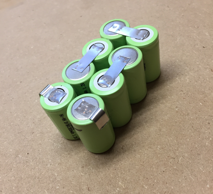

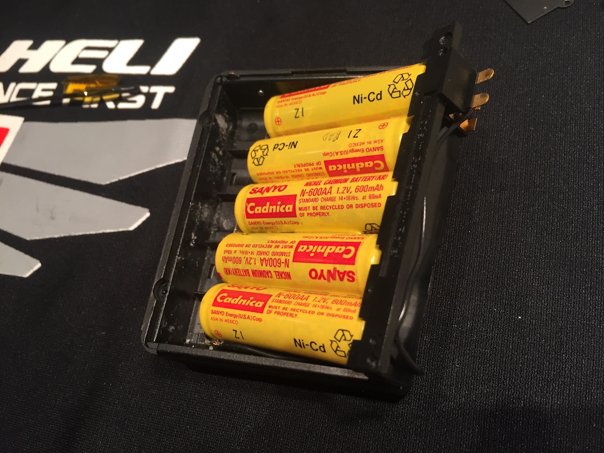

As an update, I did a bunch of research into the LiPo batteries and decided it was too much hassle to use them. Instead, I went with NiMH batteries, as they were much less fussy about storage voltage and charging. They were already a significant capacity increase over the nicd originals, so I went with that. I contacted a battery place in Regina, SK who made them for me and spot welded the tabs on for $5. I though that was a good deal. The cell size is 2/3A for reference, not 2/3AA.
I bundled the 8 cell pack and wrapped it with 0.005" thick sheet styrene from the hobby store to provide electrical insulation and that just fit into the Rollei cans, but doesn't rattle.I did a short wire to solder to the endplate and the packs were done.

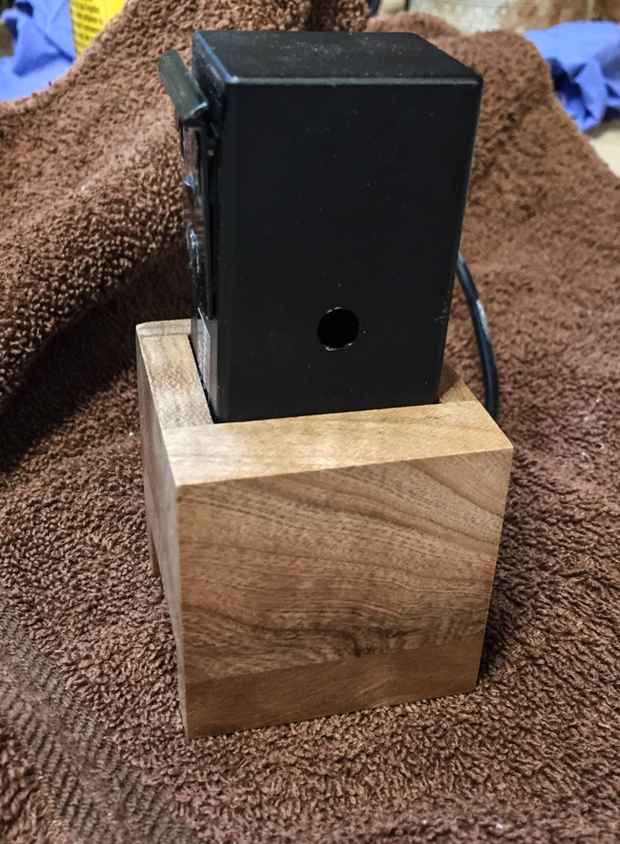

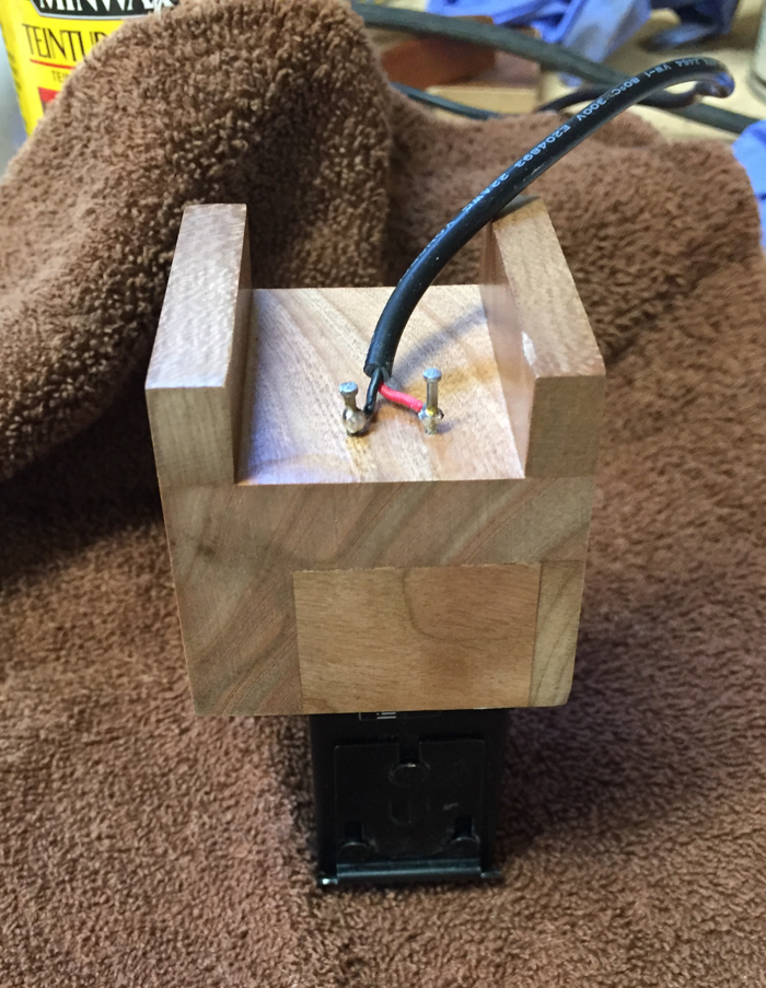

To charge them I found that 1" finishing nails are just the right diameter to make firm contact with the electrical contacts on the pack end, so I built a charging stand from cherry salvaged from a shipping pallet and put nails in teh end in the correct place such that the pack can only be inserted one way and pushes to the end and stop to engage the nail ends. Then I soldered a wire from an RC car NiMH battery charger to the nails and I have a custom Rollei charger for the pack with new batteries. So far my friend is reporting that the camera works just like new, and the batteries have excellent life.

Nice work! Yeah, Lithium Polymer batteries do have some downsides -- explosion/fire hazard being top of the list, and that goes double for custom-assembled battery packs and chargers that aren't matched to the pack. If the battery is built by someone with the right knowlege and skill, it's no more hazardous than that cell phone we all carry (which, yes, do blow up on rare occasions) -- but if it was built by Bubba, who has four different size tires on his truck and balances out the handling by hanging his head and left elbow out the window, even in the dead of winter, I'll pass, thanks just the same.

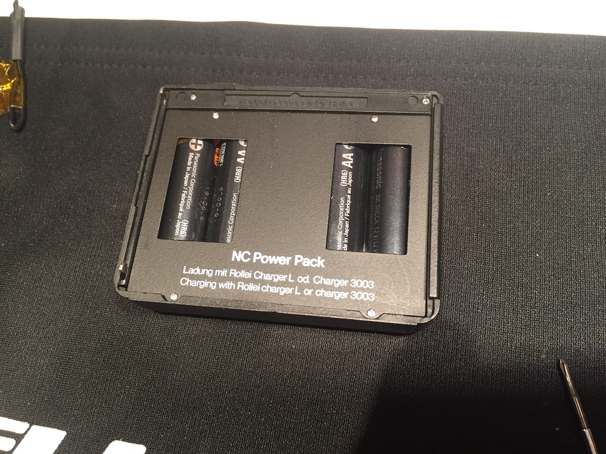

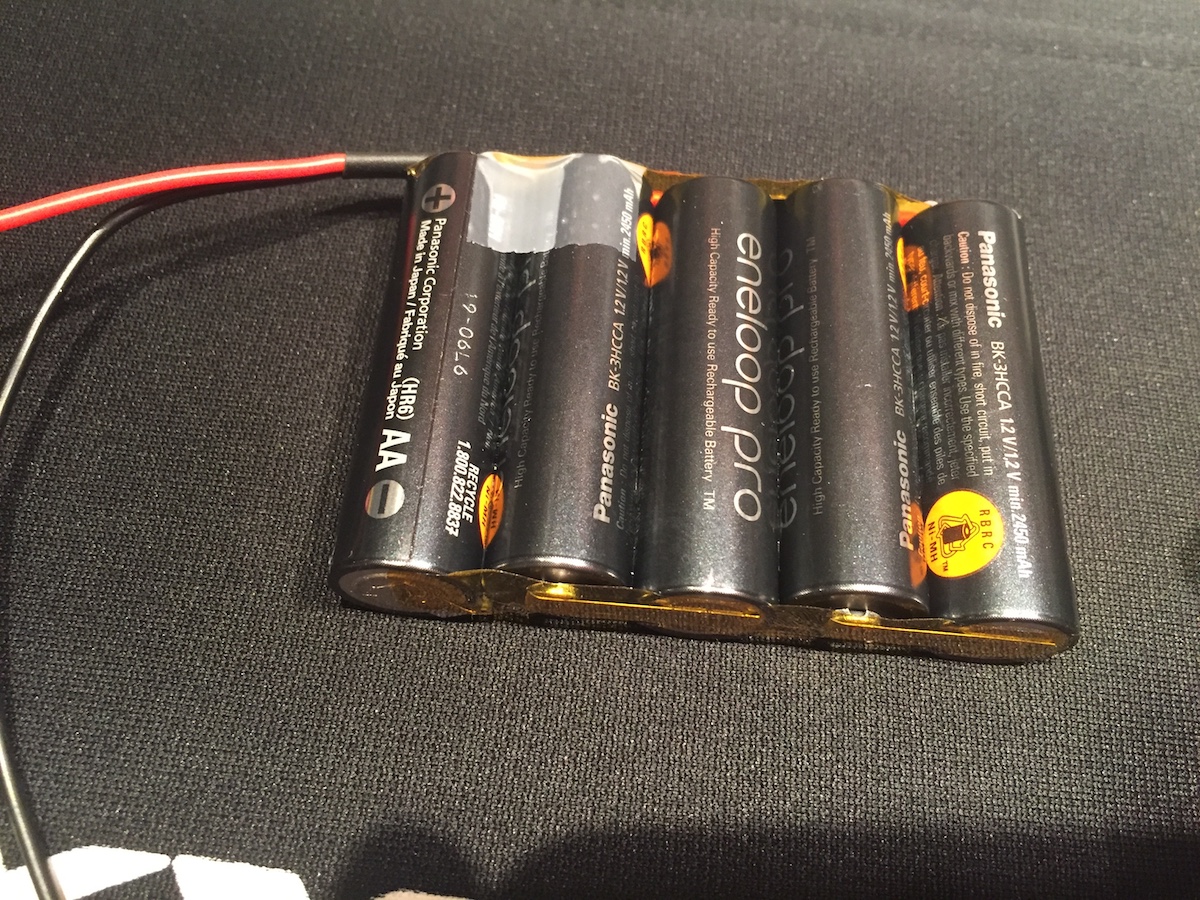

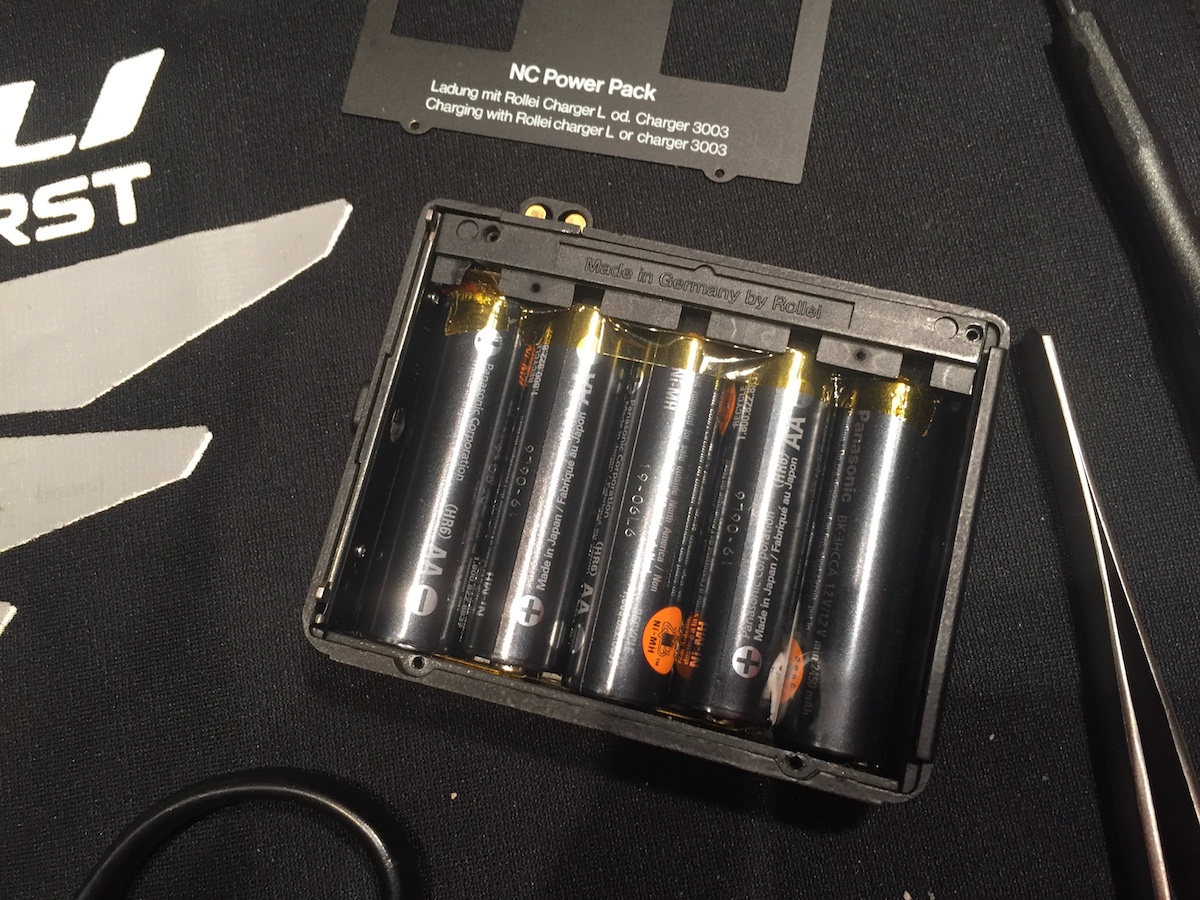

My latest battery project was to put Eneloop batteries in my SL3003 packs. Those have been great because now the SL3003 cameras are always ready to go without needing the 'quick charge' that I previously needed to do for the last 20 years.

I wish they make Eneloop batteries that would fit in the 6000 series battery pack like I put in the 3003 pack.
