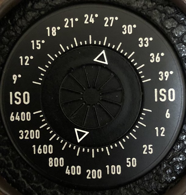

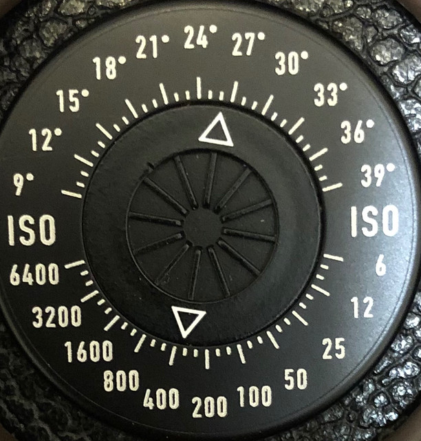

The ISO dial on my new M6 - trying to set it to 400:
An acquaintance was kind enough to send me a pic of the ISO dial on his new 2022 M6. He can set his to 400. So another thing broken on my camera.
Very sad. Thankfully my old M6 still works perfectly from new, and my IIIF also works perfectly following an overhaul by Ye.
