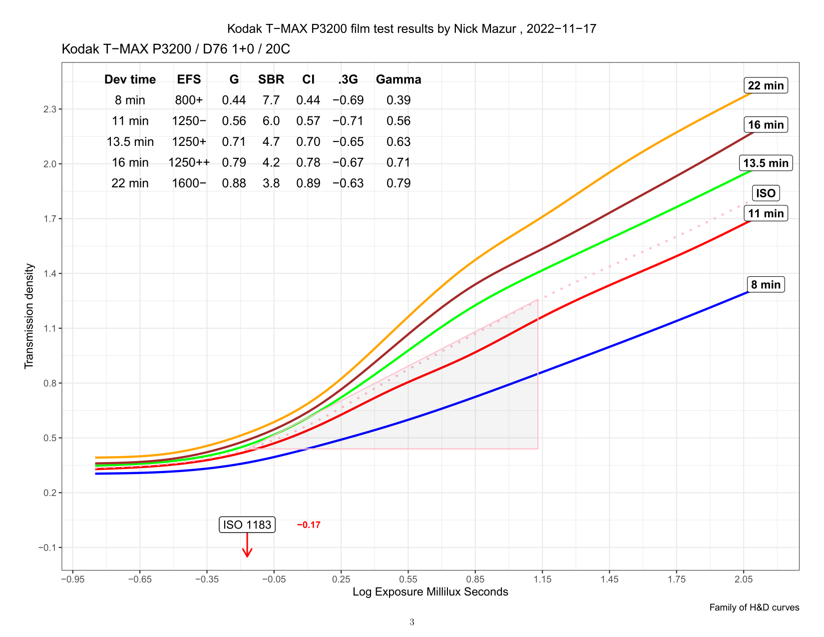

The Kodak T-MAX P3200 and Ilford Delta 3200 are highly popular and highly respected panchromatic films with high speed, respectably small grain, and beautiful tonality. I thought perhaps we could discuss their performance in this thread. I am going to perform a few different tests along the way and report my results once they become available. I hope you guys will offer your own comments and suggestions of what and how else to test these two films.

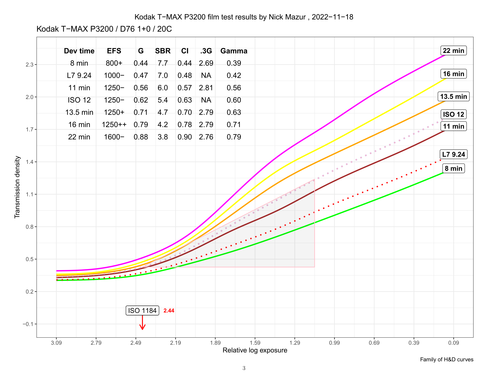

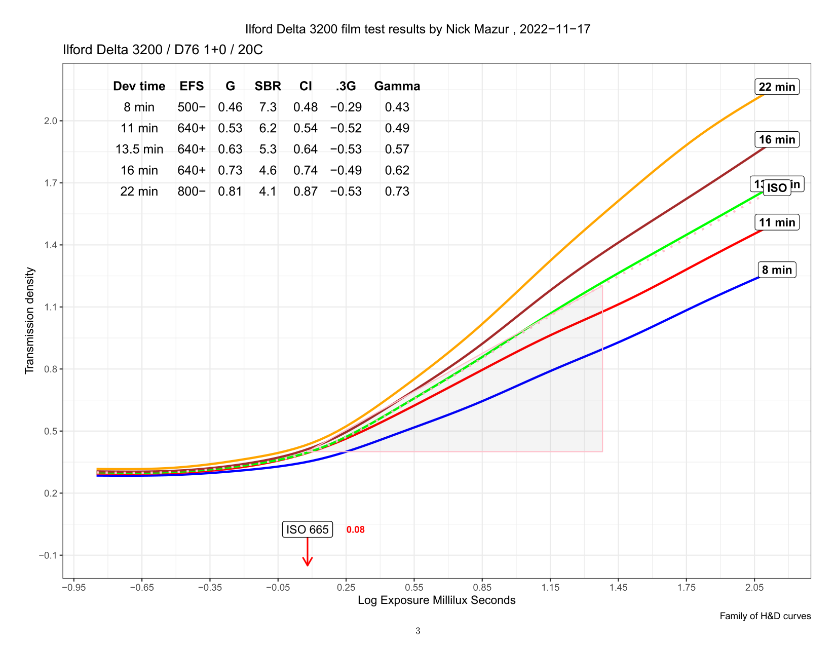

to start with, I ran a conventional curve-family test of both films, giving them the same exposure and processing them in the same tank. I ran the full test twice, each time obtaining very similar results. I then averaged density readings over the two trials. There is a lot of data to go through, so I am going to present it in small chunks, staring with a summary and curve family plots for each film. There's a lot more detail coming, hopefully, as the thread continues. At the end of my analysis, I will publish a detailed report.
The Kodak curves turned out a bit lumpy. I used two different rolls (both fresh), coming from two different mail orders to make sure I did not accidentally end up with a defective product. In each case, the curves ended up looking somewhat lumpy, especially compared to the well-formed Ilford curves. The two films have a different response to exposure and development. Kodak has a long toe and nicely controlled mid-tone and highlight contrast, as the development time increases. The film actually gains a bit of speed (shadow detail) over the range of processing times, of almost a whole stop, whereas Delta 3200 produces virtually no gain in speed, only in contrast. Bear in mind that I used D76, so the results would probably be different with DDX and XTOL. I am planning to use XTOL to push-process these films in the near future. Oh, and you will also notice that the Kodak film has a higher B+F density, at least with D76.
I plotted the curves using absolute log exposure values and calculating ISO film speed based on them. There's a summary table included with each plot. I must emphasize that I used an uncalibrated, DIY sensitometer, so the results are meant to be rough, "ballpark" estimates, only. I do have a calibrated and certified sensitometer, but decided to use the same exact setup as I did for my recent test of the CatLABS film, just to keep it consistent. I gave the films an exposure of around 2.24 MLS, which I estimated to be approximately what's needed for an ISO 1000 film. Again, there's a lot more detail coming soon.
kodakTmaxP3200_Proofer2PlotsabsoluteFinal.pngilfordDelta3200_Proofer2PlotsabsoluteFinal.png

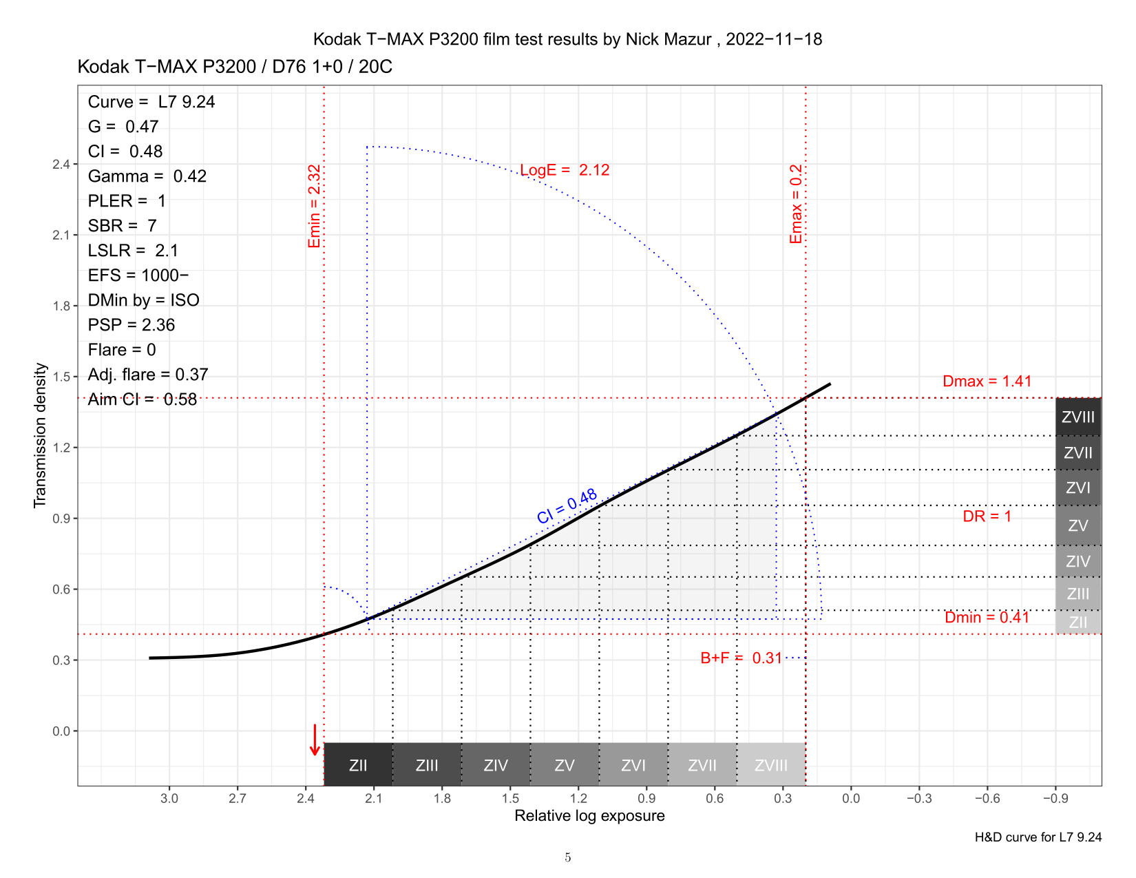

I happen to really like Phil Davis's Beyond the Zone System method and I think that a lot of photographers are familiar with it. So this time, I am including an analysis of the Kodak T-MAX P3200 curves done according to the BTZS method, which also happens to be what Win Plotter does. Win Plotter is an excellent, proprietary application for MS Windows. Instead of Win Plotter, I am using a cross-platform application that I am currently working on, which, hopefully, I will finish at some point and make available free-of-charge.
The first plot contains a summary of the curve family analysis. Instead of using actual log exposure values, the BTZS method recommends using a "Personal Speed Point" (PSP) and calculating all of the relevant parameters (such as film speed, , CI, Gamma, etc.) based on the position of each curve relative to the PSP. In theory, this type of analysis should produce results consistent with the previous analysis I posted, i.e., using absolute log exposure values. Note the two curves marked with a dotted line ("ISO 12 min." and "L7 9.24 min.). More on them down below.
The second plot shows the theoretical curve that complies with the ISO standard for measuring film speed, i.e., a curve with the Average Gradient, = 0.62. In a conventional curve family test, such a curve is likely to land between two measured curves - in this case between the 11 min. and the 13.5 min. curves. I added a Zone System frame of reference to the plot, showing the seven-zone range that a lot of photographers consider important toward producing fine prints and easy scans.
The third plot shows another theoretical curve, this time one that describes the Subject Luminance Range (SLR) of seven stops (Phil Davis often uses the term "Subject Brightness Range, which is more of a perceptual descriptor"). The SLR of seven stops is generally considered to describe a "standard" outdoor scene with clearly defined shadows, mid-tones, and highlights, spanning approximately 7 EV. This curve is perhaps less useful for the EI 3200 films, such as the Kodak T-MAX P3200, which aren't likely to used outdoors in good light. Still, I think it's an interesting way to think about film performance. Ideally, the curve would offer perfectly linear performance across the entire range. The P3200 curve does this fairly well. To capture such a scene, one would need to expose the film for around EI 800+ and develop in D76 stock for around 9:30 min. at 20C (in a rotary processor).

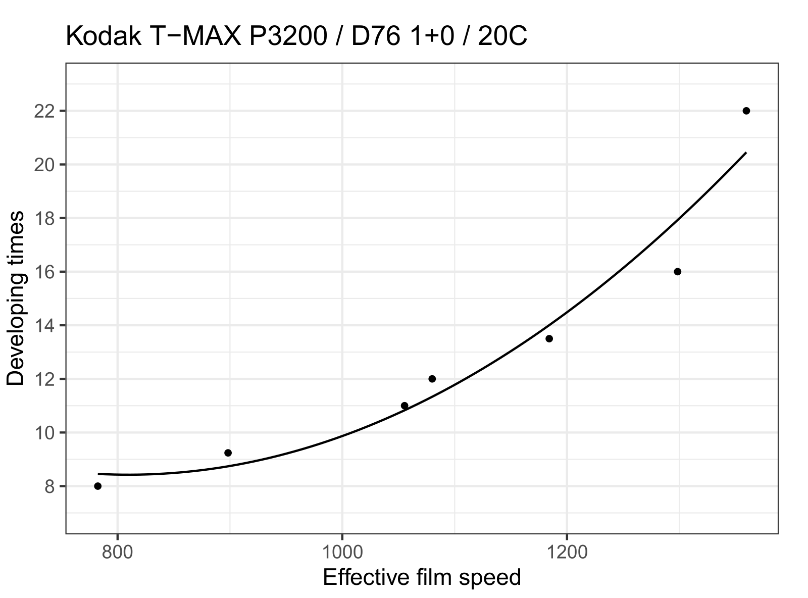

The more I work with the T-MAX P3200, the more I am impressed with it. I think this emulsion is engineered to give a real speed increase with increased development.
I am curious how it will respond to more aggressive underexposure (EI 3200) and processing with XTOL. That's what I am planning to look at next.
By the way, I made a small error in my earlier calculations by including the density of a glass holder that's part of my setup twice. The estimated speed of the KODAK T-MAX P3200 is around ISO 1080. Sorry about that.

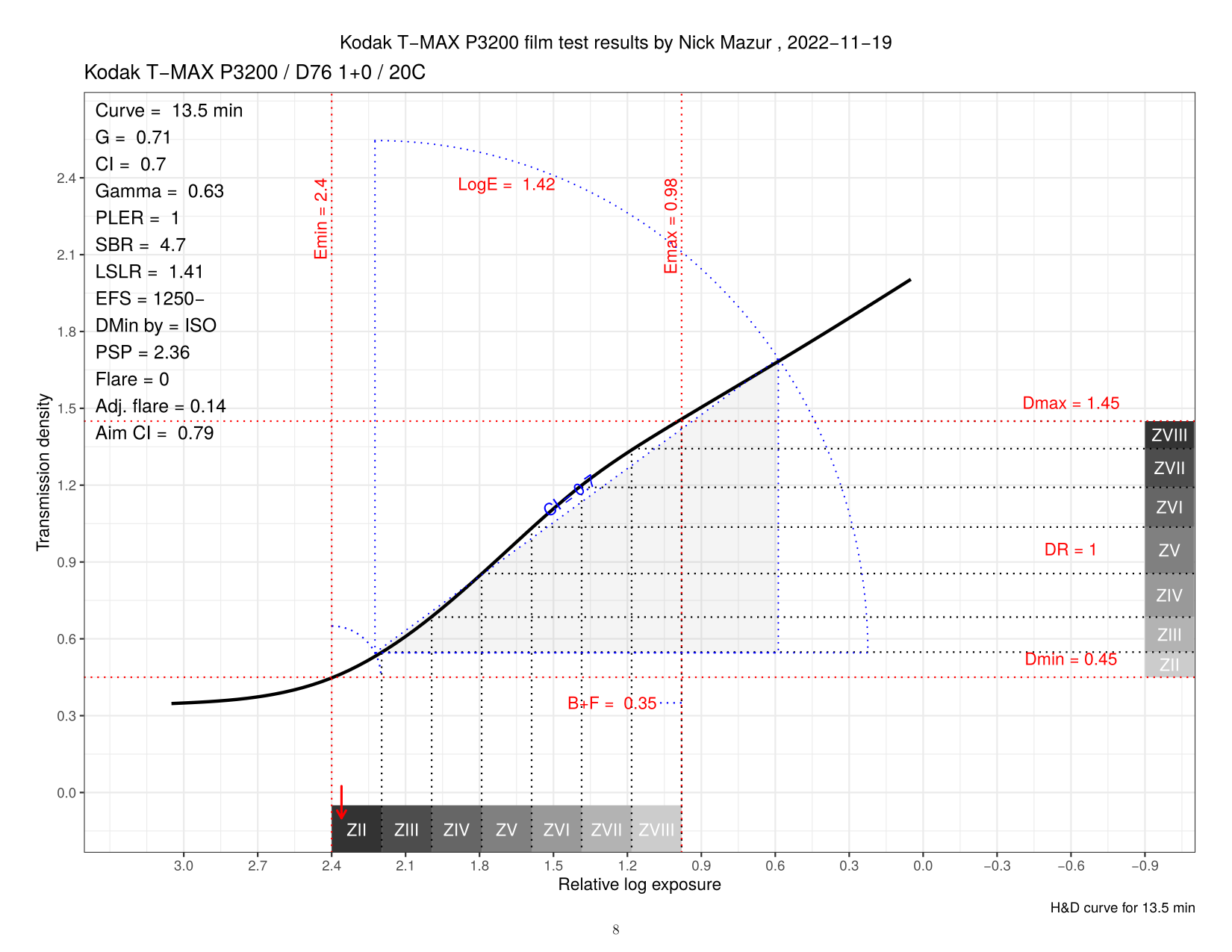

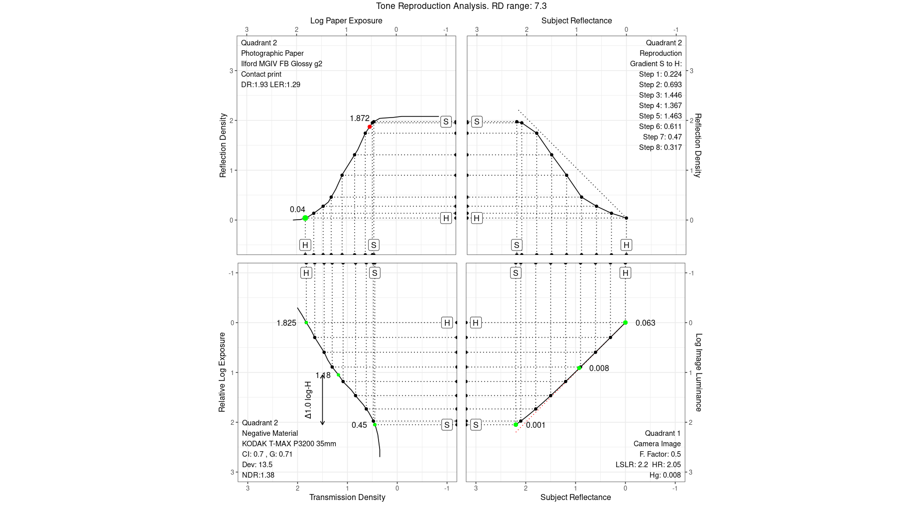

The 13.5 min. curve (approx. EFS 1250−) of the KODAK T-MAX P3200, according to the data, seems barely printable on Grade 2 paper (Ilford MGIV FB Glossy) with a condenser enlarger and appears to be more easily printable with diffusion enlarger (or by contact printing).

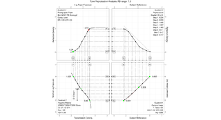

Here's a curve plot of the 13.5 min. curve showing a lot of data outside of the crucial seven-zone range. Significant dodging and burning would be required.
And here's a different look at the same data, showing tone reproduction analysis of the same curve, this time, simulated with a diffusion enlarger (or contact print) and flare-resistant camera and enlarger lenses. Here, the negative is somewhat more easily printable, with some inevitable tonal compression in the shadows and highlights.
I think a lot of film photographers would agree that the ultimate product in photography is a fine print. Lots of criteria exist regarding what is and what is not a printable negative. Curve family and tone reproduction analyses can, to some degree, predict how negatives would print. I say "to some degree" because skilled printers can work near-miracles from badly exposed and developed negatives, not to mention the general lack of agreement of what makes a fine print. So please, take the plots below with a grain of salt.

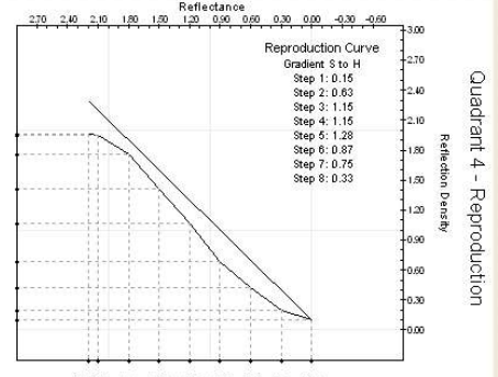

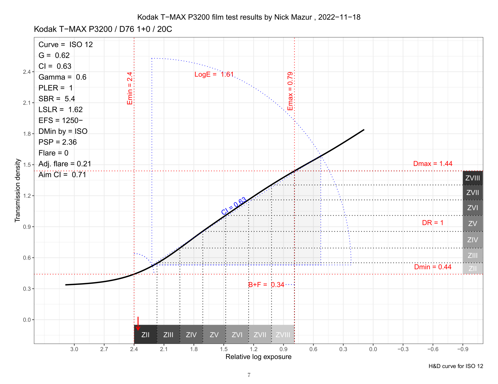

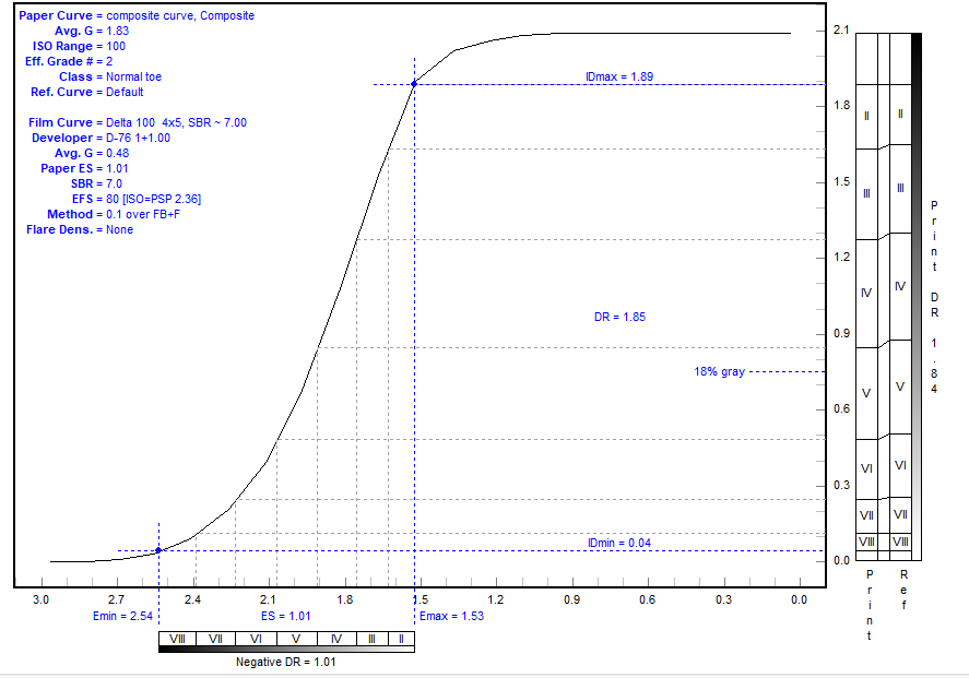

I wrote my own plotting program because I believe Phil Davis' version has too many compromises in order to bring it into agreement with BTZS. He over-simplified the camera image and tone reproduction curves. I was especially frustrated with how he calculated and depicted flare. Adding flare to the film's characteristic curve simplifies the process in that it can eliminate the need for a camera image curve. While the resulting density values can be accurately determined, I believe you lose the impression on how flare actually works. That's why I like the four quadrant reproduction curve.
In the above example, some of the numbers don't quite fit if the example is supposed to be for a normal or statistically average situation. I'm uncertain whether the flare value of 0.5 means 1/2 or is in log units. The NDR and CI is too high for a Subject Luminance Range of 2.20 to fit on a grade two diffusion. Also an LER of 1.29 is outside of what is considered grade two. It appears to be attempting to fit Zone System aims into a sensitometric model.
You might want to check out Exposure-Speed Relations and Tone Reproduction by Jack Holm. Be sure to treat his Zone System values with a little skepticism. He uses 128% for the highlight Reflectance instead of 100%.

Thank you for the comments and the references! They're much appreciated. I will respond briefly, as I do not want to wander off topic, but I would be interested in discussing this in a dedicated thread, if you are willing to participate, or via DM.
Much of the knowledge resides in old journals and among enthusiasts/experts, like yourself. I do agree about Phil Davis' BTZS but I also appreciate the practical application of theory that he included in his book.
Regarding flare, I have implemented a few different methods and models so far. For example, the Phil Davis method based on the notion of "flare density" is what perhaps most photographers who read BTZS are familiar with. What I think you're referring to is the flare calculation in Quadrant 1, which is based on a "flare factor," as in Hf = (Hs * 2^F)-Hs, which is added to the camera image exposure at the film plane. Here, the flare factor, F, is in stops.
I agree that the CI is too high for Grade 2, but I wanted to include the example simulating a situation where a skilled printer can make that work. The P3200 is a film that most people, it seems, are going to push, so they're likely dealing with CI of over 0.7 most of the time.
As far as the paper data, I did this test a long time ago, so it may not be the most accurate or relevant. I should have mentioned that. I haven't yet tested the new Ilford MG emulsion, but I hope to be able to do that at some point.
Finally, you are absolutely right about mixing Zone System and sensitometric models. I haven't yet settled on how I want to do this. I want to find a way to present sensitometric data in a way that makes sense to film photography practitioners, many of whom use the Zone System. I need some advice and feedback from photographers regarding this issue because, frankly, I am stuck. Here's how Phil Davis did this in Win Plotter, as a quick example. It's not my favorite because I don't think it's very effective in conveying the message.

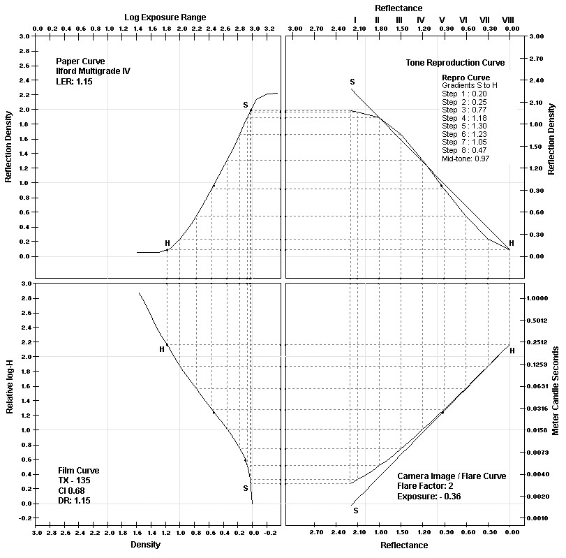

You're calculating flare correctly. What confused me was how you are noting it.
A flare factor of 1 stop would be noted as 2. Based on that, a 0.5 is really small. 0.5 could mean 1/2 stop. Or it could mean 0.5 logs or 1 2/3 stops. The degree of flare is not exactly clear from the notation, but from the value of HR, it shows flare reduced the illuminance range by 1/2 stop.
Flare for an average scene is considered to be around 1 stop. Since the number of lens elements has an affect on flare, the more elements, the higher the flare. Kodak went from 1 to 1 1/3 stops.. My belief is because of the greater use of 35 mm cameras over view cameras. Consider the equation on how to determine the aim average gradient for a given luminance range. Kodak considers 0.58 to be for a statistically average 2.20 scene. For an LER of 1.05 (grade 2 diffusion), simply dividing 2.20 into 1.05 would produce an average gradient of 0.48. While the scene may be 2.20, the illuminance range striking the film is more around 1.90 (one stop flare) or 1.80 (1 1/3 stops).
1.05 / (2.20 - 0.4) = 0.58
With your conditions as stated, the aim CI is 0.51 based on the flare factor. For a CI of 0.70 with a stop flare, the illuminance range needs to be 1.50, which is about what the TMZ negative would lose when rated at EI 3200 (considering a lot of caveats).
The basic idea of "pushing for speed" is to increase the gradient to compensate for the lower density range due to the loss of shadow detail from underexposure. If done correctly, the negative should have the same NDR and fit the same LER as a correctly exposed negative with normal development. I believe in your example, the camera image doesn't reflect the underexposure. If it did, the shadow would be placed lower on the curve. This would reduce the effective NDR. Here's an example of underexposure.
Tone Reproduction - Underexpose.jpg Compare the reproduction curve to an "ideal" Normal.
For paper, the LER doesn't mean black to white. From a Zone System standpoint, it's more from Zone 1 to 1.5 to Zone 8 to 9. There's still room on the paper.
A good tone reproduction curve is one where the middle gradient is above 1.08-1.10 and the curve falls below the guide curve (reproduction tones are lighter than the original). People can accept a certain amount of compression of the shadows and highlights in the reproduction, but the mid-tones almost always need to exceed the aim number.
What I did was to research what the values should be for a statistically average scene. I call this the standard model. I used these numbers to test the program while developing it. I believe these are included in the Defining K paper.
