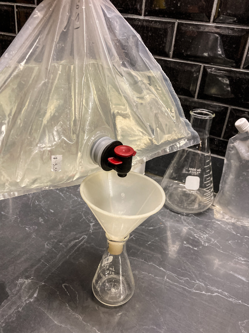

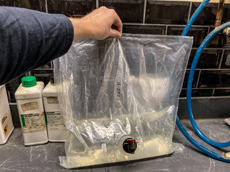

I'm much simpler. The wine bags I get are usually 7.5 L ( that's what the store carries) and I keep them sitting in the bottom of a bucket for storage. When I want to dispense the developer I take the bag out of the bucket. I use erlenmeyer flasks with a funnel in the top to measure my developer. I just hold the wine bag over the funnel and open the tap with my other hand.
Some photos of my wine bag and dispensing the developer.

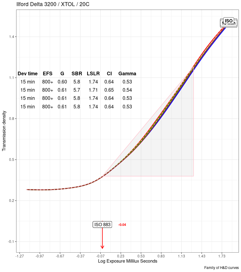

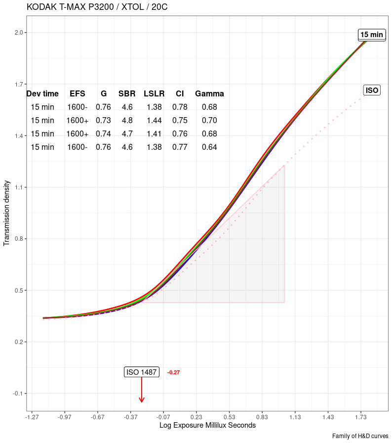

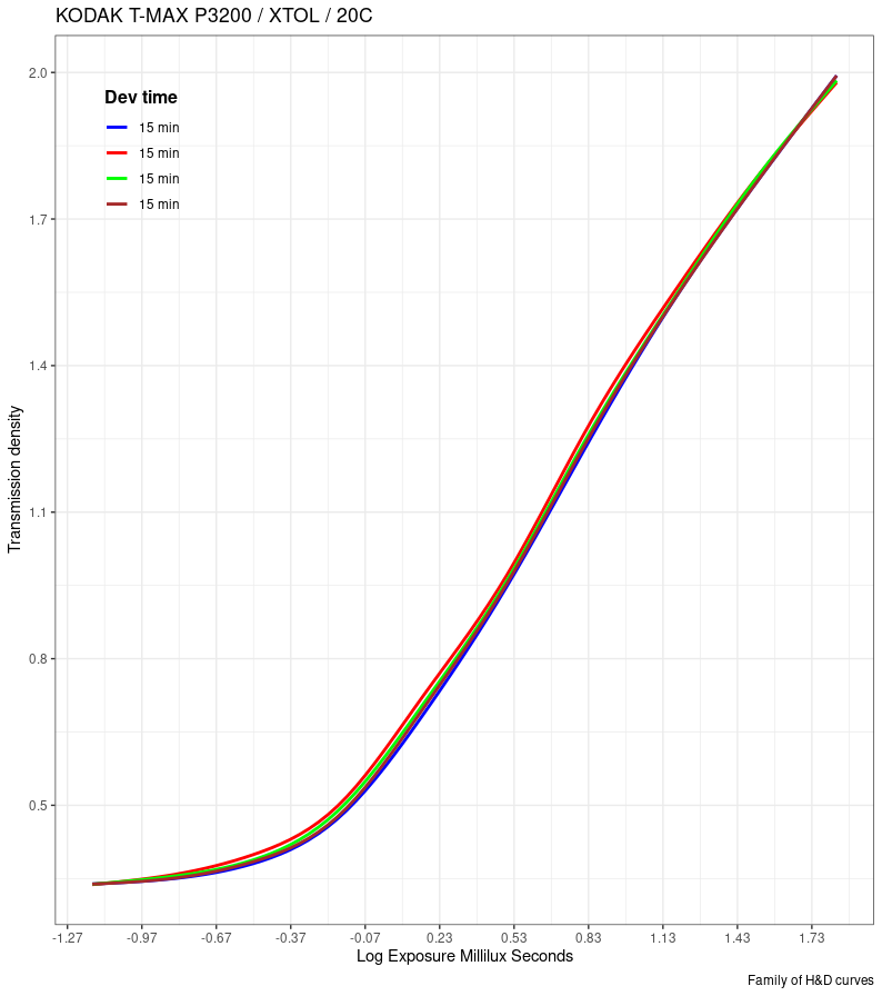

I have finished running a test of KODAK T-MAX P3200 and Ilford Delta 3200, exposed at around EI 3200 and developed in stock XTOL. I ran this entire test twice, so that's two series of four trials, each, because I wanted to be sure I was getting accurate results. I first developed for the Kodak recommended 13.5 minutes, but I was getting lower contrast than I did in my test of XTOL-R, so I increased the time to 15 minutes at 20C in Jobo (1510 tank). I was aiming at the CI of approx. 0.75 for T-MAX P3200, and 0.65 for Delta 3200, so that the two results (i.e., XTOL and XTOL-R) are easier to compare.
It turns out, stock XTOL gets a little more speed (approx. a 1/4 of a stop) out of both Delta 3200 and T-MAX P3200, compared to XTOL-R. Is it enough to be meaningful in everyday use? Probably not. However, T-MAX P3200 approaches ISO 1600 in stock XTOL, so it's very close to the advertised speed of ISO 3200. If pushed a little further, it might get maybe a 1/3 of a stop more speed. Maybe.
Stock XTOL produced an interesting side effect, compared to XTOL-R, namely slightly, but significantly higher B+F density, from around 0.31 to 0.34. I even mixed up a fresh batch of stop and fixer for the second series to be sure the increase wasn't caused by exhausted chemistry. Again, probably not something to worry about in everyday photography, but it is a real effect (samples came from two different rolls). Ilford Delta is less susceptible to this, with only a 0.01 increase, which is meaningless, as my densitometer is accurate only down to 0.01, anyway.
As far as tonality is concerned, the results are similar, with stock XTOL producing a tiny bit more linearity, but probably not enough to make a difference in normal photography.

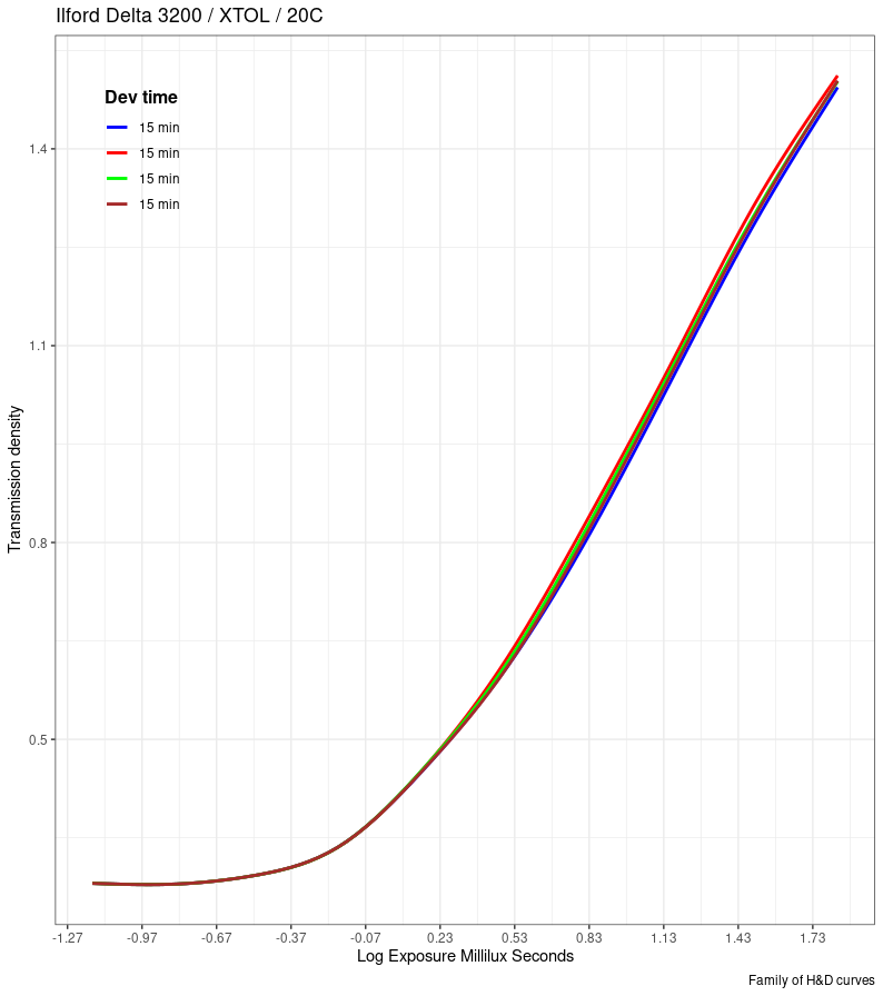

Here are the plots. First the curve families, then the detail. I have a lot more data available, so do not hesitate to ask.
And here are some details:

When you say it's better, do you mean in terms of speed, tonality, resolving power, grain, something else? If I had to choose a winner, I'd probably make this a tie. Each film has its own pros and cons.
Fresh will always produce better speeds than seasoned and most likely a slightly higher film base plus fog as it is more active. But that's a side note. What I believe is important to point out is the use of ISO in cases of "pushing for speed" can be misleading. ISO can rightfully only be used when adhering to the criteria of the standard. Kodak never claims P3200 has an ISO of 3200 so there isn't an advertised speed of ISO 3200. The "P" stands for processing. Kodak's data sheet says the nominal speed has been rounded to EI 800 or in other words, it would have an ISO 800 if they did the necessary testing. The three quadrant example I recently posted illustrates how "pushing for speed" works.
Determining the film speed increase with increased development also can be problematic depending on the speed method used. Shadow density will increase slightly with extended development, but this is not how film speed is measured. There is an inverse relationship between the overall film gradient and the relationship between the fixed density of 0.10 and the Delta-X speed point. Actual film speed doesn't change much with increased development, however; the increased shadow density does play a roll in the degree of processing necessary to compensate for the loss of NDR with underexposure. On average one stop underexposure only requires 2/3 stop extended development as compared to compensating for scenes with shorter luminance ranges. Hypothetically, if it was possible to increase the effective film speed to the higher EI camera setting, then there wouldn't be a loss in shadow exposure which will result in a higher NDR than is desired for a given LER. The ideal film / developer combination is one that has a low development rate so that the shadows are given time to gain density without producing high average gradients.
