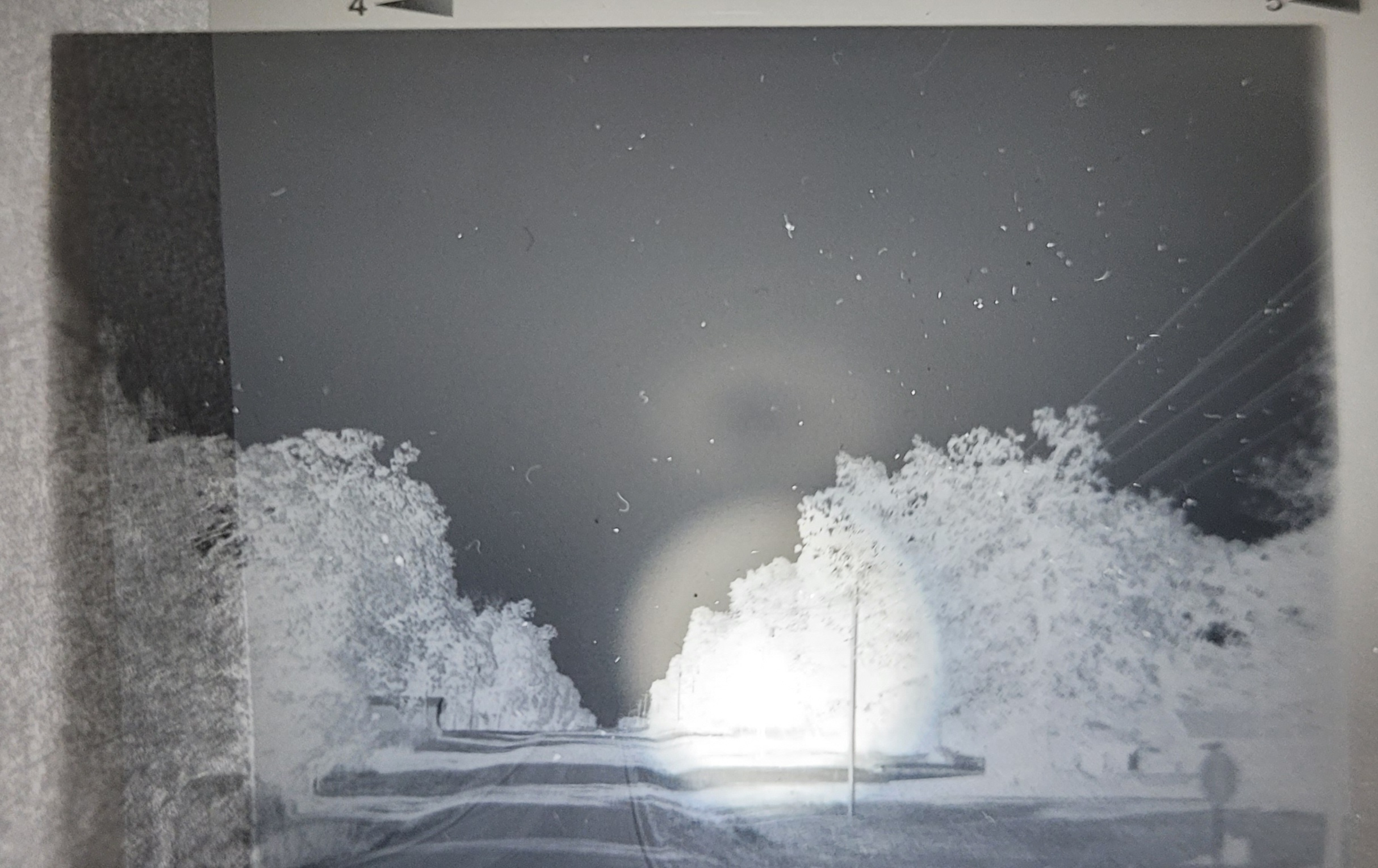

So.....a few weeks ago I returned from America armed with a roll of CatLabs 320X that I'd shot. I developed it and was happy with the photos but two frames exhibited what looked like faults in the emulsion, black spots on the scans.
I've finally had a bit of time to look at the negatives in question and this is what I see.
What's going on with the left side of the negative? It looks like a piece of cellophane tape or something is covering the left one-fourth of the frame.
You're correct, the left of the neg is still in it's storage sheet. I just got it out briefly to take a photo against my living room ceiling light. There's something up with the emulsion but if this film was manufactured by Agfa and confectioned by Harman I am actually thinking any issues might be down to my handling of it....though other than travelling on two planes with it I did nothing unusual and the other films I shot came out perfect.
It's odd though. Wondering if anyone else has had anything like this with CatLabs or indeed any other film? It looks worse than the Ilford problems of a few years ago. But it only seems to affect two frames.
I believe you are not the only person who has had the "flaking" issue. I came across it on two or three frames out of a couple dozen rolls I've processed so far. It would be interesting to see if CatLABS would send out a replacement roll based on this apparent defect.
Did you change lenses for these two frames? Dust might have gotten on the film, creating those black spots. If you did not change lenses, then those are probably flaws in the film.
Nope, it's a fixed lens Zeiss-Ikon folder. No known issues, and it flew in my cabin bag at my feet so I know it didn't get jostled about much.
