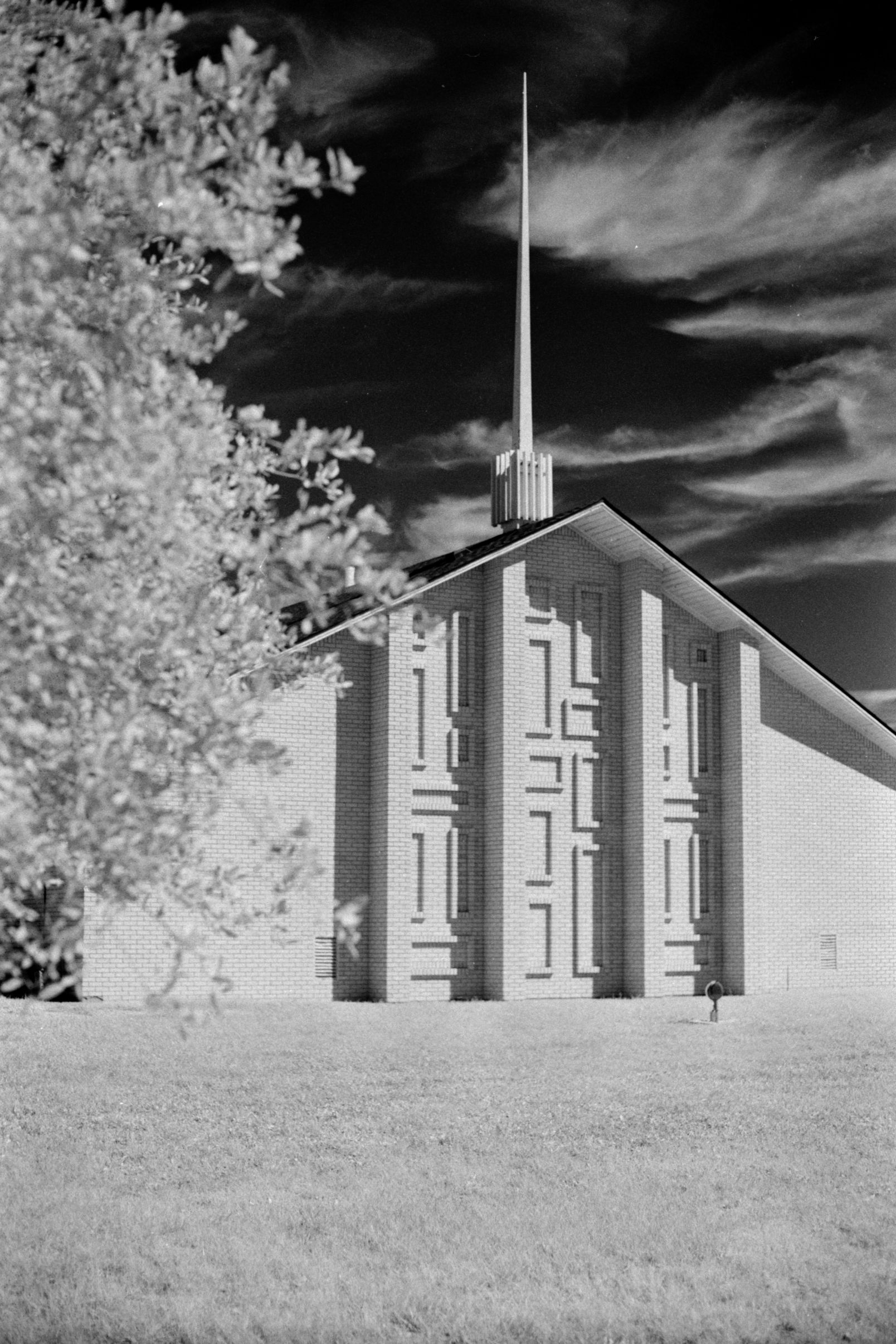

Thank you, Matt. Gotta love Photrio for the chance to learn something new every day. Does this picture show the Wood effect? I took it with a Hoya R72 filter at ISO 3.
Almost certainly - because the R72 filter transmits almost no light in the regular parts of the visual spectrum.
Although the Wood effect description references foliage, there are other surfaces that reflect IR - the building faƧade is evidently one of them.
The usual giveaway for the Wood effect, aparat, is the unreal white wispy look from the grass and foliage. On occasions a scene with enough grass and the right kind of foliage can resemble an almost snowy scene. Your scene isn't as extreme as this but I suspect as opposed to know that the extreme wispy snowy look seems to vary. It may depend on the season. Early to mid-summer seems to be the time that grass and foliage gives out the most IR

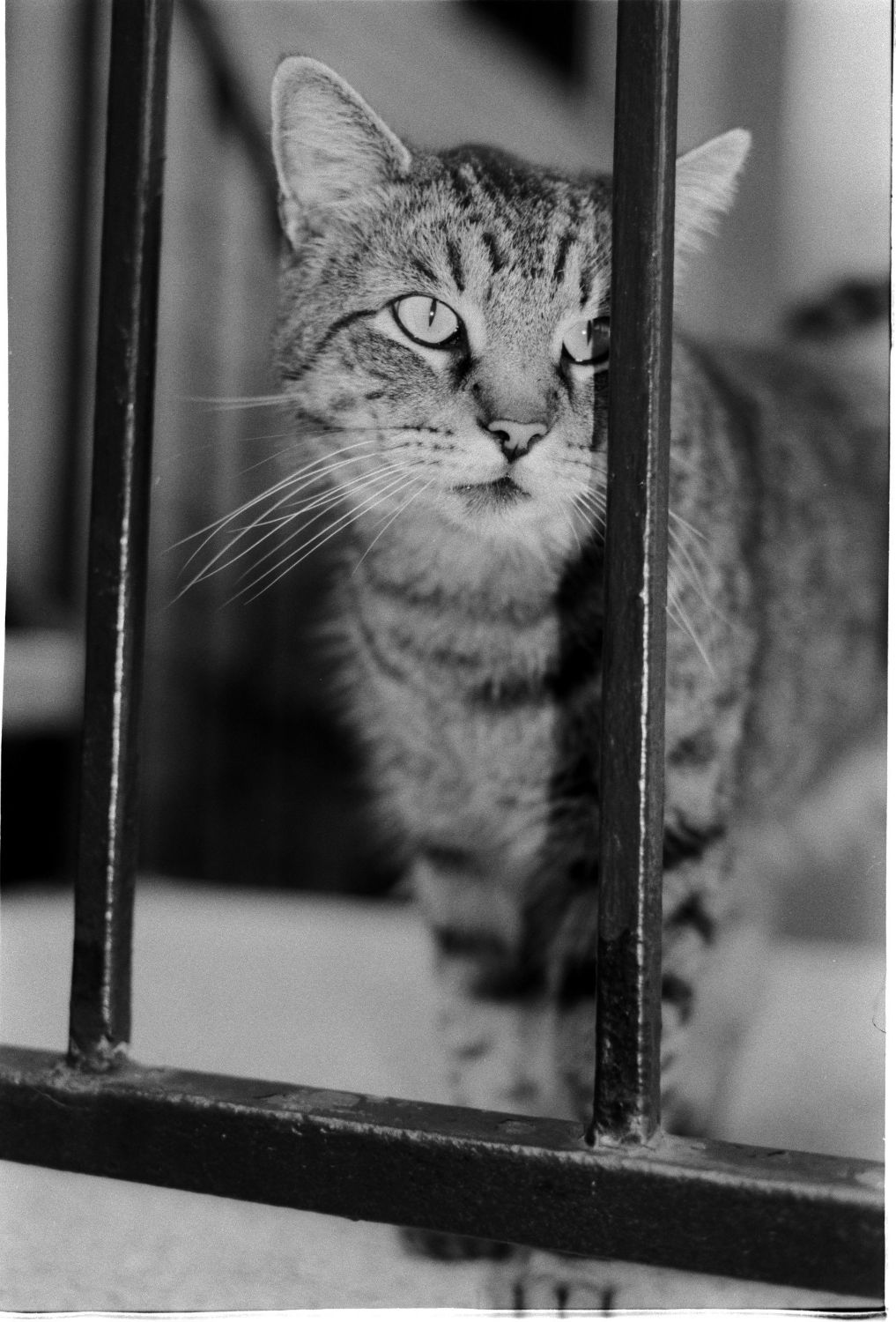

I have to share this one. It's Buster, our neighborhood cat. He lives around here. He stays with a family for a week, then moves on to the next, and on to the next after that.

Looks really good. This film gives great results, it's a shame that Catlabs had to market it as an 'edgy' street film that can be pushed etc. Instead of what it actually does best.
$6.99 is a very good value IMO.
Agree 100% . By the way, this cat photo comes from a negative I developed in XTOL for 7 minutes and it was overcooked, which is why it's a bit grainy looking. But it does have that unique look that this film is known for.
Stock xtol? Or replenished?
I assume shot at 200.
Stock time for 320 on their website was 11 minutes. I took a stab in the dark at 7:15 or so when I shot at 200. I figure 1 stop push is x1.5, so 11/1.5 7.33333.
I think I overcooked mine a bit, too. But not enough to make distracting grain.
I'm doing replenished now, so I'll have to nail it down for xtol-r going forward.

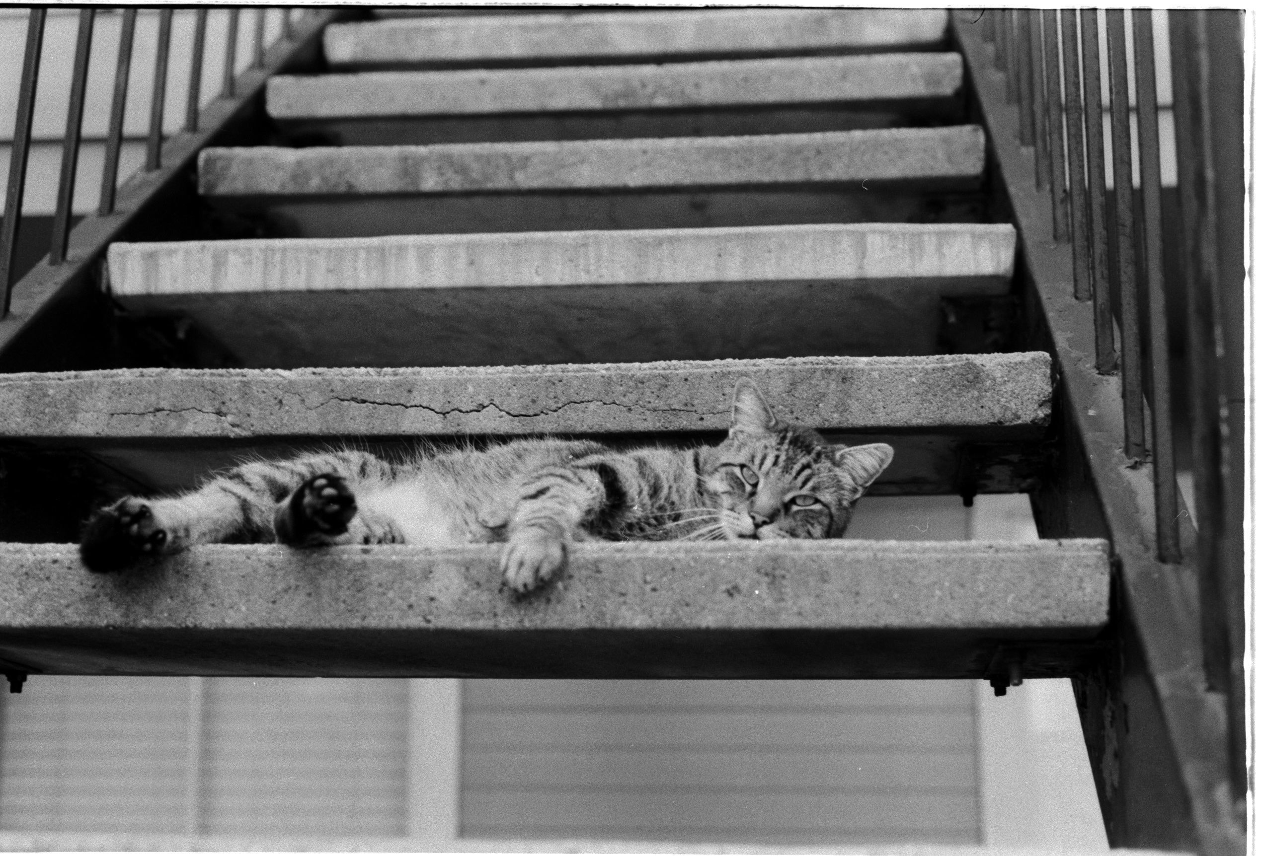

The picture of the cat is great, but my concern is the cracked concrete step just above him. I'm in the concrete business and I would have that replaced.
Yes. Good point! I saw them fix up a fence the other day. I'll let them know about the stairs.
@Moose22 This was exposed at ISO 64 and developed in XTOL that was half-way to being seasons. I underestimated this film's propensity for high contrast. I should have cut the time by at least 2 minutes.

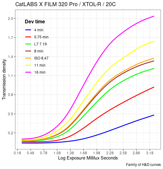

Speaking of XTOL-R, I might actually run the curve family test in XTOL to see if there's any change to the S-shape of the curves.
Thanks for the data point. I looked at my notes and what I shot at 200 was in developer for 7:20. I'm guessing 7 minutes full strength (these were rolls 2 and 3 in freshly mixed xtol) would be a good balance.
And thanks again for sharing and experimenting. When you do xtol R I'll definitely be interested. I started replenishing after that batch hit 6 rolls so that's what I'll be doing going forward for xtol.
I've heard that Ilford Pan F also has something of an S curve , and is an inherently contrasty film. Have you ever tested it and can you make any comments about it relative to the Catlabs film?

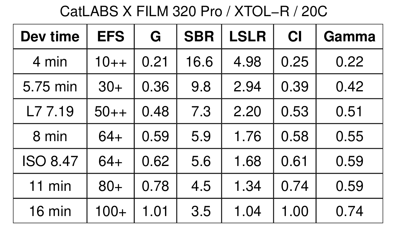

I have another set of curves of the CatLABS X FILM 320 Pro for you, this time in replenished XTOL. I ran the test twice and averaged the numbers for the final analysis. The results are very similar to those in D76 1+1, though I did give the film a bit of extra exposure to see how the curves would look. They look very similar, so the film is going to have a similar overall character. CatLABS recommends 11 min in XTOL, which should give the film that punchy look it's known for (CI of around 0.7). The curves marked "L7" and "ISO" are theoretical curves for the "normal" LSLR=2.2 and G=0.62, respectively. These curves are useful in figuring out the best exposure and development for your needs. For example, on a typical sunny day, in mid-late afternoon light, if you want good shadow detail, set your meter to around ISO 50, expose for shadows and develop for 7:20 minutes, etc.
I am not sure this brings anything new to the discussion but since I already have the data, I might as well share it.
