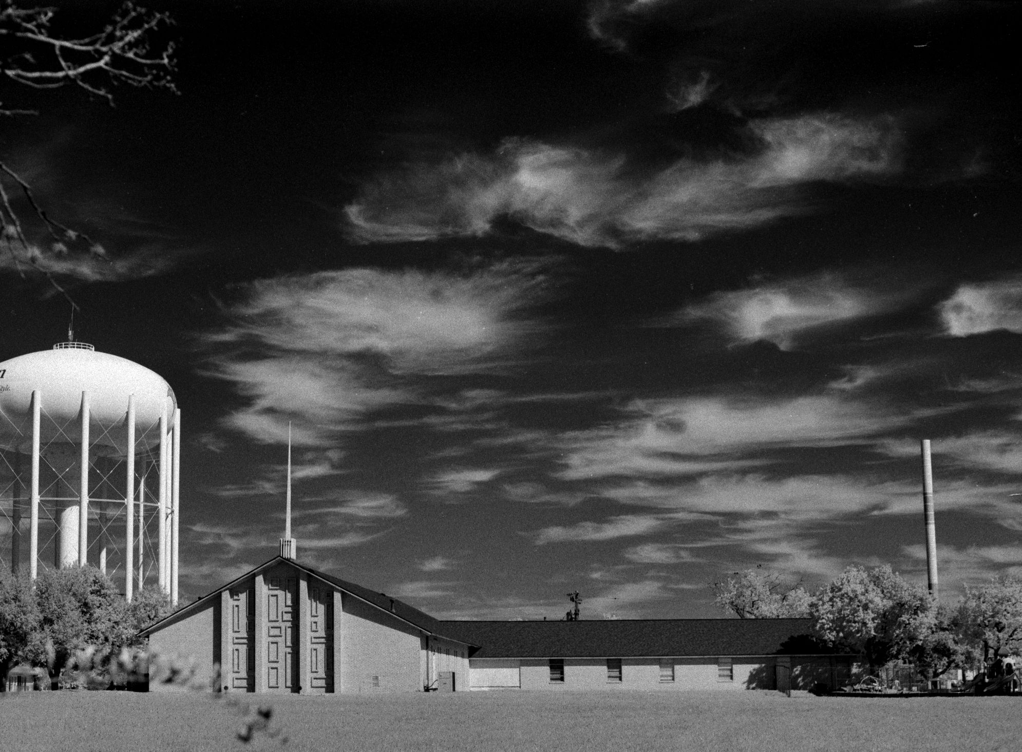

Yes, tmax developer by my lab w no input from me.
Also no filter. I love the way this film captures clouds against blue sky even if they are very wispy, with no need to use a yellow or red filter.
Agreed. Even more dramatic with an R72 filter.
That is amazing Huss for a sky in which no filter was used. It has as black a sky as I'd want and being able to already appears to have a hint being able to give that shining white gleam. I wonder of a red 25 might be enough to lighten foliage to give a pseudo "Wood" effect?

Yeah, @Huss has captured some beautiful skies. I think this film, much like other aerial films, has the unique ability to "cut through" haze and capture a clear blue sky beautifully. It's also very good in deep shade, where contrast is very low. It can create some separation in the lower part of the curve, given enough exposure.

Sorry my fault, Huss. I read your quote about no filter but it was in a post reproduced by aparat with his pic underneath using an R72. I conflated the two together wrongly. Your shot which I have found now was of a darkish sky with no filter but certainly not a black sky
So yes the film does seem to have the ability to render a blue sky the way I'd not expect to be able to do without probably an orange filter at my latitude in the U.K.

Ah ok! :smile: Yeah, aparat used an R72 filter, to emphasize the clouds. This film has excellent cloud/sky separation without using any filters, unless you are looking for a dramatic effect.
