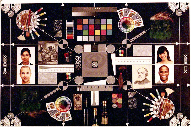

Below are a few scans from the first, second, and third rolls respectively.
The first roll was just slop shots. Test charts, shots out the window, a few of the cats who would not hold still for me. The one I'm posting is of the one test chart, room lights only, handheld, not scientific but a good sanity check that the colors are somewhat in the ballpark.

Congratulations! Looks like you did fine!
