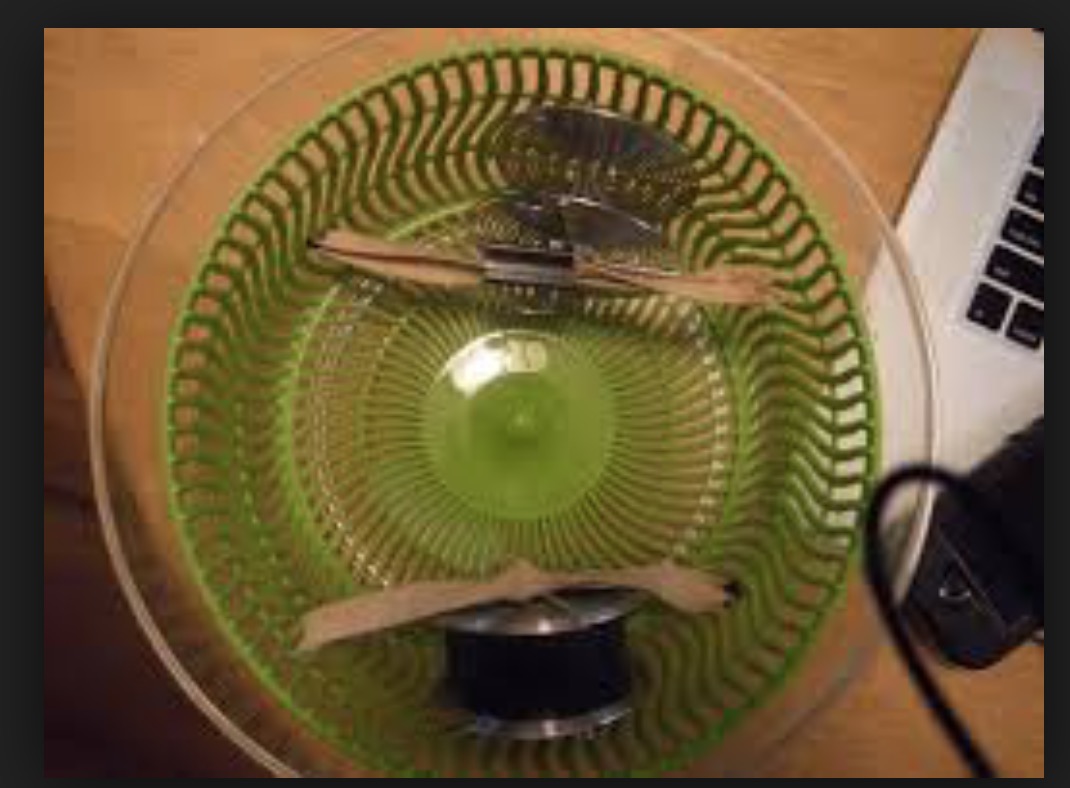

Yes, lol a salad spinner.

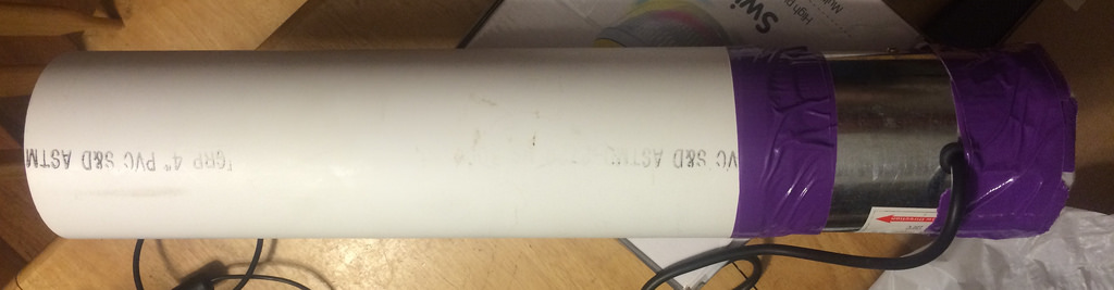

Not a drop of water remains and then you load the reel in your homemade film dryer ( 4" pvc with a duct fan and filter taped to the end) and you have dry, spot free, dust free film in 1 hour.

for the last wash and then giving it a few rounds in a salad spinner.
Hmmmm ... First time I heard that idea. I can see how it would centrifuge all of the droplets off.
