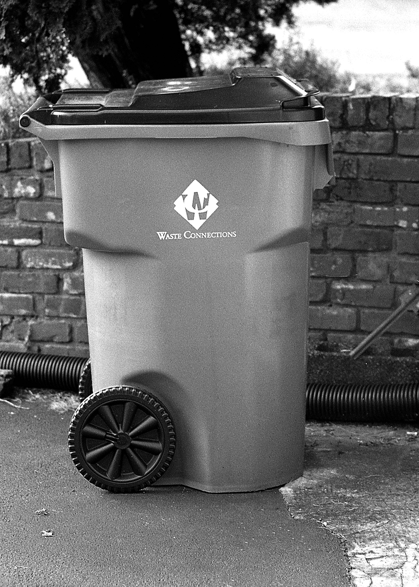

pentaxuser-I once used Rodinal with Tri-X and HP-5 long ago and didn't like the results. I've never been disappointed in Rodinal and FP-4. I've used D-76 back in the day but now I'm more inclined to go with HC-110 Dil H with those two 400 speed films and that's what my comparison was about. I've looked over my scans from Tri-X and HC-110 and the ones with FP-4 and Rodinal and there is a distinct difference in the tones. FP-4 will always give a better tonal range than Tri-X or HP-5. At least, that's been my experience as they just don't differentiate tones like a slower film.
I usually rate Tri-X and HP-5 at ASA 250 and FP-4 at 100. The first one is from FP-4. I couldn't locate the sample from Tri-X but the other one is from Delta 400 in ID-11. As you can see you can tell little difference in the blue body of the can and the black top with D400 over FP-4.

Well that's certainly quite a difference. Are these reversed scans of the negs to resemble prints or scans of the prints? Under a loop on say a light table the tones of the respective negatives (FP4 and D400) show up such a large difference in tone?
So the FP4 scan is with Rodinal but the D400 is with ID-11 not HC 110. There isn't any HP5 or Tri-X with either Rodinal for a comparison with FP4, nor a Tri-X or HP5 with HC110?
Yes-The negatives do look a bit different with a 10x loupe. I may have put the Tri-X/HP-5 negatives in a different folder for unknown reasons and haven't located them yet. They was a similar to the D400 negatives, however. I've only seen a tonal change distinction with the FP-4.
The point is, I've ran up on no 400 speed film that will differentiate tonal separation like the medium speed films. In this case, FP-4.

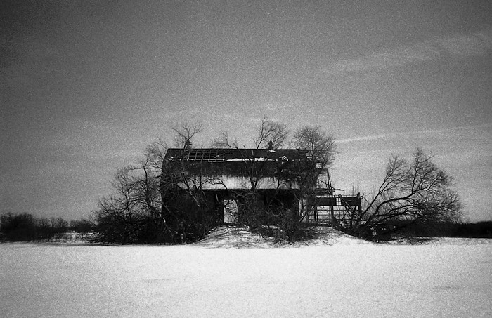

To me it is related to developer. I'm not interested on semi, stand with HC-110. With Rodinal I do.
I like HC-110 on B and regular time for normal results, Rodinal and stand is for the times I'm going slightly mad.
Fomapan 400 in Rodinal for two hours. It is negative scan, on the darkroom print it is as I need it. Crazy.
