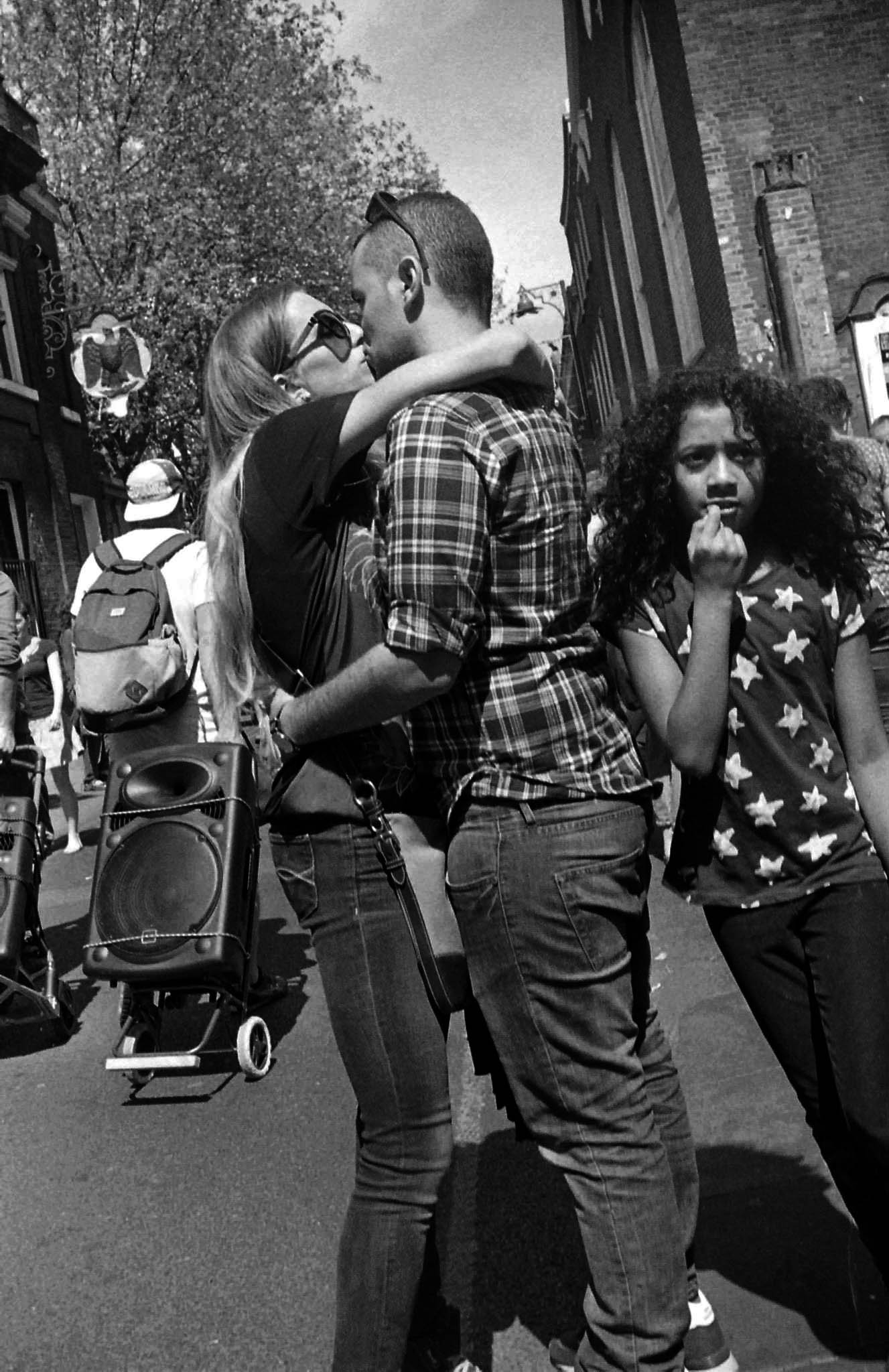

I've tried it. Results can be good. But in my experience too much chance of weird streaking/fogging....

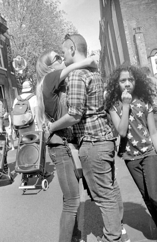

It's a good photo with decent tonality but I see the weirdness I often see when I've done stand development: sort of a fogging or haziness in some areas particularly over the kinky-haired girl's head on the right.
Fogging or haziness still there?
Ah, ah! Now, that is tricks that can't be mentioned here and I don't know none of them.
