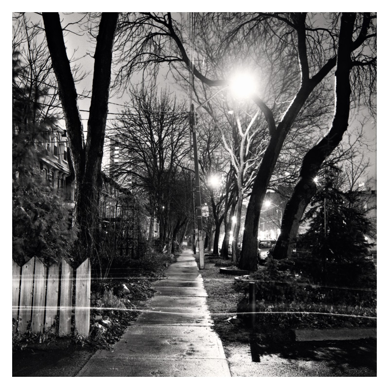

Personally, my track record with stand development is pretty poor. I've tried a lot of variations since 2008 when I started to find more posts about it on the forums. Every now and again I'll land a winner, but it's the exception to the rule.
One thing I found was that stand developed negs were poor to enlarge. I shoot primarily 6x6. This particular shot really glows as a print:
But it doesn't like to be enlarged bigger that 7"x7". It's fuji acros on a tripod. It's starts to take on a very ugly quality. I've seen this in other stand developed negs.
Something to consider perhaps.
