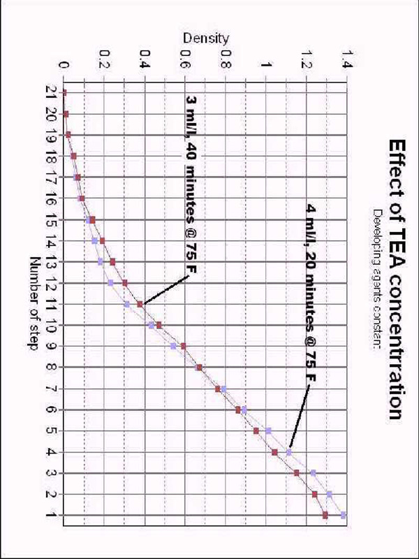

No, as I said above, I cannot prove my hypothesis. I can only use it as a working hypothesis until someone does a test that disproves it.
There's a little more to it than the titration. You are right about 8.3. I am using amidol as the Quasi-catalyst where I would ordinarilly use phenidone. I wanted to neutralize the stock solution's ascorbic acid without getting too much above the point where there is some activity. The less alkali there is in the working solution the more likely it is to be affected, one way or the other, by local development products. 3 ml of TEA per liter is not much. It's off the bottom end of the chart that Dow shows for 99% TEA, which is what I have, and that bottom value is about 8.
The concentration of amidol I use is 1/100 that of the ascorbic acid. I don't know exactly how to calculate the amount of TEA required to neutralize a gram of ascorbic or erythorbic acid. Perhaps our resident chemistry expert can say. I do know that with the concentrations of agents that I tested at first, the usual rough test of soaking a piece of exposed film in it for 2 minutes gave practically no change in density. 40 minutes at 75 degrees was about normal contrast. according to some estimates I made much earlier, the time to get that contrast with agitation of 3 inversions each 30 seconds would have taken about 35 minutes.
It seemed that the obvious next trial would be to add another ml of TEA, which is actually an increase of 33%, but still not much in absolute terms. The result was about the same overall contrast in 30 minutes (I may have said 20 before. That was wrong.), with the lowering of the shadows and the raising of highlights. I did not compare stand development with agitated development. I have some number, but I am going to repeat them before I publish them. The comparison of stand and agitated development, using the same formulation in both cases, will show some interesting results, but that's another hypothesis.
I thought I transmitted a jpeg of my chart, but I can't seem to find it anywhere.
I'm going to try to send that chart again. It is only supposed to have about 80 K, so should go alright.
I see I didn't wait long enough. I can only send a picture that is less the 700 X 900, and mine is 800 X 600. Go figure. I'll rotate it 90 degrees and send it in a little while.
Here we go. If it goes, you'll have to lie on your side to see it.
Thanks - that's interesting. So what happens if you further diminish the TEA - say at 2 mls. I was kind of wondering in the earlier post if you picked pH 8.3 for some reason, or can you go lower?
I don't really want to get between Ron and Patrick Gainer, but if you are pointing out the difference between hydroquinone and catechol in their respective oxidation reactions and pH change, I should point out that the pH rise is a result of sulfonation reaction of oxidized ketone form (quinone) of the developer. In tanning developers, sulfonation reaction is not the fate of majority of the oxidized molecules because they purposely keep the sulfite level low and allow the diketone forms to react with gelatin to crosslink in situ. Therefore, if you use catechol in place of hydroquinone in regular D-19 or DK-50 type developers, I would expect analogous results will be seen, but if you use drastically low sulfite to limit the rate of sulfonation reaction, the result may very well be different. You will have to find available gelatin sites for hardening and the nature of the crosslinking reaction if you want to know the ultimate byproducts.
It was a bit arbitrary. There are 2 grams of erythorbic acid in 20 ml of the stock. Although amidol is reputed to develop in acidic pH, there are only 0.02 grams of it in the 20 ml of stock. That much amidol in a liter of even neutral pH would not develop very quickly. As it is, with 3 g/l of TEA, standing for 40 minutes at 75 degree just gives about normal contrast. I'll give it a try, but I have a feeling my newborn greatgrandchild would have children before my heirs found density on that film.
The pH of a saturated solution of sodium ascorbate, according to Merck, is 7.6. I don't know what the pH might be of a solution of whatever compound results when TEA and ascorbic or erythorbic acid are mixed in water. If someone would tell me how many moles of TEA it takes to form this compound withone mole of ascorbic or erythorbic acid, I will start with that ratio.

Thanks. The Dow site says the the ethanolamones can form esters. One way or the other, 2 g/l works as shown in the updated chart. It is a little better at compensating than 3 g/l. The shadows are practically the same while the highlights are lower, but there is not the flattening seen with amny compensating developers, at least within the range of my step density wedge.

Yeah, right. So do I have to ask if I have true compensation?
The legends on my chart should be ml/l instead of g/l. Grams per liter would be about 1.13 times those numbers.
