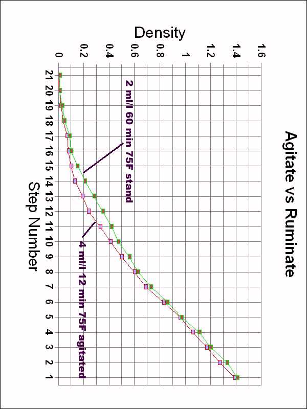

I got a little information on agitation vs rumination, whic is shown in the attachment. The same isoascorbate-amidol stock was used for both curves, with the difference in TEA content as noted. You may alo note that the 60 minute stand slope is lower than before. It is the same curve read again with the recalibrated densitometer.
The stand development made quite a difference. It will certainly show in pictorial negatives. There is nearly the same highlight contrast, but shadow contrast is much improved. For the same paper scale, about one stop of SBR can be accommodated without loss of effective film speed and in fact with a slight gain, especially when you take into account the points where contrast begins to rise.
I have not found mottling or streaking in my 35 mm negatives. Unfortunately, the smaller negative is favored here because the same extent of constant scene brightness occupies a smaller film area. The developer doesn't know this. The biggest I can go is 5X7, and I will try it when I get the urge.
I do not know how dependent on the developer I used my findings may be. To my knowledge, no one else has tried amidol-isoascorbate developers with 1:100 ratio. Since many of us are using propylene glycol as solvent for stock solutions, it is practical to make a long-lasting stock containing amidol.

I hope you know I meant "one more stop of SBR".
