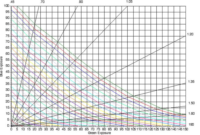

This graph shows what split grade exposures do in terms of standard print contrast nomenclature (ISO (R) values for contrast).
For example Blue exposure zero seconds and yellow 120 gives iso 1.9 or about grade 00. Likewise exposure Blue 15 sec and Green 60 sec gives the same middle gray value in the print but with an overall contrast iso of 1.2 or grade 1. etc.
Likewise Blue 50sec and Green 12 sec gives the same middle gray as the other two but with an overall iso 0.7 or grade 4.
BTW the different colored lines are don't deal with exposure color, they are just to follow the lines easier with your eye.

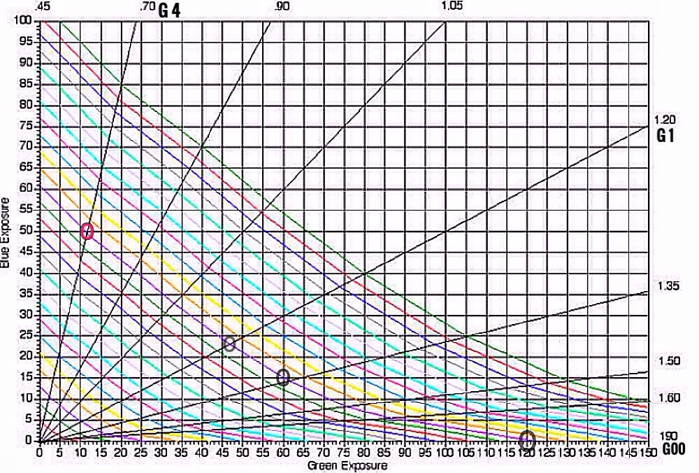

Thanks indeed racer.
The chart is much useful.
This is my sketching on the same chart, hope no mistakes.
If there is any, please let me know to delete it or change it.
For the red circle on the chart above,
If the same print was printed on grade4 directly using a colour head and same paper batch/development, No split grade filtration, what's exactly the difference between the 2 prints?

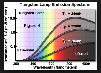

Also, this is a tip with a tungsten lamp Dichroic head: to burn with yellow (to burn a highlight) you can just as well burn with white instead. The amount of blue light in the "white" is less than the green (see graph). The reason this is good to know is some color heads allow all the filters to be removed from the path with a single lever or button. Rather than having to dial in 200cc of yellow and 0cc Magenta just to do a highlight burn. Try it some time.

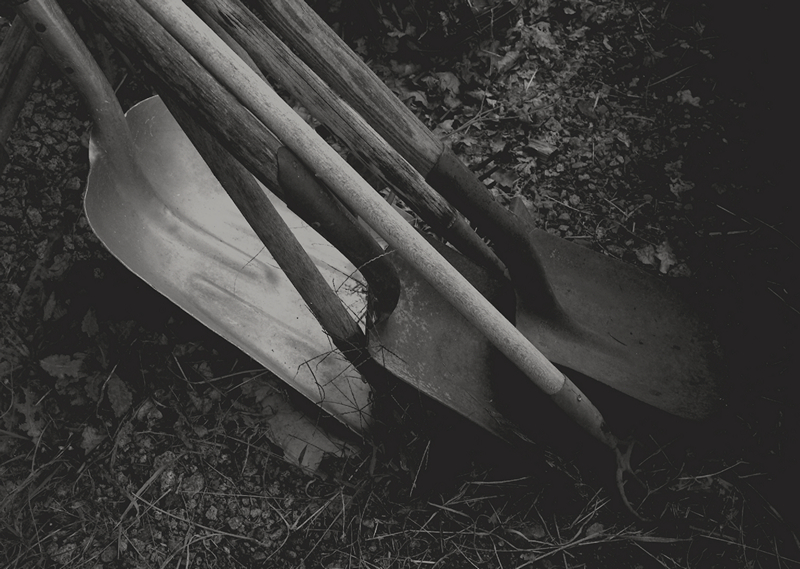

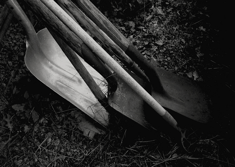

Two renditions of the same image:
One I would describe as low in contrast, while the other I would describe as normal to high contrast:

Yes...In your example, if i had printed that bottom photo, i would have thought it had low contrast, and would have increased the Magenta to get a "better" photo...going from 2 to 3 for example.
