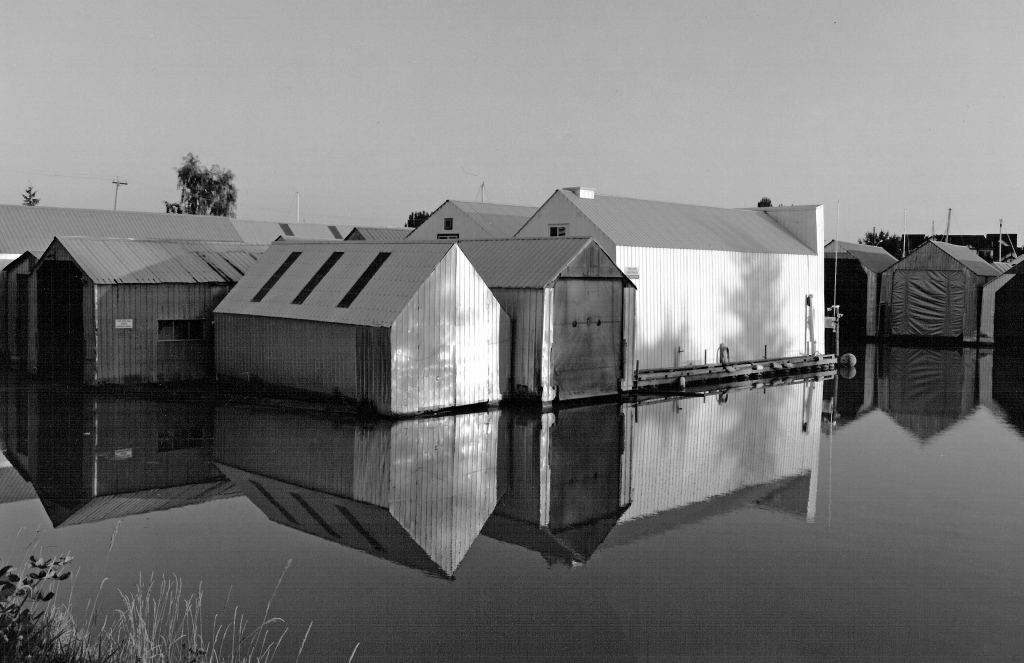

Here is an example of what was fairly close to a straight print - no split grade required. Note how the textures are subtle and the light was both diffused and directional:
And here is a print that needed all sorts of split grade choices and manipulations. Note how the textures are dramatic, and the light is both directional and contrasty:
