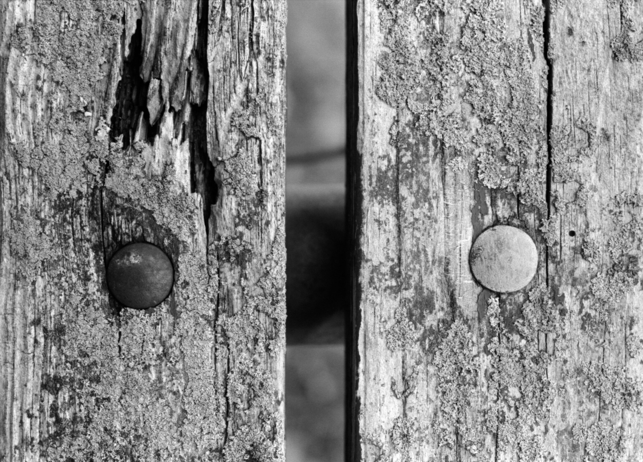

Completely different films in their character. I'm glad both exist and wouldn't ever consider one as a substitute for the other. Acros is better for general purposes but not for everything. I found Pan F+ to excel for graphical detail shots on subjects with a lot of texture. Ex:
Pan F has an exaggerated S-curve with limited contrast range; but under the right conditions that can provide some lovely results. And with the right developer it can exhibit a special "wire sharpness" edge effect which is somewhat unique. Very different indeed from Acros.
