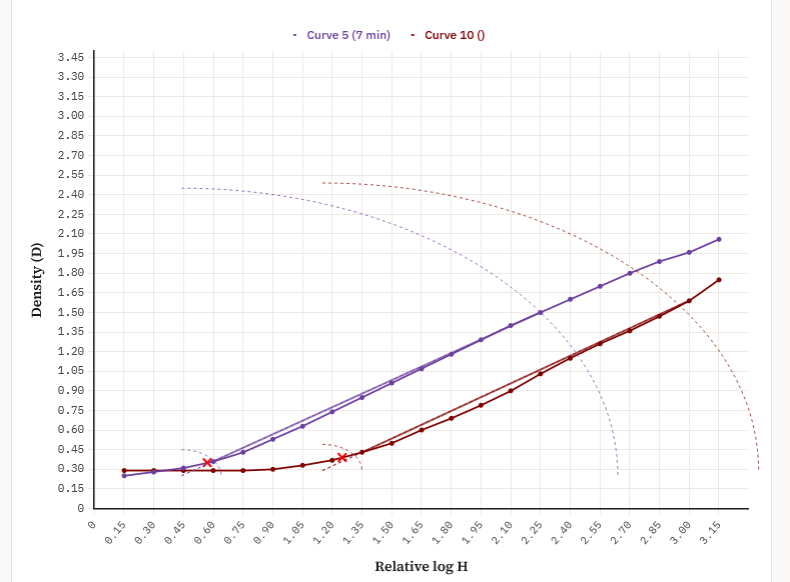

Contrast index is a measure of curve slope and in itself has no connection to the speed point. The ISO speed of the film is determined by how much exposure is needed in order to build a certain amount of density under specific geometrical conditions of the film curve, as well as acurately defined processing. The effective film speed is the point where this density is reached, without ISO conditions, in your own process. Two films developed to the same Ci will give similar resulting Density ranges, for the same scene.
You can develop a film with a speed of lets say 80 to a Ci of 0.58 and a film with a speed of 400 to a Ci of 0.58.
Ci is simply the steepness of a linear line that gets "overlaid" with two specific anchors onto the film curve.
This is the speed point, it is found there where the exposure results in curve densities crossing a certain threshold and tonal seperation starts to build. The speed is determined by reading the value on the X axis (the illuminance x time that hit the film surface).
Here is a comparison of films that have different speeds but the same Ci
Even tho, all films mentioned are advertised as ISO 100, this speed does only apply under ISO conditions, each film will most likely have a different speed point in your own process.
F.e. one might be 100, one might be 80, one might be 125. It's hard to tell without tests.

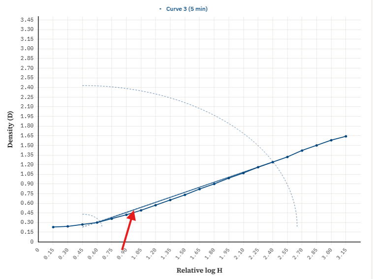

Seasoned Xtol. Dip & Dunk. EG&G Mark VI calibrated sensitometer.
DEL 100, CI 0.61 EFS 100
TMX, CI 0.61 EFS 80
No data for Acros.
ISO parameter is Δ0.80 density above 0.10 and Δ1.30 logH from 0.10. This equals an average gradient of 0.615. CI is a different method. With a short toed curve the two methods will likely agree. With longer toed curves, from a CI perspective, the CI is higher than 0.615 in order for the film to reach the Δ0.80 density.
