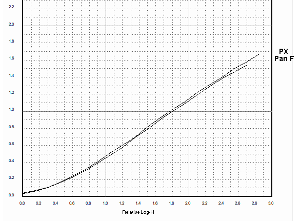

Curve shape is also dependent on development. For example, Pan F in Seasoned Xtol, Refrema Dip & Dunk.
Comparing Fan F and Plus-X, CI 0.60. Seasoned Xtol, Refrema. Pan F was shifted to match up the curves at 0.10.

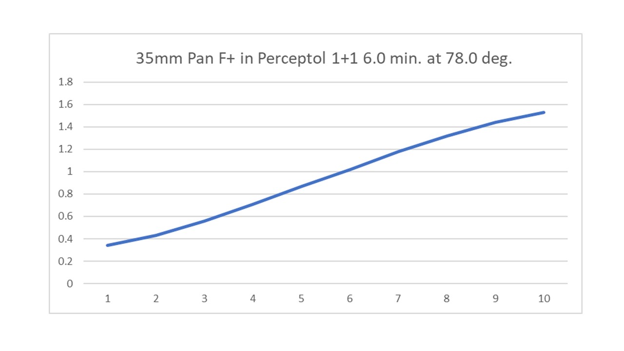

Reports of Pan F Plus' curve's S-shape and limited luminance range are, in my experience, exaggerated. The below trial (horizontal is Zone, vertical is gross density) was exposed at EI 25, resulted in fb-f of 0.25, EI 25, CI=.50 and Dmax on the fully exposed leader of 1.77. It's got a very shallow toe and shoulder. Extrapolating using the Dmax, it probably wouldn't have run out of steam (while retaining some separation) until near Zone 14, although I only exposed through Zone 10. It's got a very straight line from Zones 3 through 8. I am very pleased with this combination's sharpness and, given how warm our ambient and tap water get here during summer, usability at elevated development temperatures. My results using 120 Pan F Plus in a Mamiya 7 are the same as this trial in a Nikon F6 with confirmed accurate shutter speeds. Both times my Pentax digital spotmeter, recently calibrated by Richard Ritter, agreed perfectly with the in-camera exposure readings.
Pan F has an exaggerated S-curve with limited contrast range; but under the right conditions that can provide some lovely results. And with the right developer it can exhibit a special "wire sharpness" edge effect which is somewhat unique. Very different indeed from Acros.

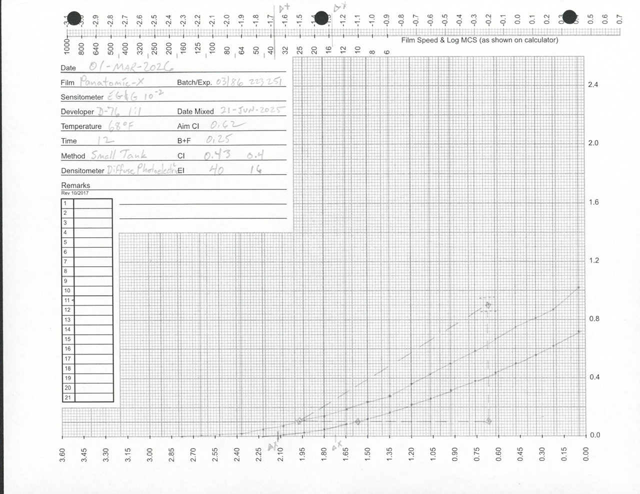

Well I was wrong. I’m seeing quite a spread in speed and contrast for old exposures vs fresh.
These shots are Panatomic-X developed promptly. I was happy how they came out. It felt like the film was fast.
Sunday I did the run that came out thin, despite longer development time. There, the exposures were aged, and the pictures are not as contrasty though the scenery was similar. It felt like the film was slow, underexposed.
I see similar spread in the contrast curves aged vs fresh in 5222.
So now in all the calculations for film speed I will be thinking about processing promptly… or giving additional 1/3 stop exposure

Same tank, same film, two different ages of latent image.
This is why I am advocating for “process promptly” — it’s happening too much for me to ignore.
I used to think nothing of leaving film from summer to process in winter. I used to trust Panatomic-X latent image based on print results. And true, the photo negatives here which have the aged curve, will print fine. But I dodged trouble by developing for a good long time. Anyone who processes by datasheet times risks thin, disappointing negatives if they shoot at rated speed.
