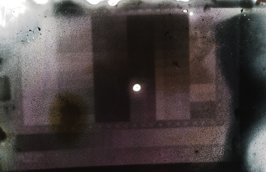

Examples
Thanks,PE-Here are two examples. When you judge the coating quality, please remember that I am working in total darkness with only a cheap night vision monicle to see with. I cannot realy see my coating until after the fix. The glass plates were exposed at f11 for 1 and 10 seconds.

Thanks Bil.
Who am I to complain. I hide all of my bad coatings in a big big box. :wink: Believe me, I know how hard it is.
