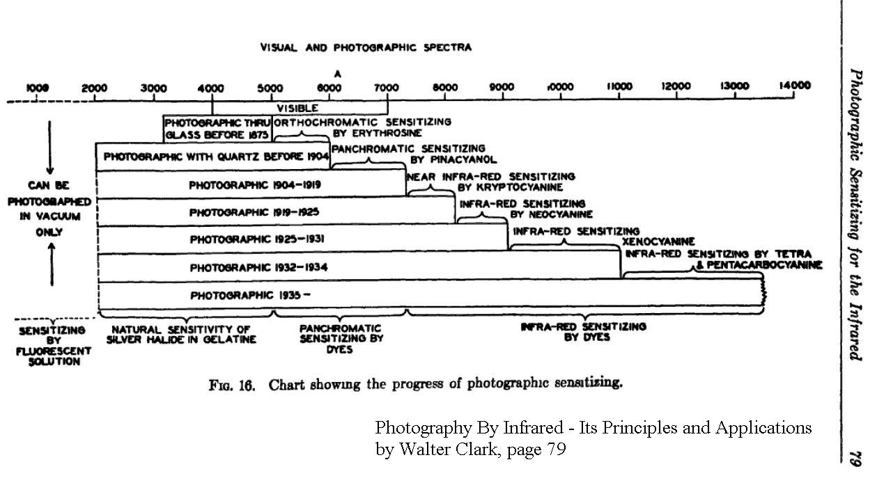

In summation, Pinacyanol, the most important sensitizer for the red, was used in all panchromatic materials until the thirties. Although by itself it gives fairly good sensitivity in the green in addition to its major contribution in the red, it was usually employed in conjunction with other dyes such as Orthochrome T, Pinaverdol, or pinachrome which conferred greater response in the green.”
  • Early Sensitizing Dyes.doc
