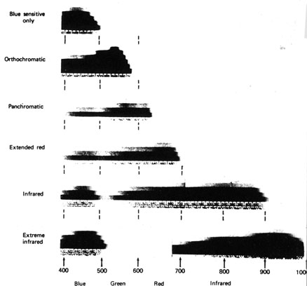

And the answer is:
Any sensitizing dye will sensitize an emulsion wherever it has a peak. This does not have to occur at 1/2 Lambda max.
PE

When I saw the UV/blue response at 1/2 lambda of the IR films, I thought there had to be either harmonic doubling, or instrument artifact.
I suspect maybe the blue/UV sensitivity is merely the native sensitivity of the emulsion, without dyes. The dye absorbs in the IR region and emits in the Blue/UV region, giving the IR sensitivity but retaining the original sensitivity.

The two blue peaks are quite pronounced and are at lambda/2. So this is actual response, and not an instrument artifact? Also, apparently a strong, broad absorber in the sensitizing target region has to do more than absorb, it has to exchange electrons with adjacent halides. Any absorber can produce something, like heat, but others are better at charge transfer to an adjacent molecule. Does that require a chemical bond?

Remember that sensitizing dyes are also desnsitizers in the blue region and you can use enough such that the blue speed is strongly repressed. They are also, in some cases, development inhibitors.
If a diffraction grating is used in the design of a recording spectrograph, then care does have to be taken to eliminate 2nd order diffractions so that they do not show up when trying to measure a 1st order diffration. The second order pattern will be at 1/2 the wavelength of the 1st order, and when trying to record wide ranges of wavelengths, it can be a big problem.
It's not an issue if a prism is used.
