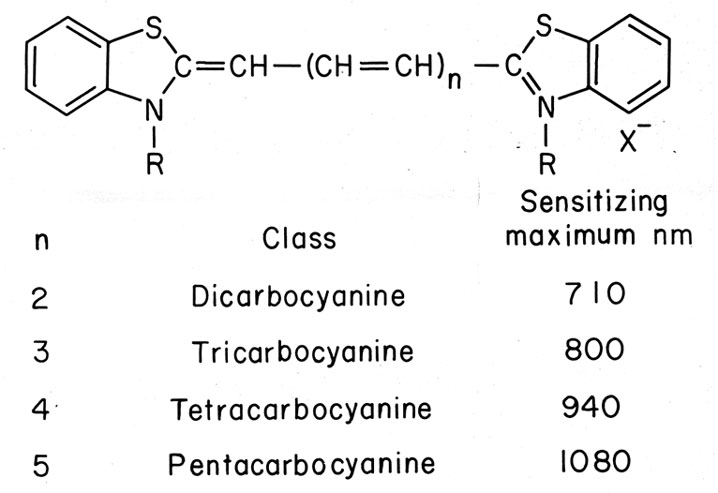

With few exception (Erythrosine and Chlorophyll being two I can name OTOMH), emulsion sensitizing dyes have positively charged Nitrogen atoms in them.
See attached. There is a resonance plus charge carried by one of the Nitrogens as the electrons resonate. Compare with Rhodamine.
PE

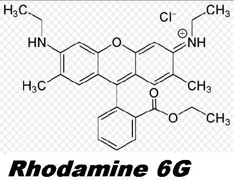

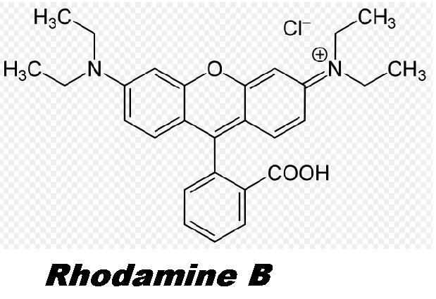

Ok Ron, here is rhodamine 6G and B's structure. And I included the one you posted, which is....? Are those just "cyanines"?
This is a completely foreign language to me, but I'd like to learn it. What do you call these kinds of diagrams?

Chris;
These are structural diagrams of organic chemicals. The first two have charged amines in side chains, and the "real" SS dyes have the charged nitrogen in a ring structure called a heterocycle. There is a huge difference between the two types of structure regarding the distribution of charge (electrons) and in the latter case it allows the dye to bind to the surface of the silver halide crystal and to transfer energy from light to the crystal.
The former two may or may not, but even if they do, it would probably be inefficient. Erythrosine is more similar to the former two in a way, and it is quite inefficient in energy transfer and so it is more difficult to use in some cases.
PE

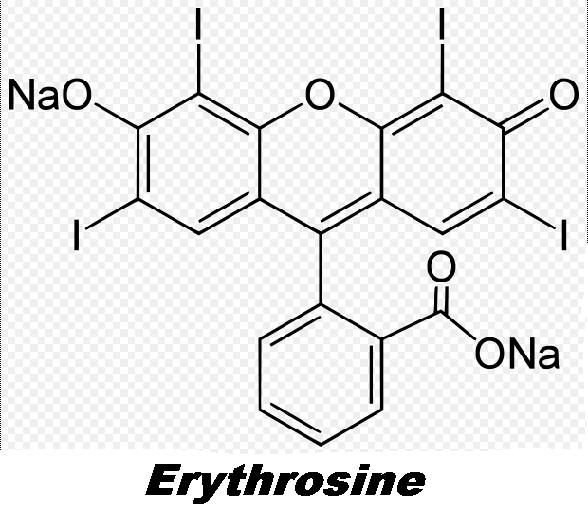

Here's Erythrosine just for reference.
Ok, so if these non-ideal S.S.D. (spectral sensitizing dyes) aren't as efficient, how exactly would that manifest itself? For starters, let's pretend we have an experimental silver emulsion that is completely unsensitized and it has a speed of 100.
The 100 would apply to blue. Presumably green would be much lower (by a factor of what?) and red lower yet.
So if we remake the exact emulsion but add dye X as a "final" (is that when you add SSDs?), how would that effect our distribution of speeds in the blue, green and red portions?
I'd like to roughly understand the practical differences between SSDs like erythrosine, congo red, etcetera (old-school sensitizers) and the ideal cyanine dyes.

There are many results possible Chris.
You may end up with no speed at all, matched green and blue speeds or reduced blue speed and some green speed. This includes all variations in between. The answer is "it depends"!
Sorry, too many imponderables. And even if it works, how will you measure it? There are ways, but it takes either equipment or special step wedges.
